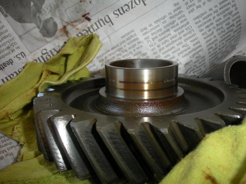

The pic below is part no. 36212-60031, the transfer case input gear. The seal between the transmission and the transfer that often goes bad rides on this gear. When this seal/surface goes bad, the t-case oil gets pumped into the transmission.
Does anyone know what size speedi-sleeve to use to repair this surface?

If it is a 4 speed gear, it is more likely that wear on the splines is pumping gear oil into the transmission and this has nothing to do with the seal. The splines are not sealed allowing gear oil to seep in, and when you go back and forth between drive and coast, the oil gets squeezed out in both directions. The 3 speed shaft doesn't wear like the fine splines on the 4 speed.

The seal surface in the pic isn't going back in my truck looking/feeling like that regardless whether the splines are worn.
But that said, how do you fix what you described short of replacing the gear and splines?

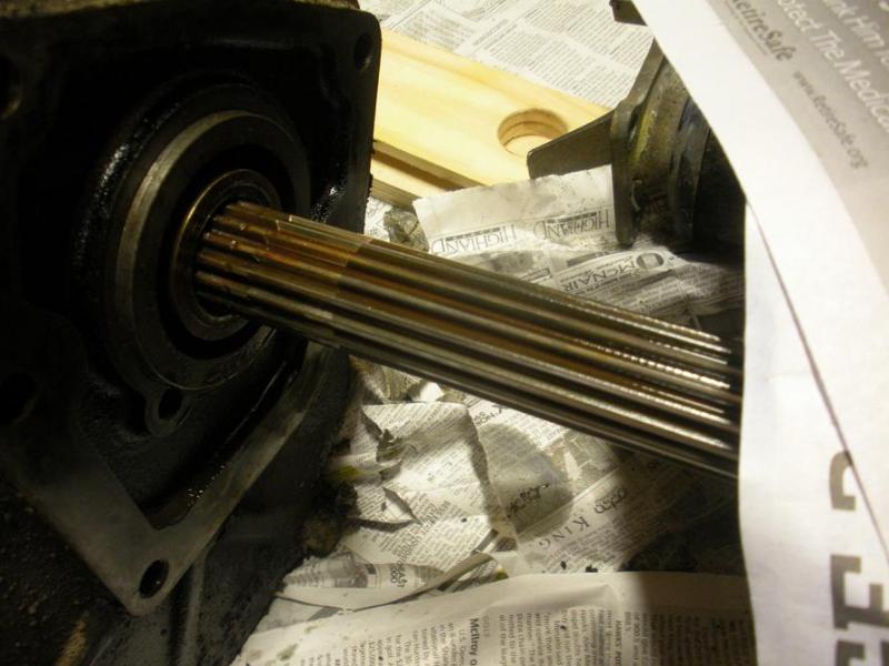

The only real fix is new tailshaft and input gear. Anyone looking for a used four speed really needs to take a good look at the tailshaft. Most have wear by now. Seems to be a problem with the split case transfer case four speeds with the nineteen spline tailshaft. But have never seen the three speeds with this problem.
The wear on the shaft looks as much as the wear on the gear where the seal rides. Remember the splines on your input gear are probably worn just as much making that amount double. You could just run a external line between the transmission and transfer case. You could also add a PTO gear. Splines behind the input gear might slow the oil transfer down a little bit.

The point of this project was to replace the external line work-around. lol. I suppose I should throw it all back together and run the junk.
Speedi-sleeve info, anyone?

Think Pinhead is correct. Any relative movement between the shaft and the gear acts like a pump. The high speed output gear bushing is probably worn as well adding to the rocking motion of the input gear on coast and drive.The seal surface looks pretty good from your picture. You can put the seal in, at a slightly different depth in the case and have the seal lip run on the undisturbed surface of the gear.

Thanks kiwi. The gear's splines really don't seem to be worn at all. The shaft on the other hand has a wear "lip" that I can feel with my fingernail. Seems like maybe the gear was made of a harder material than the shaft.
It's the first real wear I've found anywhere on this cruiser. It's a '75 with about 63K actual miles on the odometer.

Seeing you have a very low mileage machine. Spline wear may not be a really big part of the problem.
Couple of questions. When you pulled the seal did you examine the lip? Sometimes the seal can look OK, however when you bend it a little the lip will be cracked radially. That could be your leak.
You could polish the gear seal surface area with 220 grit wet/dry paper with a little varsol as lube.
The theory behind the pumping action, has to do with the recess inside the gear seal area. This part is inside the 4 speed case and exposed to the transmission oil. Oil gets inside the recess and the worn spline/shaft wear does the pumping action.
The oil level in the transmission is higher than the transfer case so gravity probably helps as well. Gears act to bring the oil up to the top shafts in both the transfer case and the transmission. I would think that at speed there is literally an oil storm going on in both the TC and the transmission.
When you go to reinstall the TC on the 4 speed it is not a bad idea to use a couple of long bolts with the heads cut off as guide dowels so you get the seal lined up with the input gear so it doesn't hang on the seal.
It would be nice if someone made a replacement input gear that had longer splines and smaller recess. There it quite a bit of output shaft spline area that is not contacting the spline area. Would be easy to make them longer. Always thought the Mr T could do an up-grade on the replacement part. The company that makes the the replacement gear for a 3 speed TC retro fit to a 4 speed Seamaster Taiyo Kiko Mfg Ltd could easily do it. Any suggestions.

Yep. just measure the shaft (snout on the gear in this case) and order the sleeve that way.
This looks to be a CR # 99169 by my measurements.

Thanks for all the info, help and advice. Sucks that Toyota made something with such a critical and expensive weak point. True, the car is 36 years old, but it doesn't have a lot of miles on it... So here's where it's at/going:
1. The new seal is in and hopefully will do better than the old one.
2. Sleeve ordered for gear. 99165 is what I ordered before seeing Mark's post (99169). My measurement was 1.654", so either should work. But if the seal is not the problem, seems like it's not going to be super critical -- if it doesn't fit I'll use it to make donut holes. lol
3. I'll be sourcing a new hose to use with my M-A-F fittings on the return apparatus when I put it back on. I'd reuse the old blue hose that came with the kit, but it's brittle and cracked where it slides onto the fittings.
