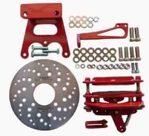

Looking for a kit similar to the one below. Anyone have anything locally (Canada). Needs to bolt onto a newer transfer case (84-ish).

It's possible, as far as I know I would need a different output shafts and bearing refiner and a shorter drive shafts ....and all the brake components.
I think the disk brake is less evasive and if anything allows me to change things down the road with less hassle.

Besides, there are mixed reviews on the Cadillac callipers holding as an e-brake so even with disks I would prefer to have a separate backup.
I've been bugged by a guy on MUD looking for 83/84 BJ42's if you're interested in a quick flip. :beer:
pretty sure the same can be said about those disk kits re: mixed reviews. I've never had issue with my old style drum parking brake, holds just fine. Not cheap to retrofit to a stock split case drum brake though. Ordering the 60 series version of what you linked might be easier, but still need to sort the cable/bracket/adjuster, so not entirely bolt on.
Guess that will depend on the final price as well, the kit from the US and relocating the factory e-brake lever cable to this new piece as opposed to all the parts required to convert to the older style brake (which requires partial disassembly of the T-C, something I wasn't planning on doing).
