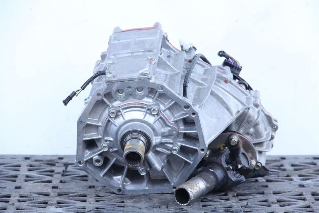

Looking at my 2018 t-case I do not see a typical breather, is there one? I do have what is pictured.
I asked my shop, YotaMasters, that has done many 4R's and a few GX's now, that when I picked up my rig after suspension and all if I needed a diff breather extension and Eric, the owner, said he has never needed one and he does some extreme wheeling. Albeit, I do live down here in So. Cal.
There is this closed circuit hose in these pics but also that vent hose on last pic top left.

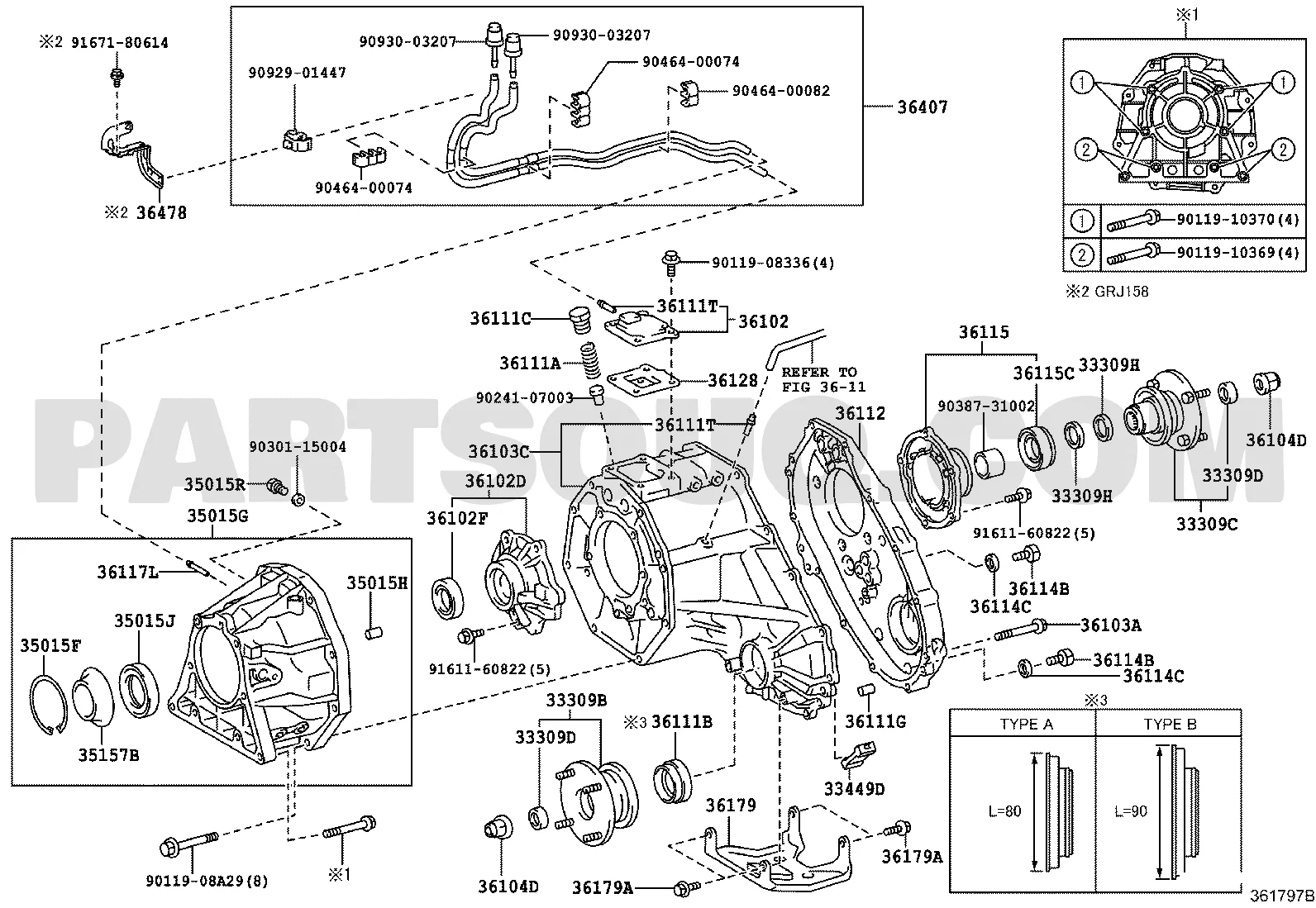

I am going to eventually do that as well on my rear up to gas tank fill area. Can terminate with this OEM part as well
PN: 90930-03136
For those that come across this thread in the future Jacket posted this pic on CL showing the stock front diff breather location.
