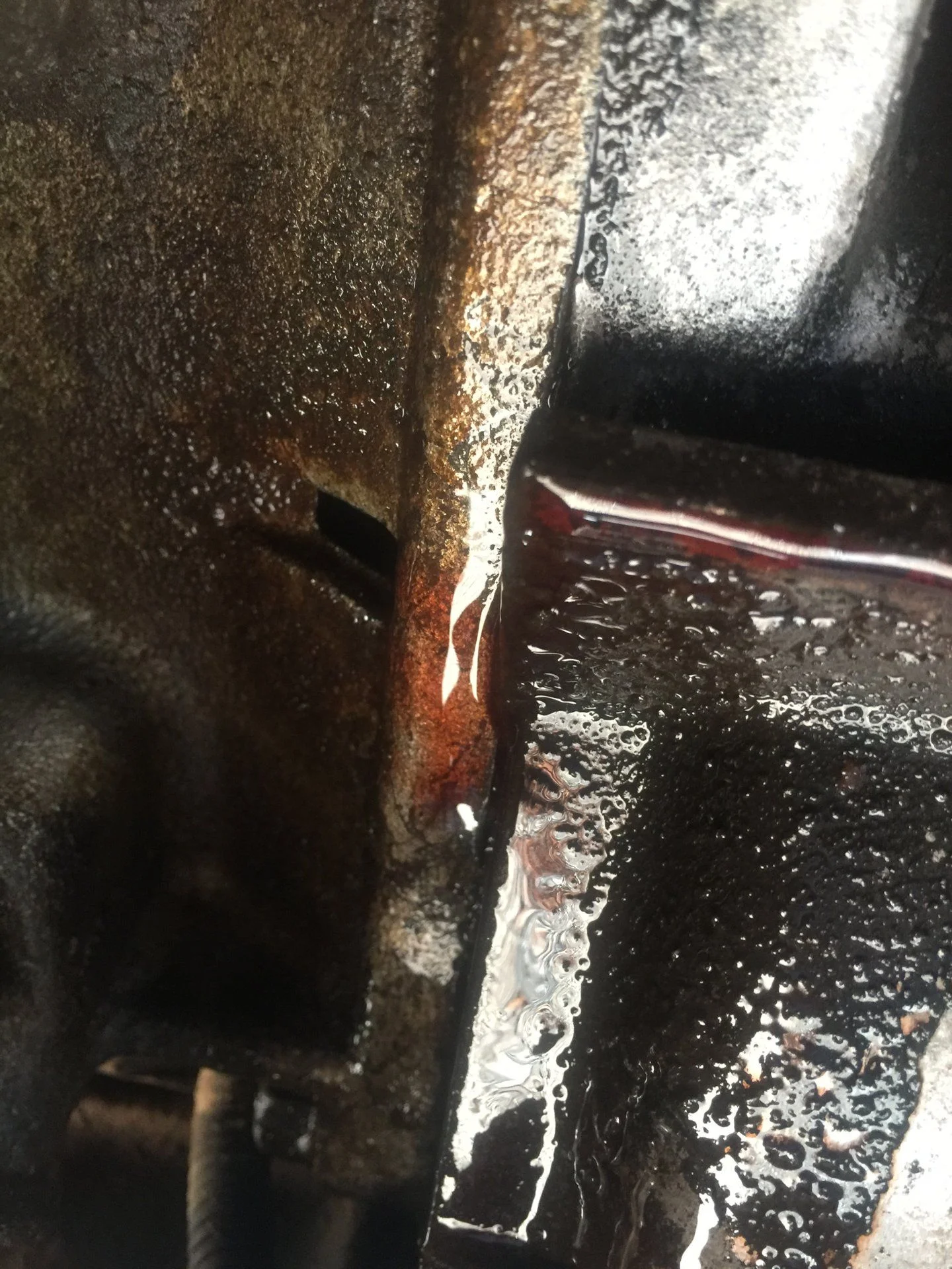

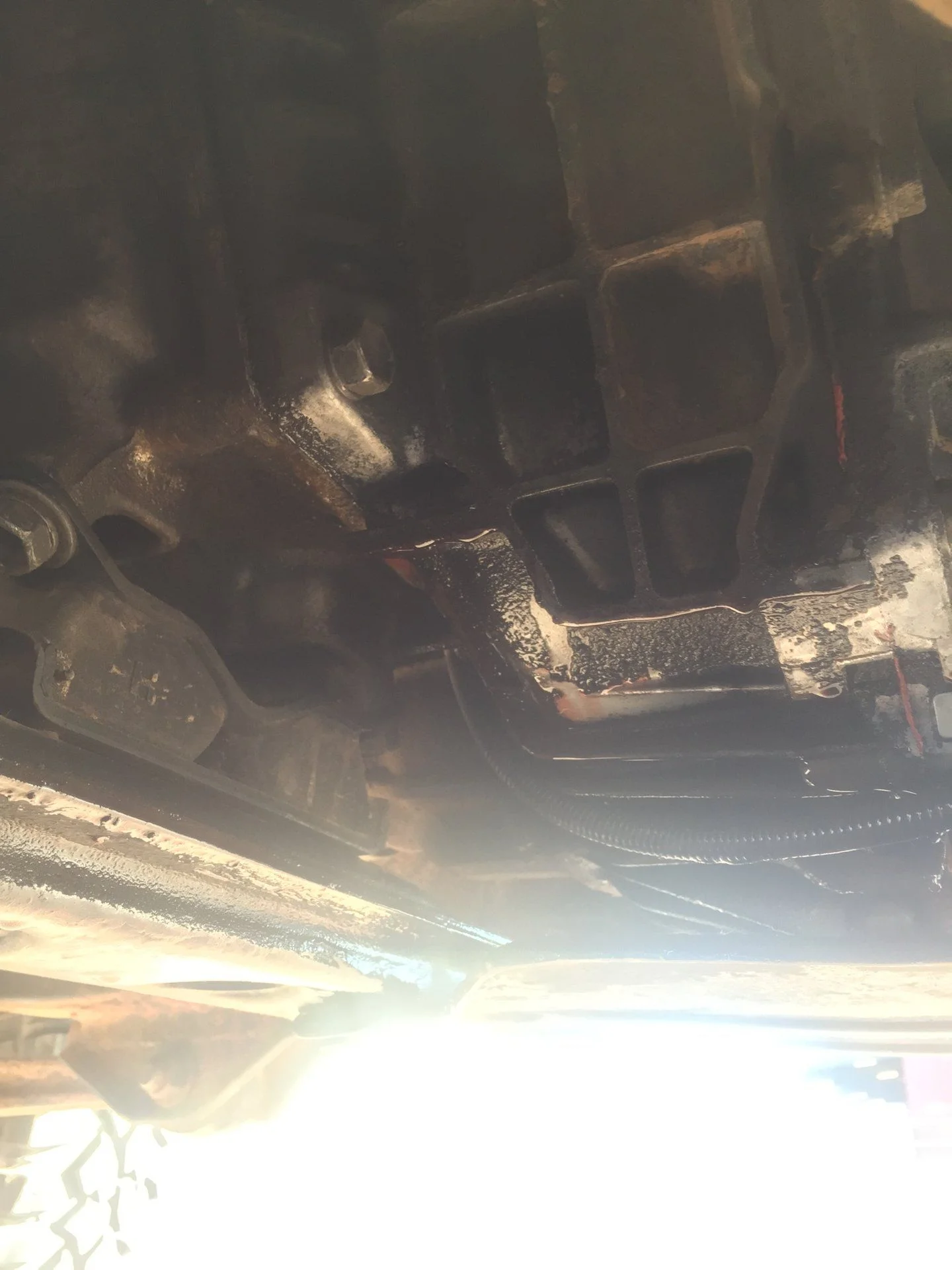

I have a 92 FJ80 3FE, and I sprung a leak while driving the other day. It was between the Trans/T-Case. I also noticed a small opening that looks odd. Has anyone experienced any leaks like this?
Replace two seals. One for the transmission output and one for the transfer case input. Both are the same part number. Remove transfer case (about 80 lbs), pull both seals out and replace.
