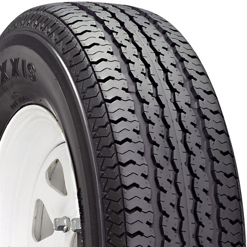

here is a pic of my trailer and the tire that exploded on the way home Sunday afternoon. Trailer has 5200lb axles, with the above mentioned tires. When this happened I was going around 65mph and during the entire trip I did not go much faster than that...which is not the normal pace I run...but

Let's see if I can show you a picture of one of the tread separations on an E rated tire less than three years old!
