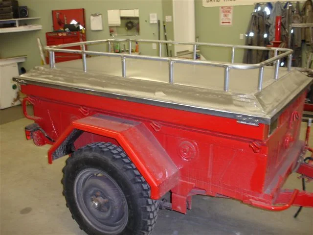

I used 18 ga i think? with 5ea. 1/2 16 ga. square tub arches and welded the skin to the sheet at all edges and spotted it every 10" on the underside. It's quite strong. I can stand on the underside of the arch and it holds my weight. 245#, yikes. I am not planning to load anything on the top so I guess the thinner sheet is going to work fine.

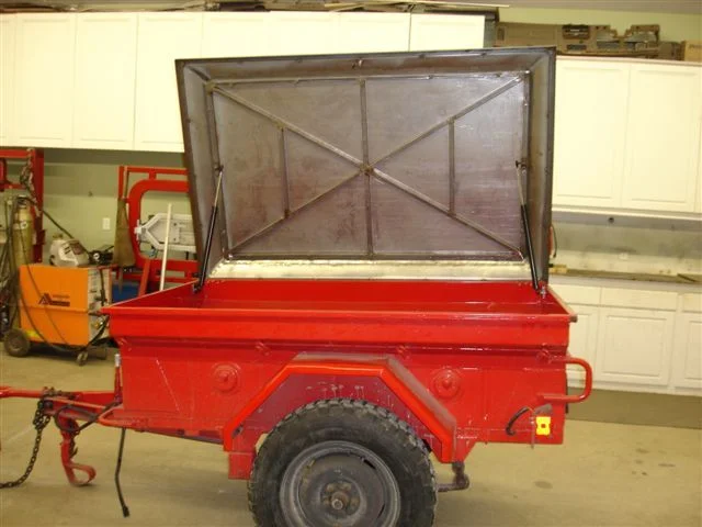

Ok fellas. I went to my local metal liquadation center today and ordered up some 18 gage sheet metal. In the mean time I tack welded up the framing for the lid. What do you guys think? Do I need to beef it up at all?

looks great. i would imagine with sheetmetal welded to it, it would be plenty strong, but have you thought about a brace in the center of the long sides? just looks a little weaker right there than the rest.
and the hinge is badass. if i could have found one like that local, it would be on my trailer right now.
Looks really stout. I would add a couple cross pieces to support the center of the top and a couple on the sides as mentioned above. Do you have access to a sheet metal break? You might want to have the angles of the sheet bent to spec. I bent mine by hand with a couple of blocks and an mallet and they look a bit rough.
I would also put the hinge on the underside of the square tube so you wont have to overlap the sheet
x2 on the hinge I ended up building my own. Looks like it will be a great topper!

Awesome sugestion regarding the hing under the frame....good call. I will be adding some support on the long lengths incase I want to install a roof rack.

FWIW, I would brace up the top but not with long runners like you have. I would either add a few braces across the width of the top, or preferably... I would add corner braces that connect the sides to the front and rear. Sorta diamond shape instead of parallel lines, clear as mud?

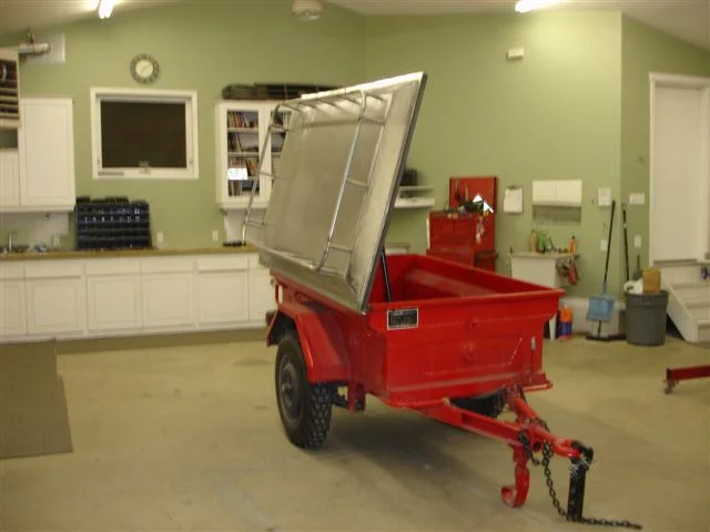

Ok I went to pick up 16 ga sheet metal today for the skin. I opted to have it bent by there shop. Took about 20 min and only cost 38 bucks. This was well worth it. It would have cost me as much to make my own break and the bends would not look nearly as good. This afternoon I laid in the frame and tacked it in.

Did you take the framework to the sheetmetal shop or just provide them with dimensions?
