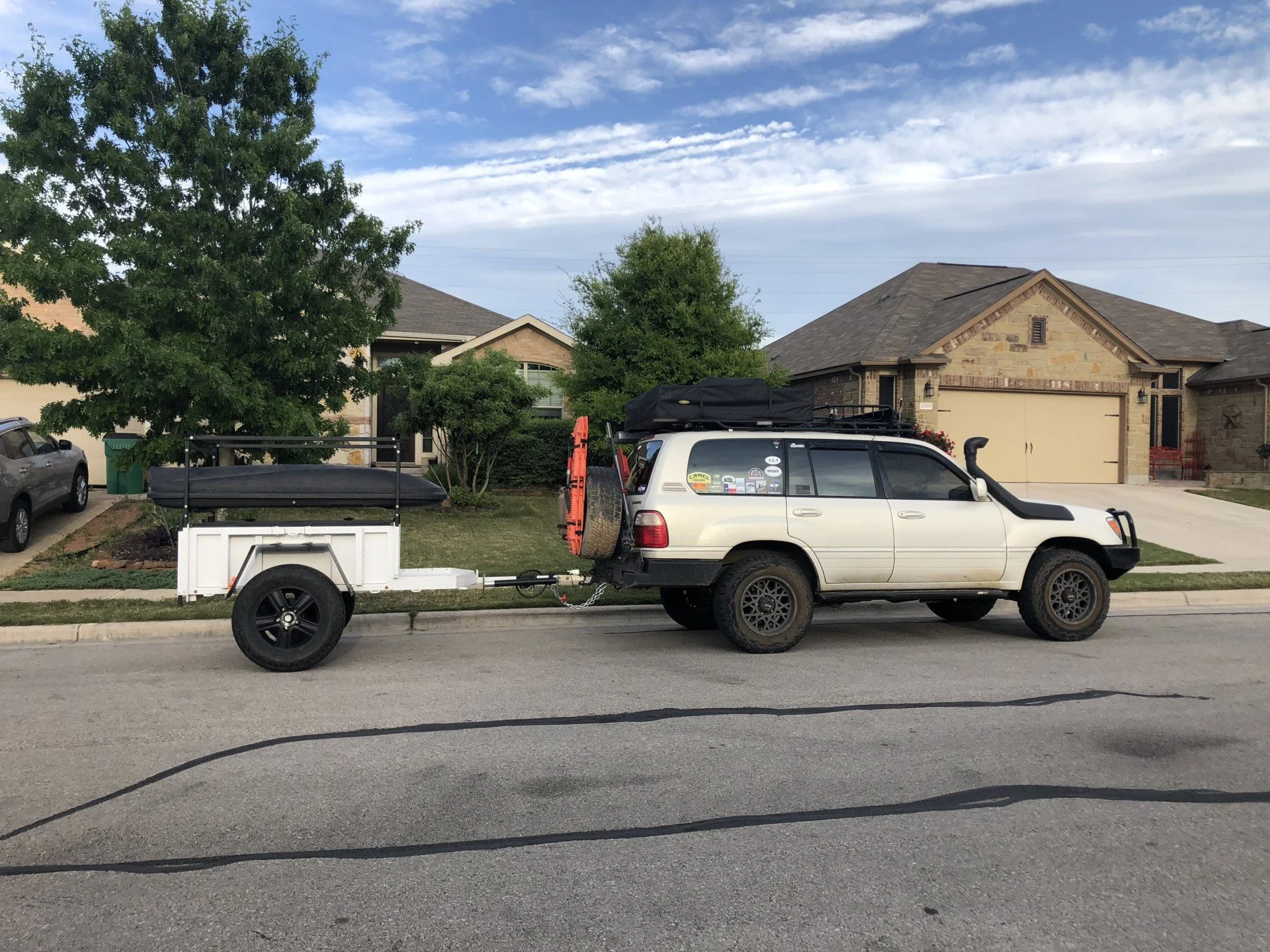

My new Morris Mule knock off was built with Timbren axle less suspension and Northern Tool hubs. I just put on the 33” wheel/tires yesterday and the passenger side hub grenaded. Shot all the bearings and fused the races to the axle. Was lucky it happened near home or the wheel could have flown off on the highway. I called Northern Tool and they said their hubs are really meant for light duty and bigger wheel/tire combos can cause failure. This is obviously a problem for an overlanding Trailer.

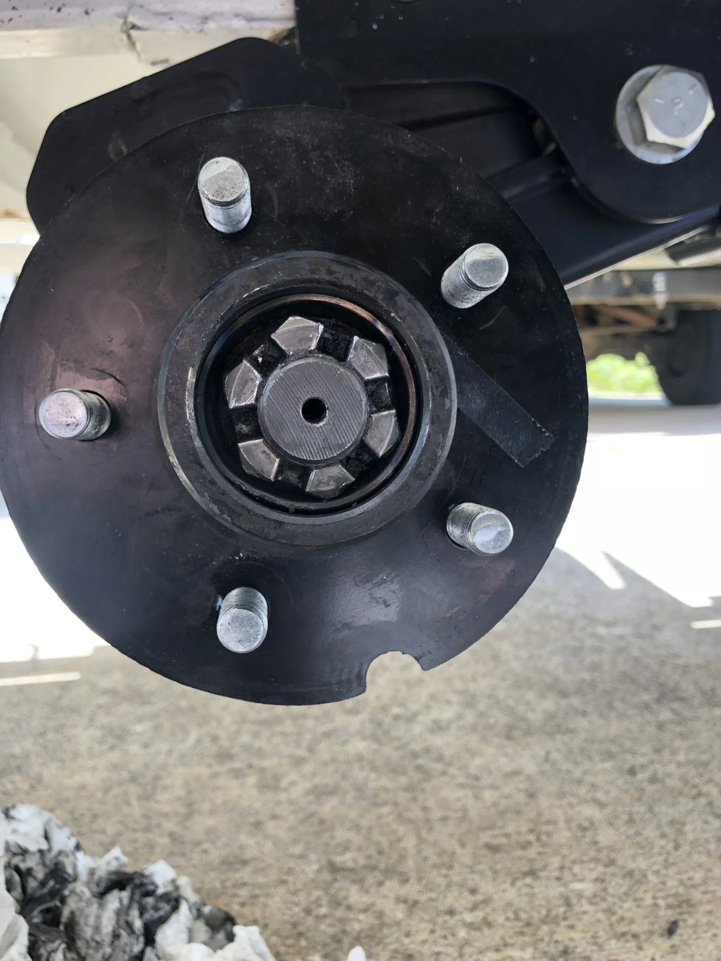

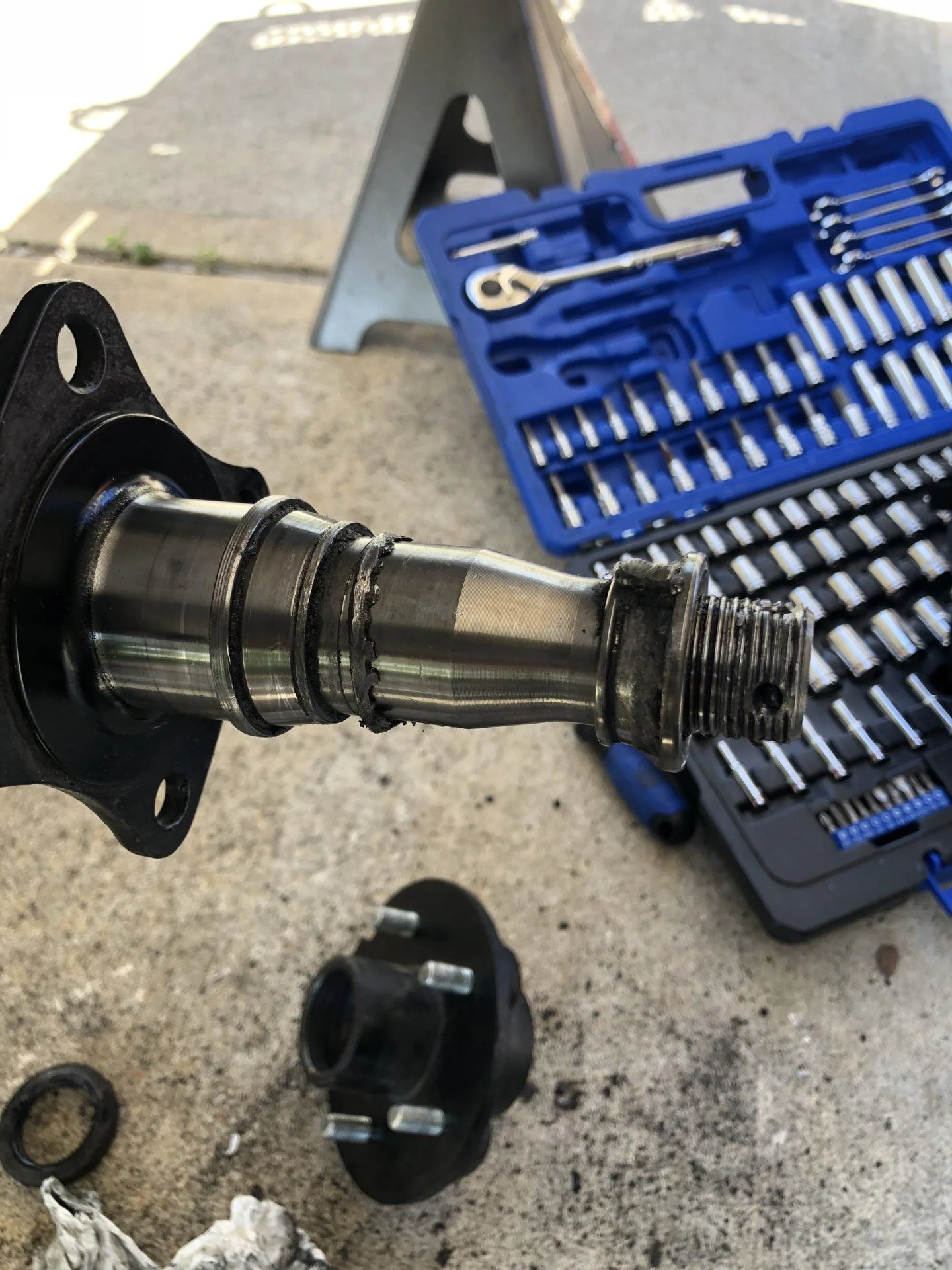

Not exactly sure where the fail point occurred in the Northern Tool hub, but it was bad. Literally shot out all the bearings, lined the inside of my wheel with 1/8” of grease, broke off the cotter pin on the castle nut and welded the races to the axle. When I jacked up the trailer, the wheel flopped all over the place. Northern Tool said none of their hubs are designed for 33” tires. They said they are all designed for standard 27” trailer tires and highway use....no off road.

Sorry to hi-jack a bit here. I have no real input on what hubs to get. I have often wondered though, when parts of the bearings fuse themselves to the axle stub like that, how you go about getting the bearing remnants off without damaging the axle stub itself?
Looks to me like the pre-load was off or possibly the grease wasn't up to the job. I've no doubt that the lighter duty hubs would have eventually failed, but that looks like a loose bearing. How it got that way is the question. Did the hub fail and allow a race to move removing the pre-load, or did it not have the pre-load correct from the start?
Assuming that the spindle isn't damaged beyond use one removal technique is to use an abrasive cut-off wheel and cut most, but not all of the way thru the top of the race. Place a serious block of wood or possibly a hyd jack under the spindle and take all slack out. With a big chisel placed in the slot you cut hit it a bigger hammer. The idea is to crack the last little bit of the race with the wedge shape of the chisel. Sometimes relief slots need to be cut in other places on the race for this to work. Take care not to cut into the spindle where the inner race buts up against the shoulder on the spindle.

The spindle was damaged beyond repair. The other side is failing too. I've done some more research and found out why. It had nothing to do with bearing pre-load though. It appears that Timbren offers 2 different versions of their 3500lb, 4" drop axle-less suspension. Mine is designed for smaller road/trailer wheels and has a smaller diameter spindle. The weight of the 33" e-Rated tires led to complete failure within 50 miles. I removed the other wheel yesterday and noticed that the pre-load was fine. There was no play or binding when spinning the wheel. But, it felt "grindy". I removed the wheel and opened the hub. The grease (which was blue when I examined it before purchase) is now a grey color with a silvery sheen. I pulled the bearings and they are clearly scouring. It appears that the spindle is likely flexing under the stress of the bigger tires/wheels.

The trailer I recently bought was equipped with the Timbren 3500lb Axle-less suspension. I outfitted it with 33" off-road tires and experienced a catastrophic failure of the hub that damaged the spindle beyond repair. This occurred within 50 miles of putting the new wheels on. I had driven the trailer nearly 500 miles home on it's stock 27" road wheels/tires and experienced zero issues. The bearings rolled smooth and the grease was a bluish color. I pulled the one still-working wheel off yesterday and noticed that the grease is a grey color with a silvery sheen. Pulled the bearings and they are clearly scouring. So, the other hub is failing too. Timbren is sending me a replacement spindle at cost for the one side and 2 new hubs (still cost me about $300).
Here's where it gets interesting and I think people would benefit from this research. Timbren offers TWO different 3500lb 4" drop axle-less options. The one I have is evidently designed for road tires and travel. It's noticeable in that it has a 4 bolt brake plate and uses a 2" square crossmember to connect the sides. It also uses a 5x4.5 hub. The other option is their HD which uses a heavier spindle and a 5 bolt brake plate with 2x3" crossmember and uses a heavier 6x5.5 hub. eTrailer and a couple manufacturers I spoke with say that the HD is the version to go with for off-road travel and heavier tires. They have said that the other version can induce flex when using heavier/larger tires off-road that can lead to catastrophic failure as I experienced. I am now faced with significant corrective costs as I must buy an entirely new HD setup ($800), hubs ($140) and adapters ($140) PLUS have someone cut out the 2" crossmember and replace with a 2x3". I figure this $3500 trailer is about to cost $5500 or more just to correct the issue that the wrong 3500lb axle-less suspension was put on. Additionally, I'll have a perfectly fine 3500lb 4" drop standard setup that I can't use. Hopefully someone needs one for their road going trailer and I can recover a few $$.
