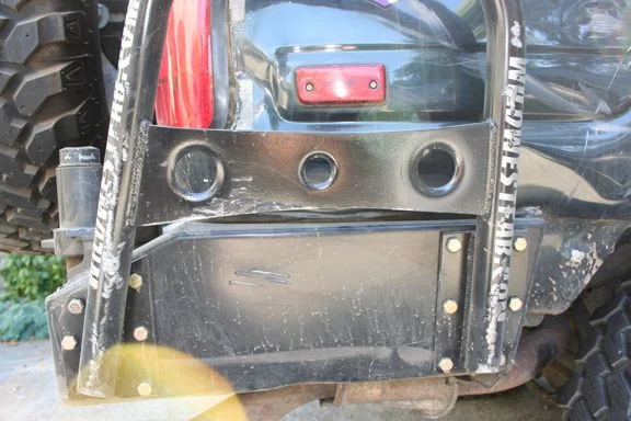

As promised here are photos and a report of the prototype bumper side hoops from Wild West Offroad Fab. Just ran the Rubicon with them. Leaned on the left side hard, right side less so. See pics. Neither time did they flex or deform the bumper metal. The impacts did gouge the metal, see pics, in what I think would be labeled quite normal for the impacts.
In the final analysis, two big thumbs up! I do believe they saved the vulnerable rear quarters and more importantly didn't get bent or damage the bumper themselves. Very cool! Here are the pics. Questions welcome!

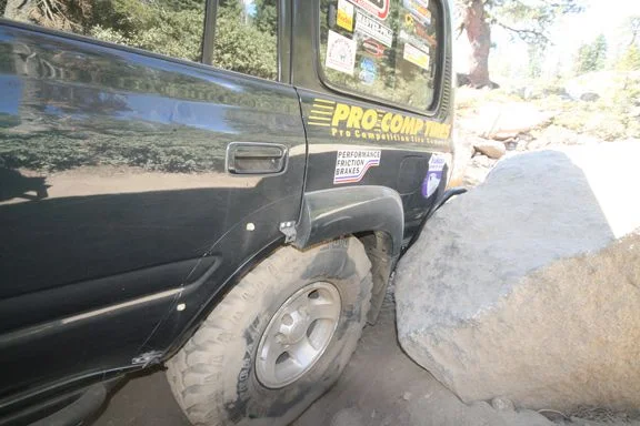

Lean on me...
The lean! It actually helped push the truck away from the rock. Strong!

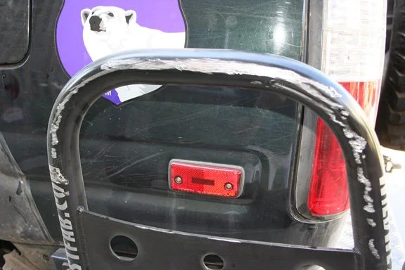

There is a good lean in that photo. When I get back I will post another pic. Lots of weight on the hoops. Check out the gouges in the steel. For a bolt on mod they are very good.
I have already ripped out the passenger side tail light and bent the hell out of the sheet metal so yes, I am quite certain these saved me rear quarter panel damage. Really a smart mod for Kaymar bumper owners--love 'em!

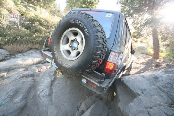

here are a couple more
here's a couple more pics. The impacts here were on the lower section where the welds join the tubes to the plates. No worries, all held up great.

Not that it matters, but that shot looks posed. There is room to the left to avoid the rock, and your front wheels are turned to the right--into the rock......
I wouldn't even know how to pose something on the Rubicon, while driving a hoss like an 80. :) It was all I could do just to keep going and save steel! That shot isn't posed, I can tell ya that. There were rocks/ledge in front, not open trail, and a pivot turn around that rock was the plan. We turned right a tad early and the rear went in. Bang, lots of weight on that corner. You can see how the Cruiser leaned over onto the lower part of the hoops. Couldn't have asked for a better moment to see how it held up. I truly cannot wait to do it all again next year!

Seriously though, with scratches that deep, they look like you ran them up hard against a few rocks on your trip. Hope that means we saved a little bit of your sheetmetal.
