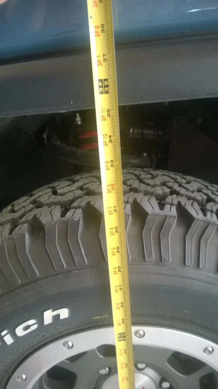

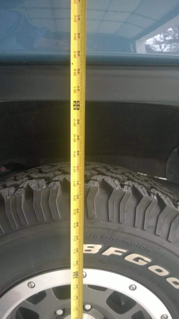

OK, I'll post what i measure on the TTUE.
Front from ground to flare is 35 1/4"
Front from top of tire to flare approximately 5 3/8"
Rear from top of tire to flare approximately 6 3/8"
I'll probably do some full flex measurements later on to the closest points.

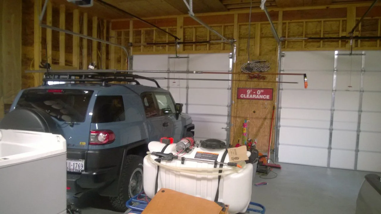

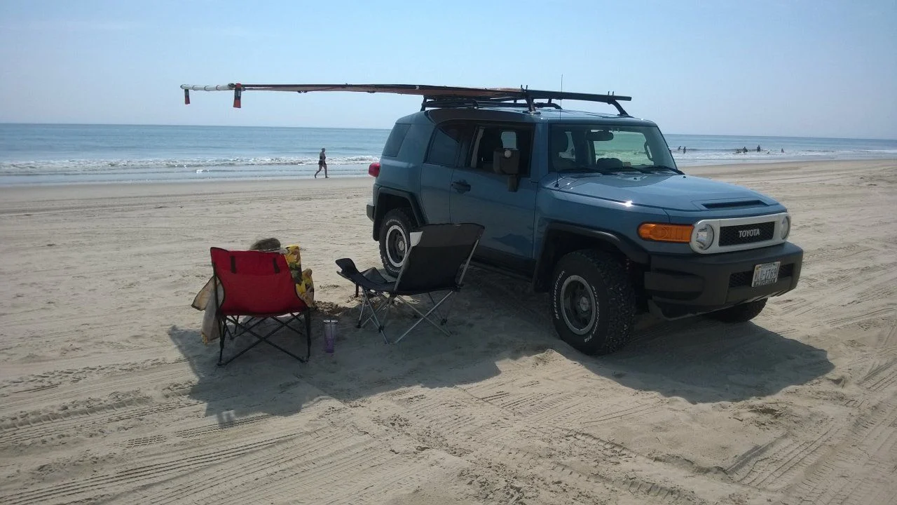

WES1977-nice!! you made the awning!? i was thinking of buying one. what did you use??
It's a steel square tube with two steel pipe extensions that fit tight to each other. The tarp Is a heavy duty walmart one. The extensions are pined in the out position. The tarp is rolled up on a pvc pipe with notches on the ends to keep the extensions spread. The tarp and pvc are stored inside. The square tube is U-bolted to the roof rack. The Tarp has loose tie wraps on the eyelets that I slide on to the extensions and when I put the pvc in place it spreads and tightens the tarp.
