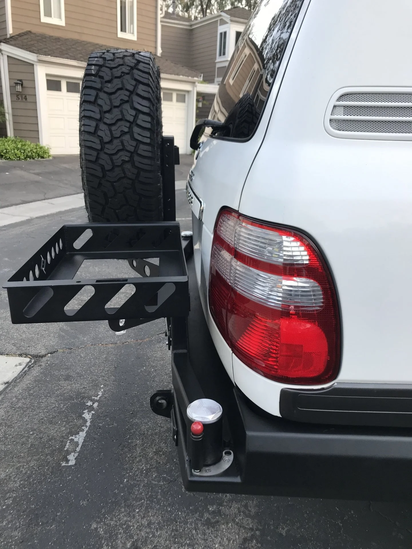

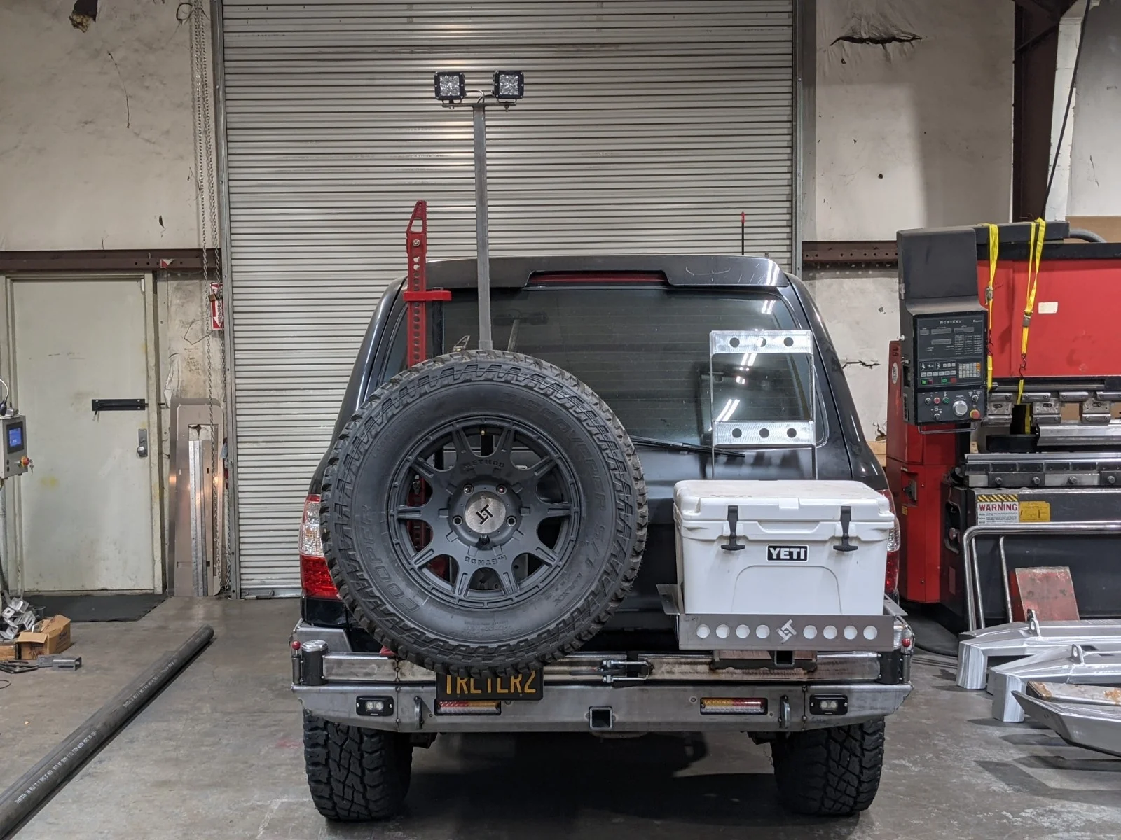

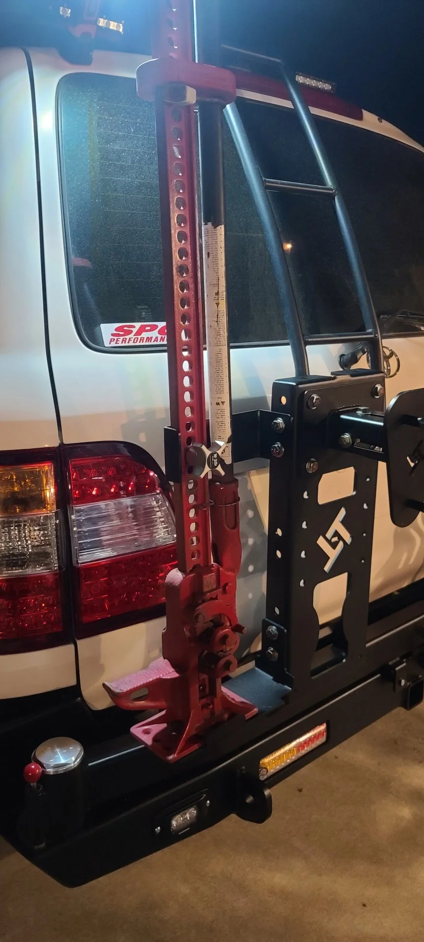

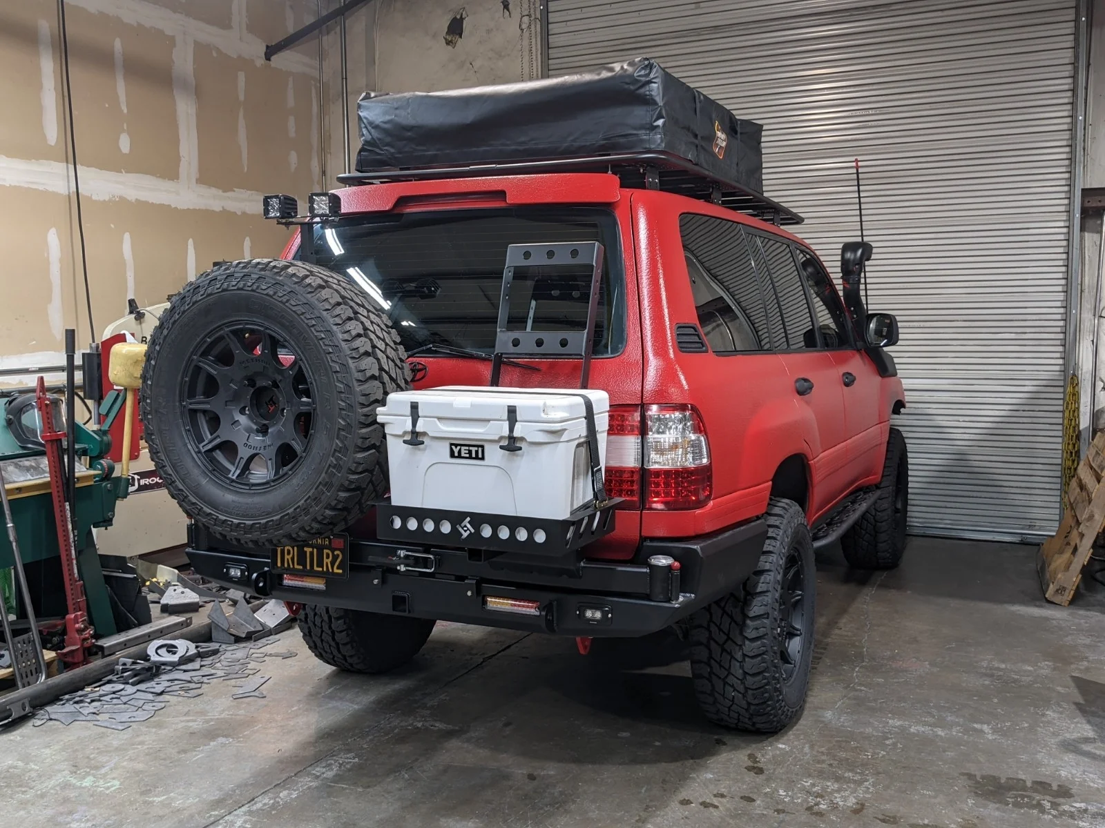

The bumper and swing arms are of top notch quality. Jason and team at @TRAIL TAILOR were really thoughtful in the design and fabrication. I would highly recommend it to folks looking for a rear bumper.
I didn’t have to modify the bumper or swing arms at all for the install. I really appreciated the dual Timken bearings and bearing seal for the swing arms. There are not any creaks or any noise from either swing arm when I tested them out over the speed bumps near my place. I had bought lug nuts but Jason thoughtfully included black ones as part of the kit and the strap for gas cans.
I think it’s 36 mm socket for the retention nut and 2.5” combination wrench for the swing arm caps (Harbor Freight has a jumbo set for only 60 bucks)
I really dig the modular ladder swing arm and the telescoping lights on tire swing arm.
