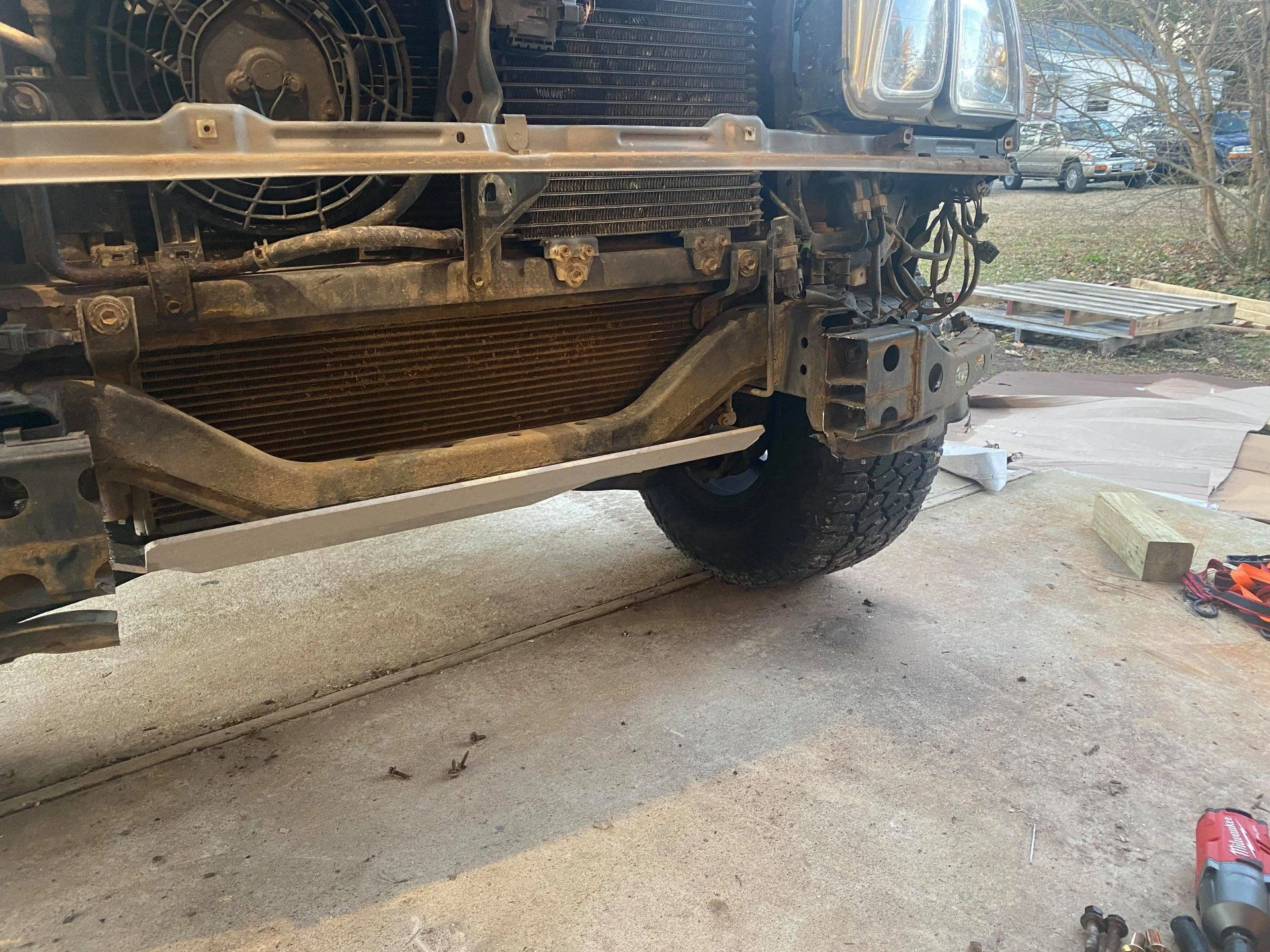

Cut out the center section of the crashbar

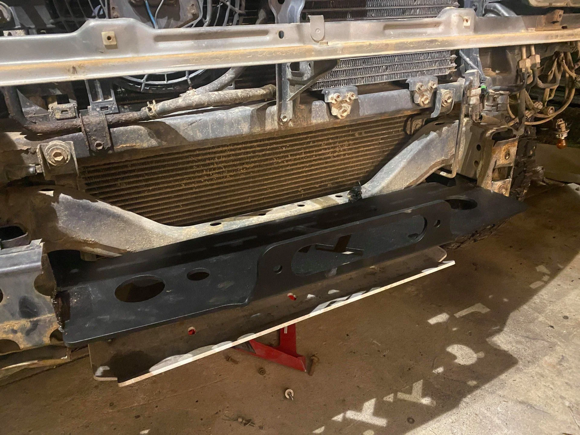

After loosening the ASFIR skid plate and lowering it a couple of inches there was ample clearance for the plate to mount to the frame. Don't worry the skid went right back when it was all done with no clearance issues.

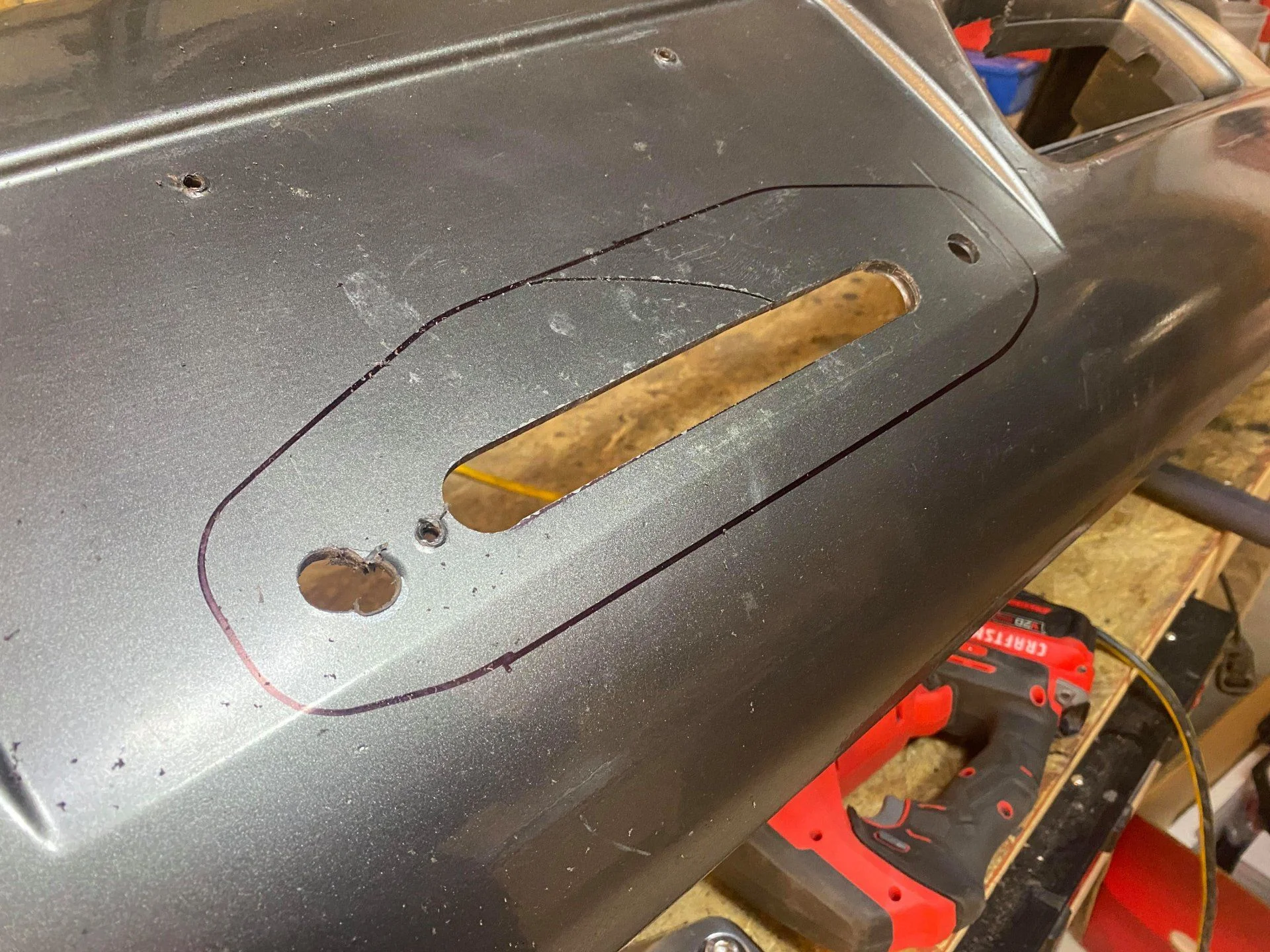

Slipped the bumper cover back on and aligned the three retainer clip holes to make sure it was on straight, then I used Trail Tailors instructions on how to mark where the fairlead will go on the bumper. I then drilled out the holes. (Notice my screwup on the left hole). I lined up the fairlead and traced it out. The jigsaw made quick work of the cut.

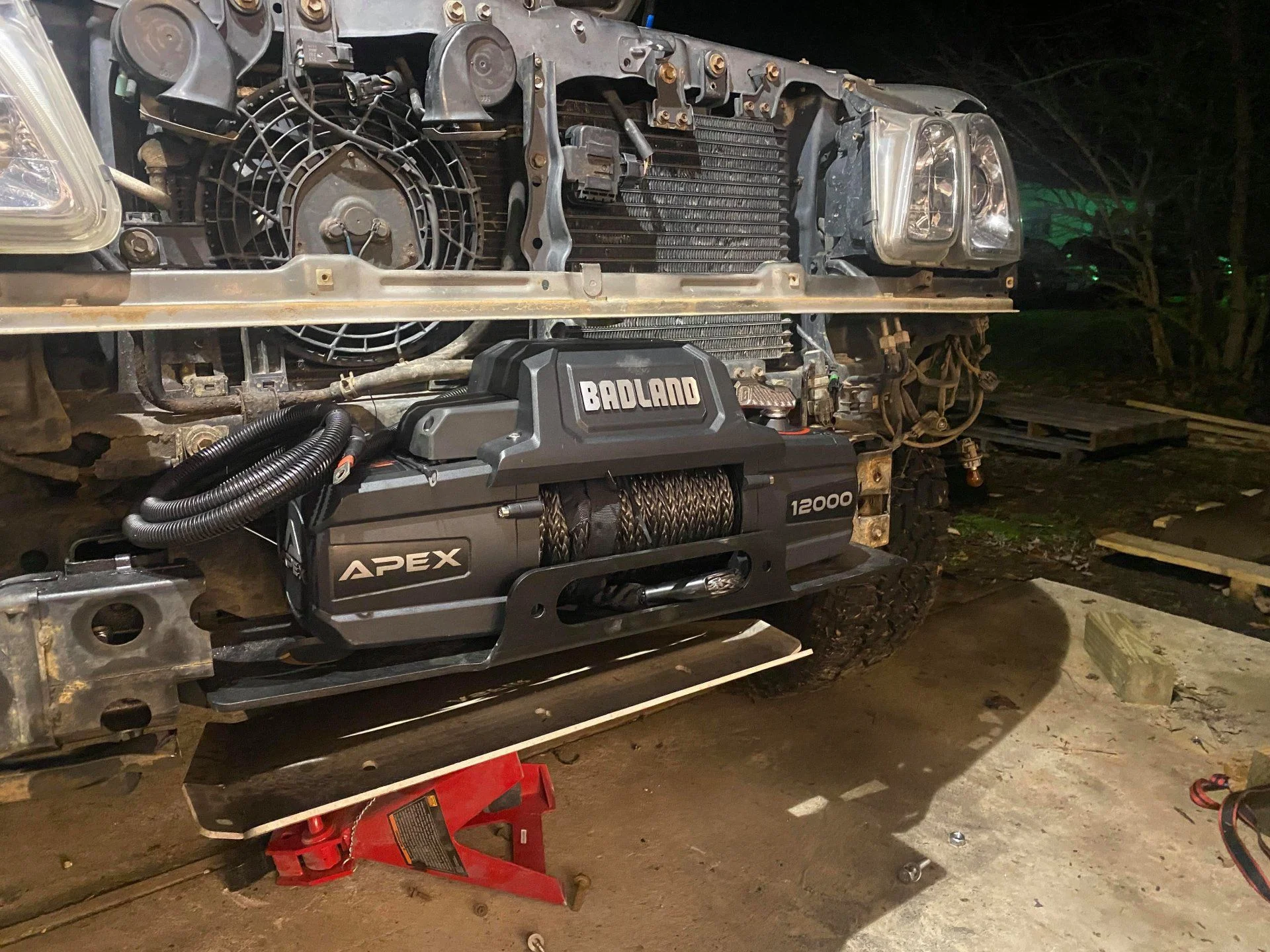

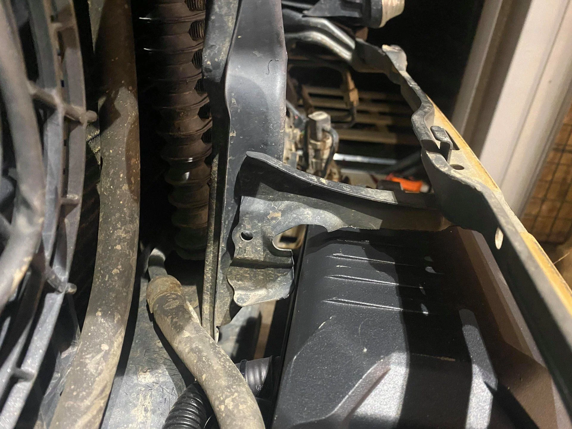

Here the winch is already installed but I wanted to show how much of the bumper cover center brace needed to be trimmed.

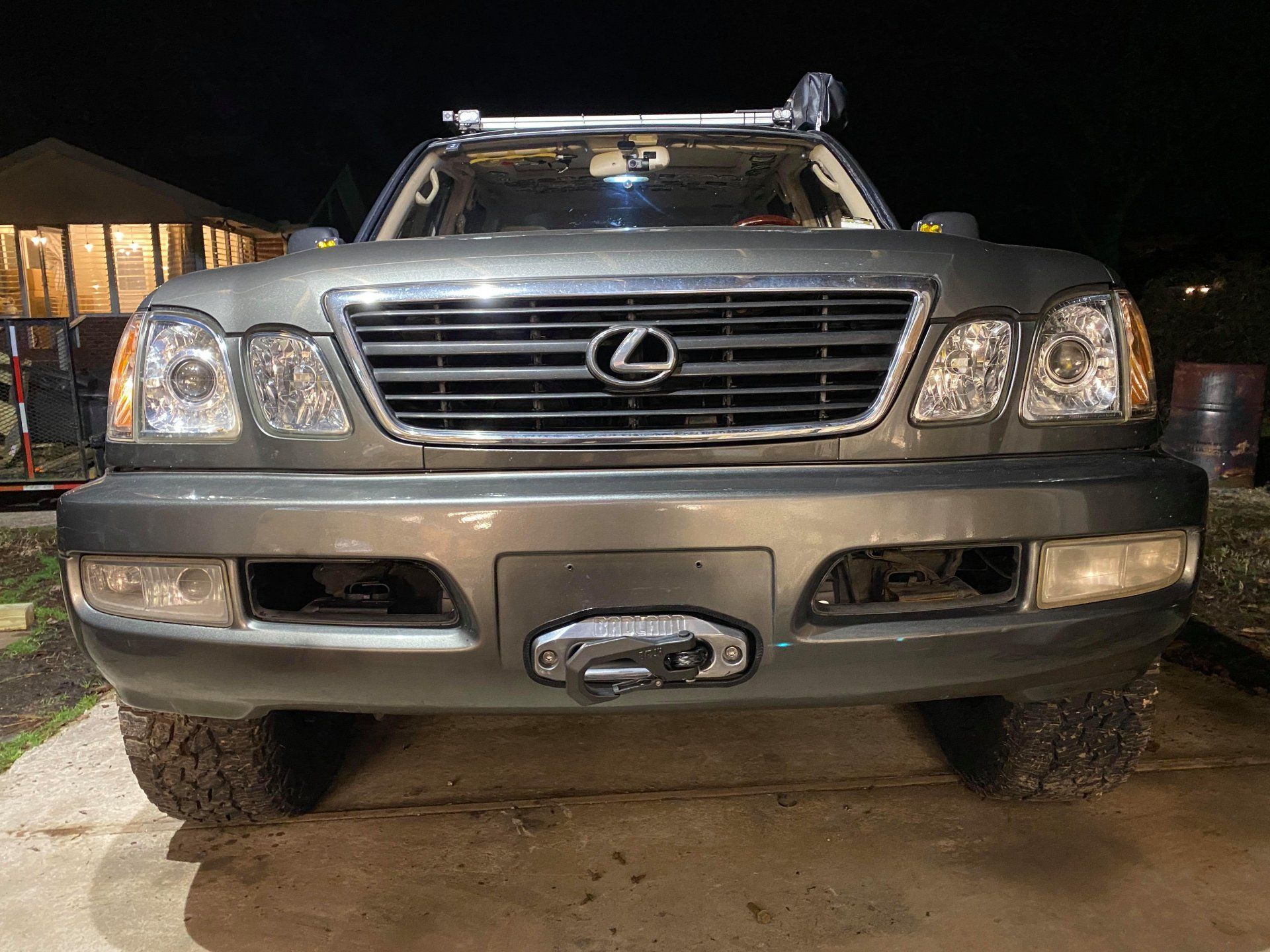

Winch all mounted up.

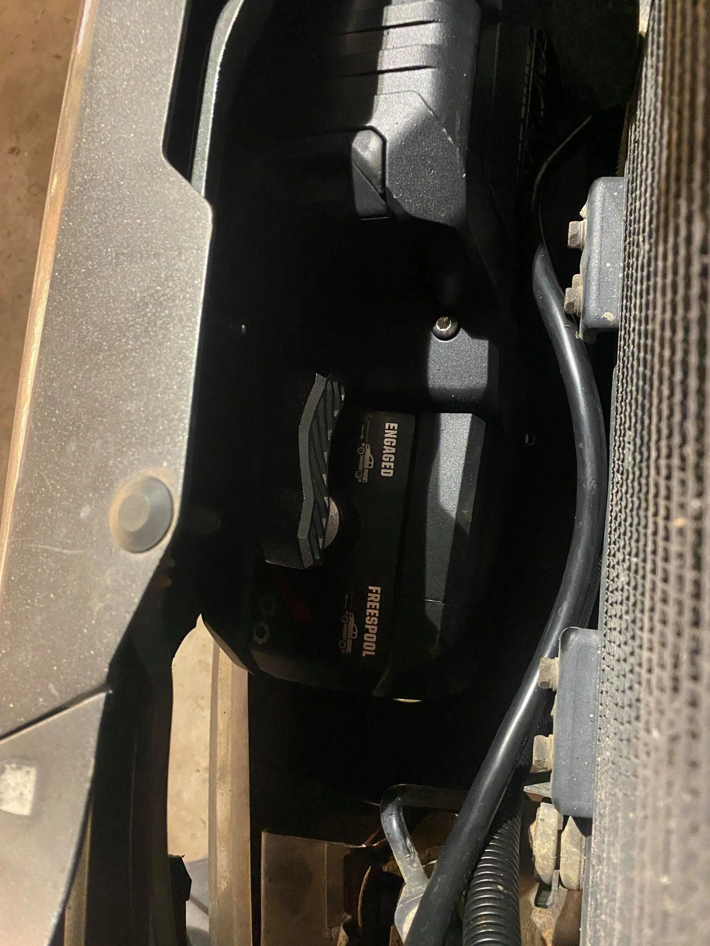

Thanks for this. Pretty sure I will be doing the same this spring. Would I be able to get to that freewheel lever on my LC? The grill does not lift with the hood. It does on the LX correct.
Not really sure. I'll look tonight.
Ya. I've got room in there to reach pretty easily I think.

On the second picture with the finished project there are 2 openings to either side of the fairlead. Is there anything there sturdy enough to mount some LED pods to?
Yes the bumper beam is right there. The beam actually goes almost all the way to the outside of the factory fogs
