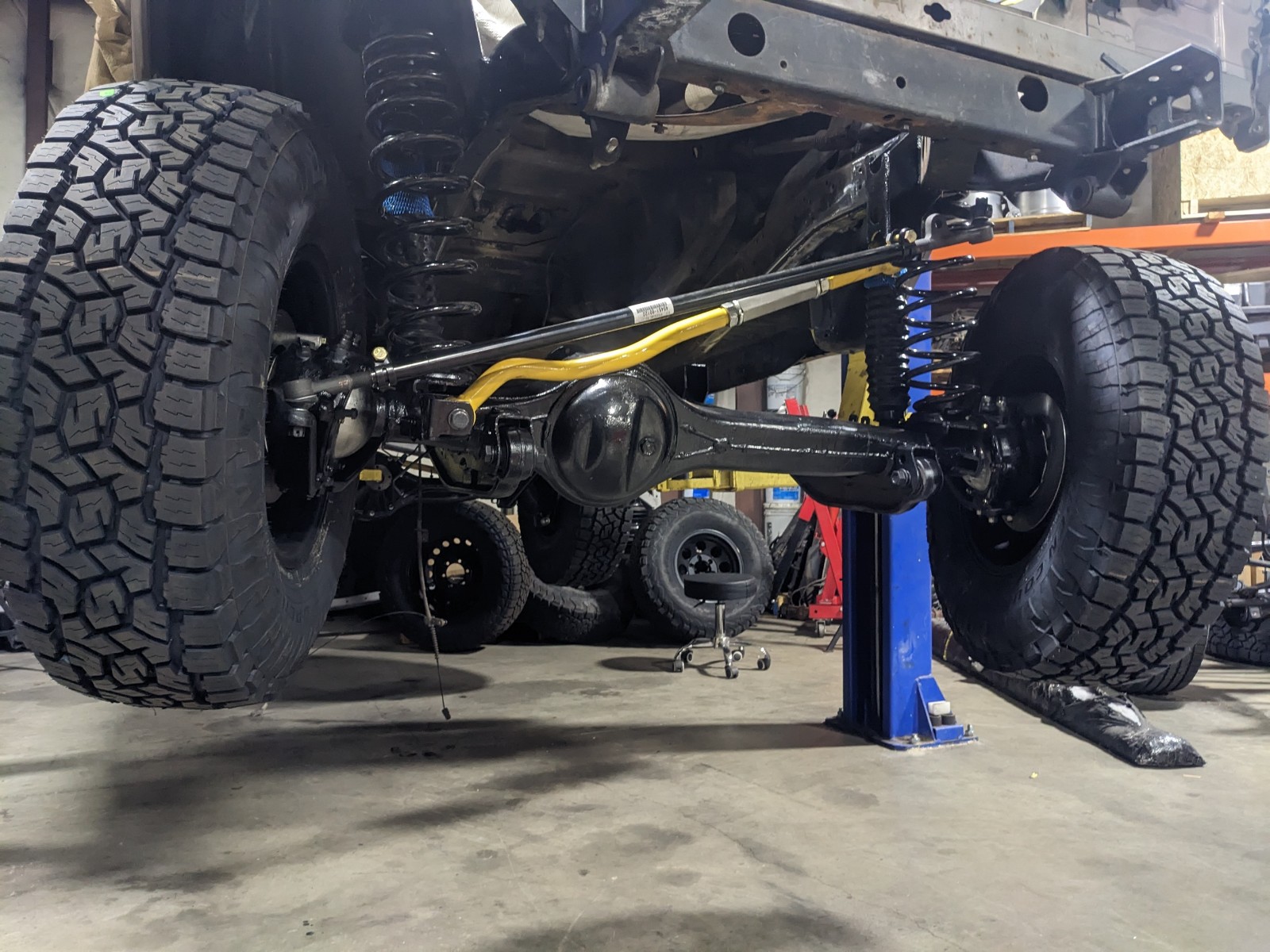

Front axle is coiled up. 11" of travel on the Dobinson IMS shocks.

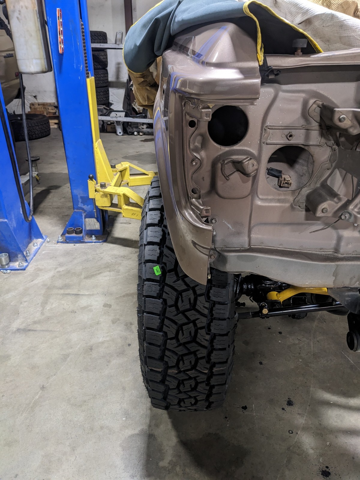

I pushed the axle forward about 5/8" to help with the 35s clearance.

Hi, with the 80 axle and those wheels, do you know if 35 x 12.5 tires be to wide / stick out much?

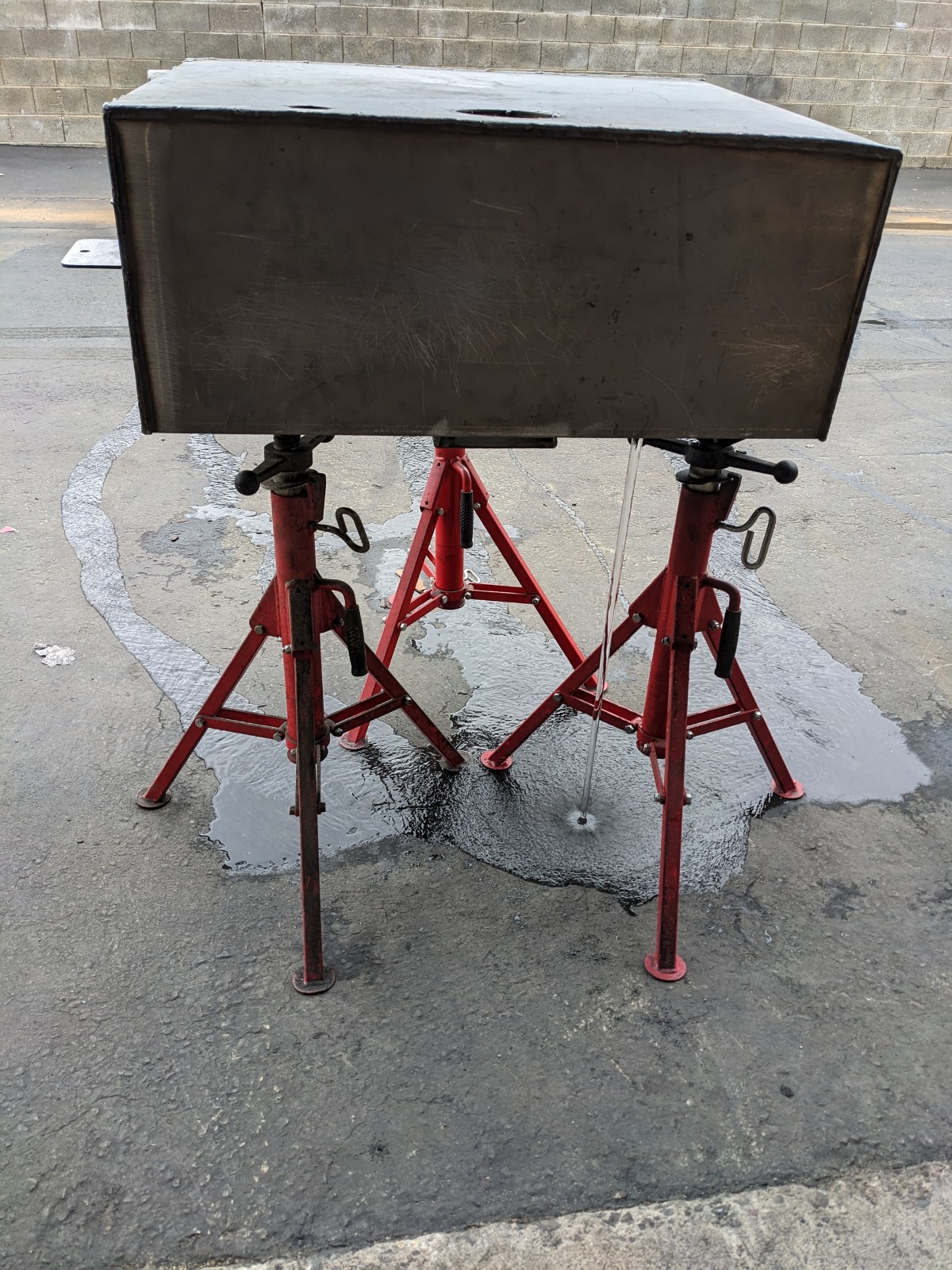

Amazing work. Are those tanks only for "in shop" trucks? I'm going to be in the market for a new tank soon.
These are coil conversion rear tanks. Not as deep front to rear but still hold 40 gallons and will work with leaf or coil rear suspensions.
