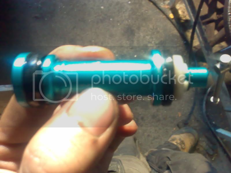

the MC: Remember to push the pistons all the way in when removing the stopper bolt on the side there.
Bolt seen at the top of the pix. 10mm head.
Sealing ring on the first piston (rear) is shot. Hard to tell from the crappy pix.

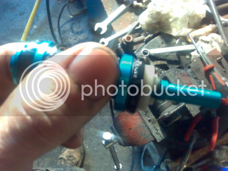

Easyer to see this ring, also shot. No wonder i had no brakes.

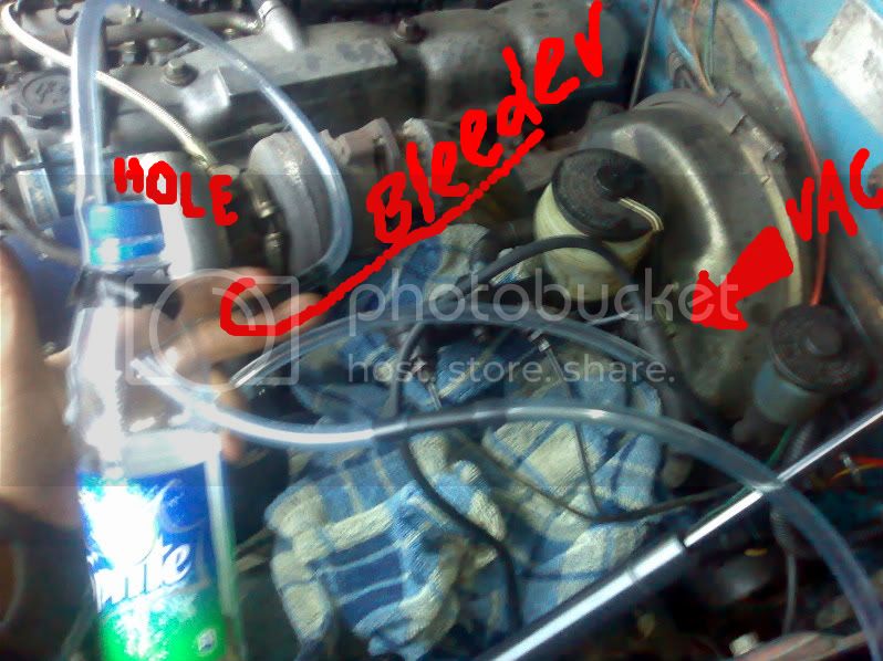

And now, the amazing vac-bleeder 2010 rev1:
-The Vac plugs into the vac from the reservoir. Hose just slides in. This long hose goes all the way to the bottle, sealed up good with hot glue to the top of the bottle. 4meters of clear line.
-The bleeder hose hooks up to the middle of the bottle, 60 com long. Also has that little rubber hose to hold tight on the bleeder valve.
-Rub a hole on top of the bottle, about 1cm. This regulates the vac on the bleeder hose.
