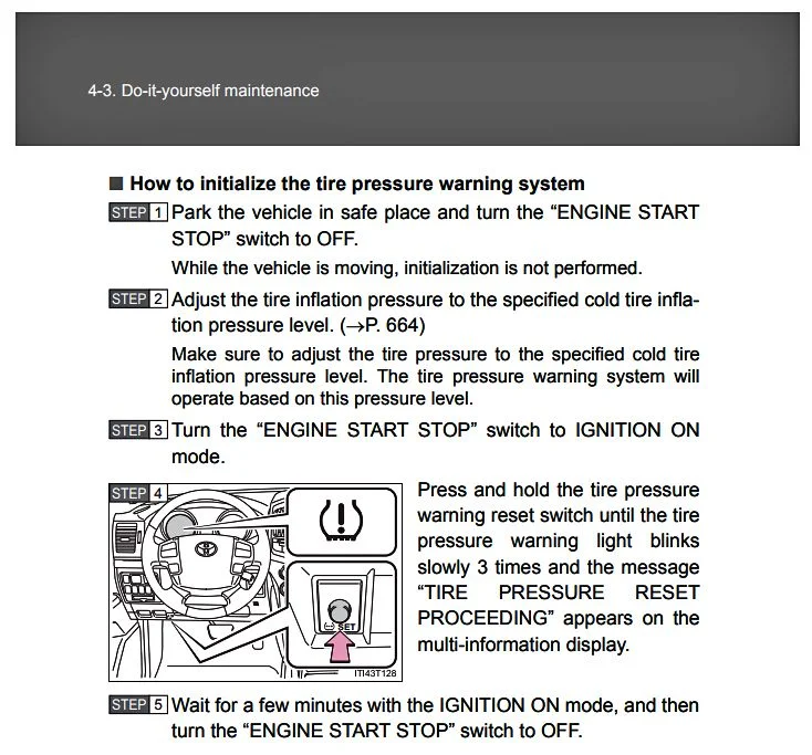

You could try initializing your TPMS:
HTH
Is step 2 referring to manually checking and adjusting your tires or is there something in the infotainment to adjust? Is (->P .664) referring to a page in the manual? Sorry I’m a bit of a noob when it comes to this stuff.
Step 2 is manually adjusting the COLD tire pressure to the pressure shown on the TIP (Tire Information Plaque) found on the Driver's door jamb.
Page 664 is the page in the Owner's Manual which duplicates the info on the TIP - Note: This reference is for a 2013 LC200 so may be a different page in your Owner's Manual, but in any case it will be the info on the TIP.
HTH
HTH

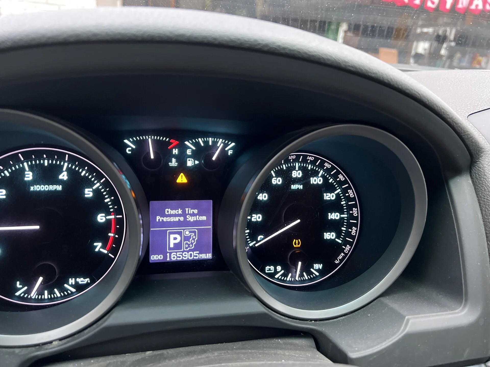

Alright, unfortunately that didn’t do the trick. As soon as I bring the ignition on I get the warning ⚠️ and the low tire light flashes. Flashes for a bout a minute than goes solid.
It looks like the engine is running in that pic - that should not be the case.
After manually setting the tire pressures for all 5 tires, with your foot OFF the brake pedal, push the Engine Start/Stop button twice - this will put the ignition in ON mode. Engine will not start and will not be running.
At this point, press and hold the SET button under the dash until the trire pressure warning light blinks slowly 3 times and the message, "Tire Pressure Reset Proceeding" appears on the Multi Information Display.
Wait for a few minutes with the ignition still in the ON mode, and then press the Engine Start/Stop button once to turn the ignition OFF.
HTH

Sorry the photo was taken when the motor was on just to show the lights. I did try with just the ignition on. I’m guessing it’s a bad sensor, maybe a dead battery. I have to try and find my OBD2 reader and see if I can narrow it down to which one, otherwise I can get 5 new ones for under $60 and just have my local discount. Thanks for the help and information to narrow it down!
