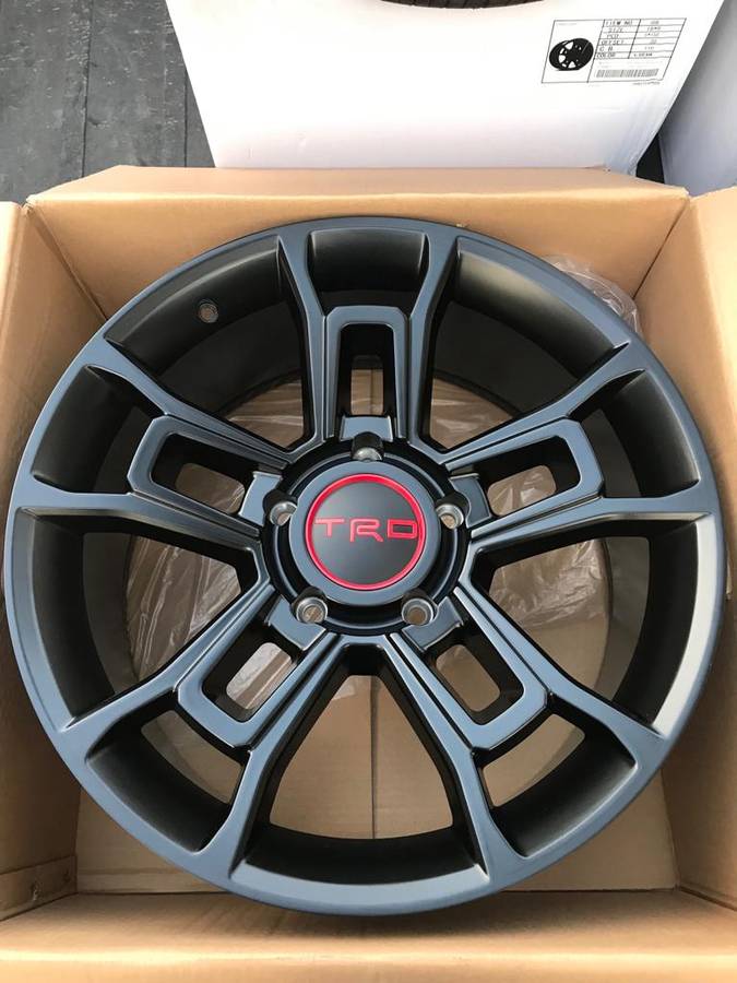

Every few weeks I do a search on Craigslist looking for TRD Pro takeoffs. I've stumbled upon these and I'm sure they are a knock off, but I'm curious about the quality. The 30mm offset is intriguing. Has anyone had any experience with these?

That listing shows both 18" and 20" wheels - so which are you interested in?
Regardless, the 30mm Offset, combined with the 9" width, will push the tires out more than inch beyond stock. Target Offset should be approx. 50-60mm.
Obviously NOT BBS wheels, and appear to be made in China. I'd pass.
HTH

The 17" TRD Rock Warrior wheels are made in Taiwan (ROC) to Toyota/TRD specs - no problem with those. The wheels in the OP appear to be made in mainland China (PRC) with no regard to Toyota/TRD specs - big problem with those, that's why I'd pass.
HTH

Chinese manufactured OEM products from Toyota and Apple are completely different than no name Chinese knockoffs. Unless you know and trust the brand selling the product, I would proceed with extreme caution on safety related items like wheels.
I do they have anything like a load rating for the wheels?
Fake TRD logo doesn't look great. For that price, you can get real TRD wheels.
