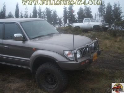

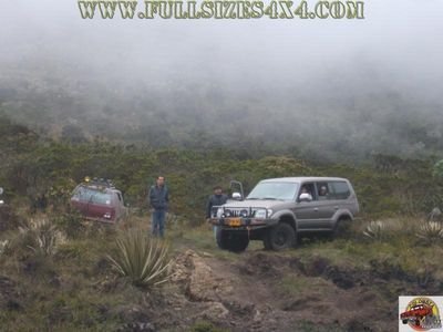

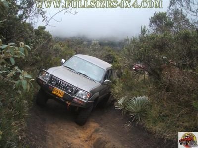

Sorry I didnt know how to attach all my pics
Jerry,
Nice pics ;p , it looks like you are very well prepared for the battle;)
Supplier names, contacts for the accesories, especially clinometers???
Tnx.
Accesories Prado 4 Doors
Bumper = ARB
Winch = 9.5xp Warn
Winch rope = Master pull
Lights= IPF Extreme
Roof Console : Outback
Cb Radio= Cobra
Tyres= 285/75/R16 Geolandar M/T
Wheels= Pro Comp Xtreme
Supercharger = TRD
Suspension= OME Heavy Duty W/ 2cm Custom made suplements.
Digital Compass = Original Toyota from the Prado Anniversary
No Rattle Noise = Dynamat Extreme
