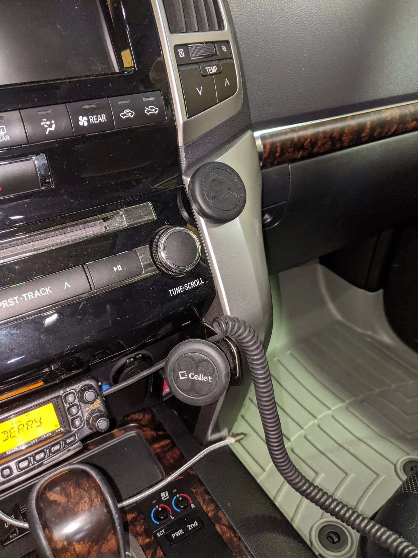

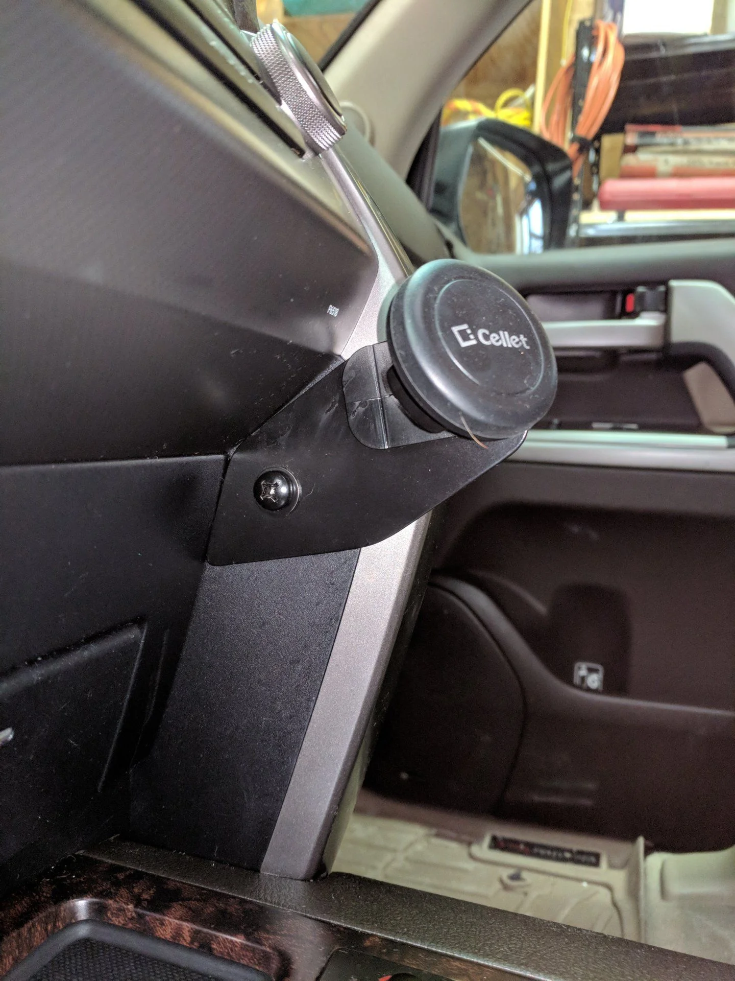

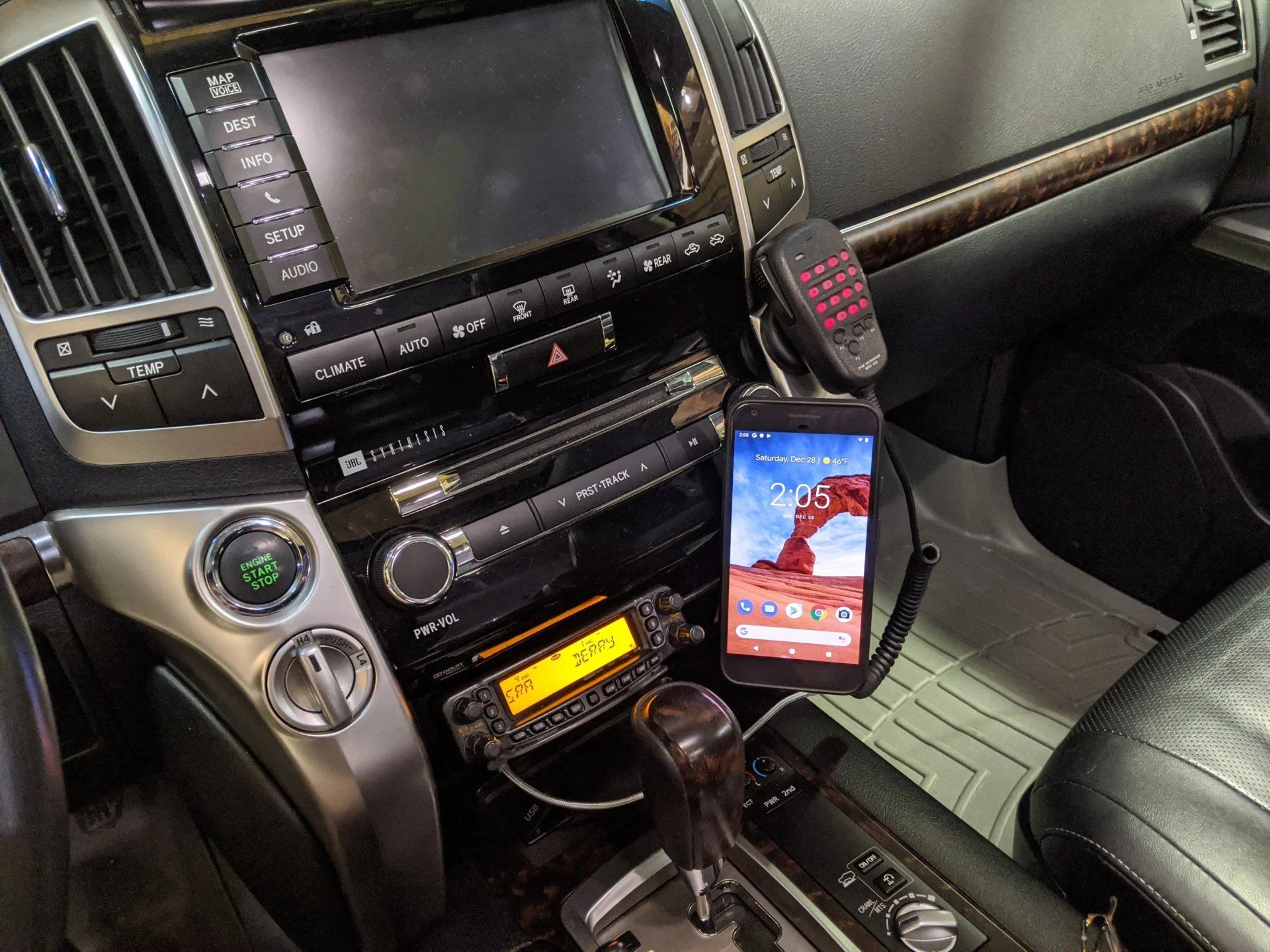

I've posted this in other threads, but here's some fresh photos of what I did.
I don't like having to fidget with mounts, especially the clamp-style. What a nuisance. And I really don't like having the phone up on top of the dash in the line of sight, being a distraction, especially at night. So here's what I came up with, this is my '15 which is a previous generation center stack, your HE might be different.
Found this mount on Amazon with a ball mount, and a "puck" with 4 very strong neo magnets. Whipped up a simple plate put of some scrap 16 ga steel I had, some 3M VHB double-stick tape. I put one #10 cap screw though a hole in the console as a backup, yes it's a hole in the factory plastic but it's really hidden.
Cellet Mount
I used epoxy to glue the metal plate to the back of the case on my phone, and that thing is SUPER strong, it never moves. Sooo nice to just get in the truck, slap the phone on the mount, no clips, clamps, or gizmos to mess with. It just stays put.
I've since added the head for my Yaesu 2M radio and several accessories to the panel where the ashtray is, including the switch for controlling the ML-ACR for my dual battery system, and I removed the factory 12V socket and put in a pair of USB style charging ports, one with a switch so I can turn it on when the truck isn't running. It's getting a little crowded, but I really like how it came out.
I use a stick-on magnet mount for the radio mic, it works great, no holes drilled required.
I have several of those magnet pucks in the truck and my other car now, they are super handy and strong. My son has a mount like that on the Miata that we autocross for holding the GoPro, and even when we toss the heck out of that car, the GoPro never moves.
