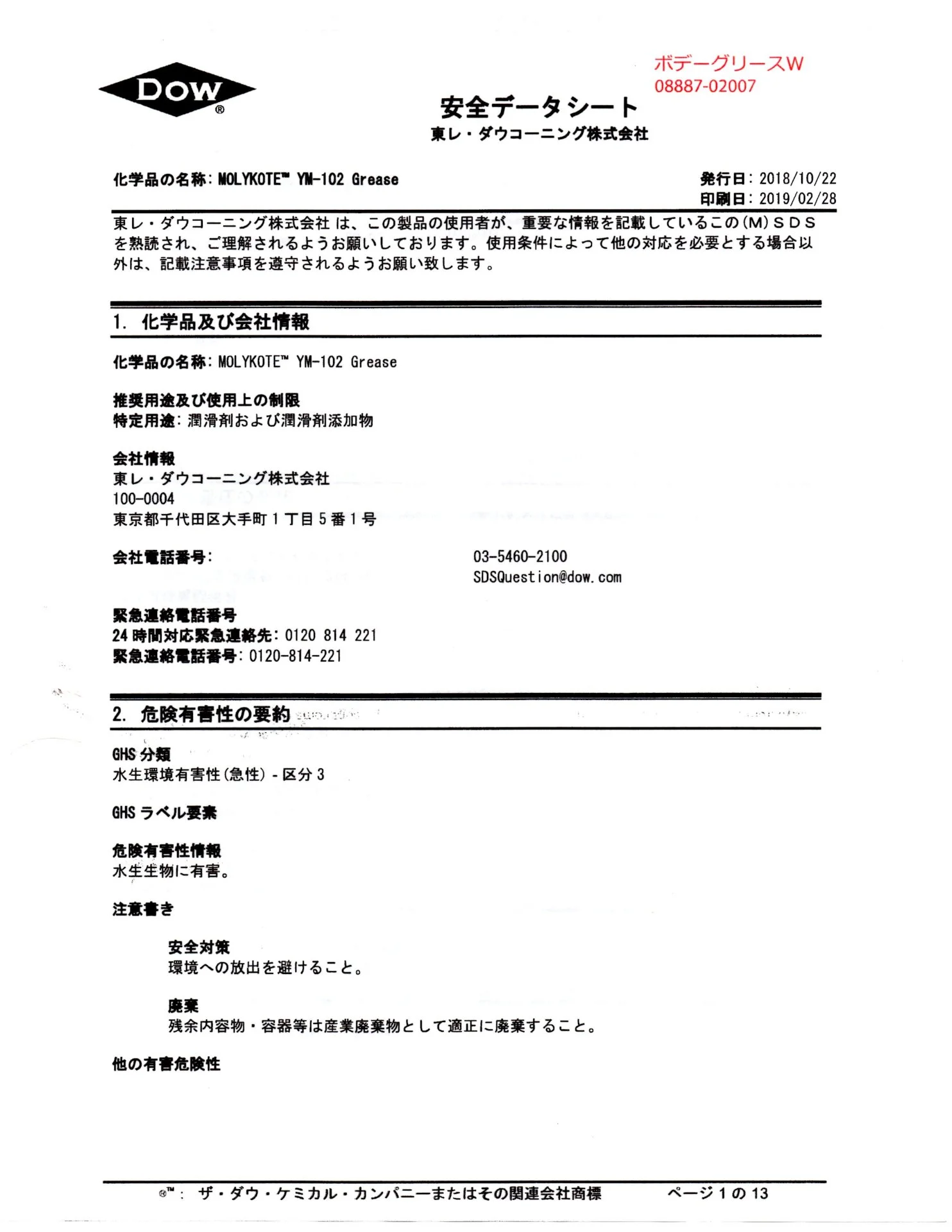

IIRC it might have a type of PTFE (Teflon) in it, similar to Dupont Krytox, which is also very expensive.
FWIW I've used Dow Corning Molykote 33 for plastic gears, it's a Lithium based Silicone grease.
Edit: apparently the Molykote line of lubricants is now owned/manufactured by Dupont (FWIW):

The DOW moykote is cheap in comparison.
