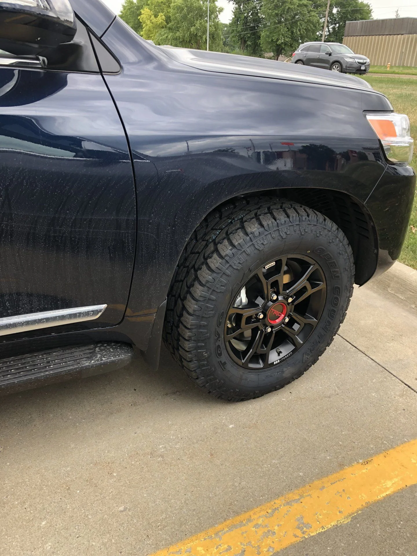

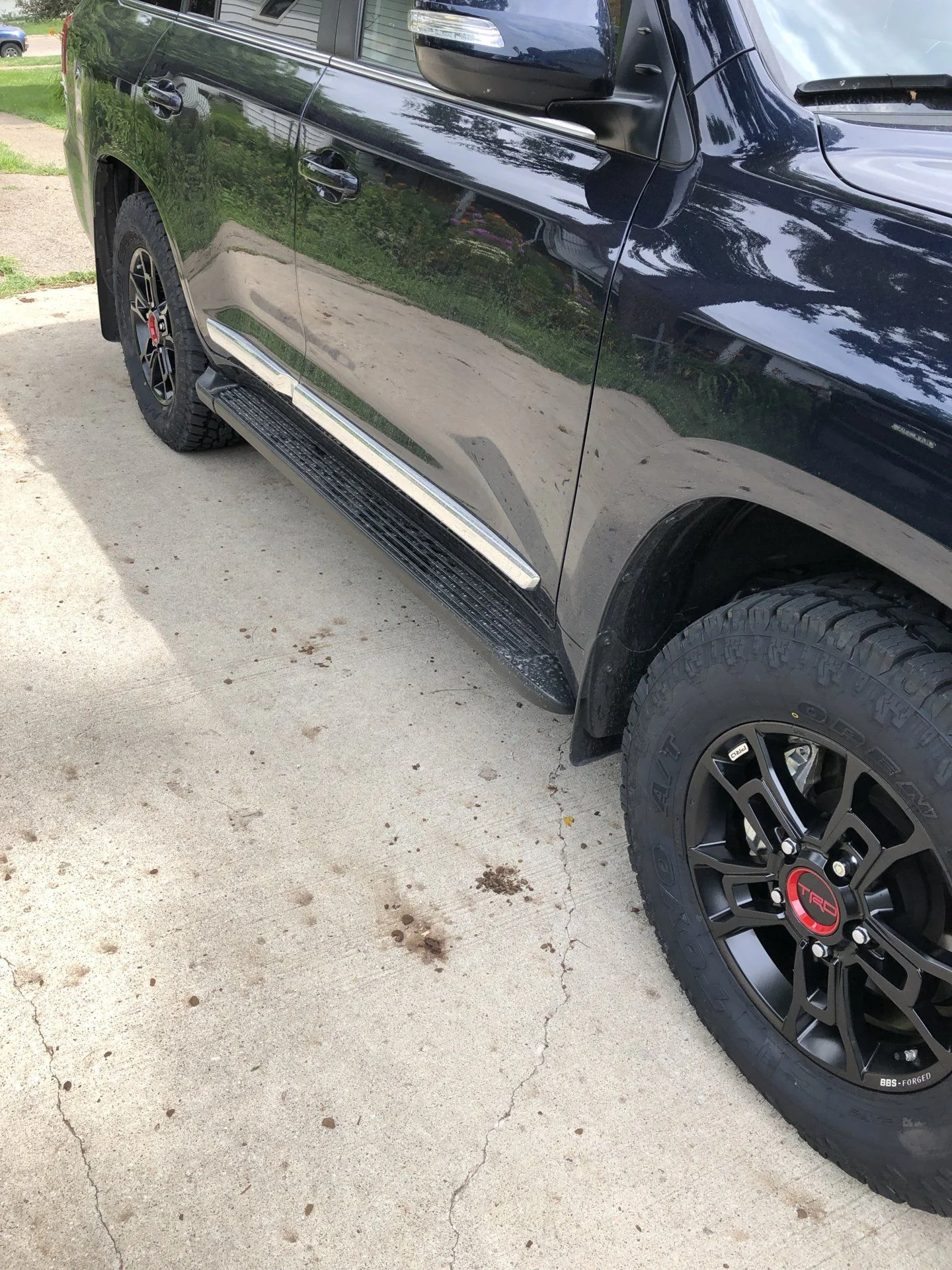

Hi I have a 19 LC with TRD Pro BBS wheels and Toyo Open Country 285/65/R18. Tire place who installed set at 35. Max psi is 80. What should I run. DD Thanks

View attachment 2042480View attachment 2042484
