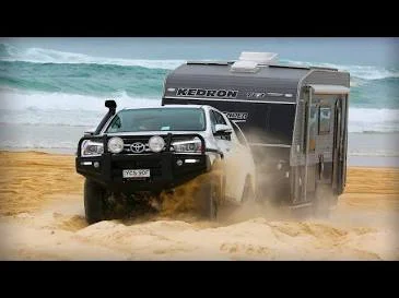

The weight. I can't imagine you'd take it across a beach or any sort of soft terrain at nearly 10k lbs. Even a steep dirt hill might be a show stopper with that kind of weight. Being mostly confined to hard surfaces or well compacted dirt and gravel seems like it's mostly intended for established campgrounds or rv parks. Not really something I'd plan to take out to hit the fire roads and beaches with.
Any idea why they're so heavy?
Kedron’s in Australia are a similar weight… have you seen where they take those?

Fwiw - that's probably being winched. They do take them on some pretty crazy trails but they need a lot of winch and towing to get through the rough parts. It's equivalent to towing another LX with a Camry stacked on top. With enough time and winch pulls you can get a lot of places. But it would be a lot easier with a trailer built wtfh modern composites that weighs half as much.

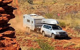

That’s my plan… I don’t plan to go off as crazy as Kedron does, but I plan on overlanding with it. You’re not going to catch me on Black bear pass, but I hope you find me on some smaller trails. If I want to go off-roading/rock climbing, I’ll take the wife’s jeep.
and to clarify, the pause reboot 17.4 that I ordered is ~ 7500 loaded, not 10k. If it’s too heavy, I’ll get a F250 tremor… but I hope that wont be the case.
While the photo I shared above was an extreme, this is more representative of what I am expecting…

Yeah this seems very reasonable, definitely will take a bit more pre-planning to ensure we don't get stuck on a trail and can;t turn around here on the east coast. The lx 700 is a fantastic tow vehicle by the way, at least for short trips with my dump trailer it has been great. The AHC really is clutch on these trips, adapting to whatever load I have on the back, Its a 10k gvwr trailer but usually don't have it loaded much more than 6k total. With no wind resistance it takes that element out of the equation.

A 7,500 gvwr travel trailer is on the heavy side for any ‘half ton’ truck/suv.
Proper weight distribution hitch and methodical loading makes it possible though.

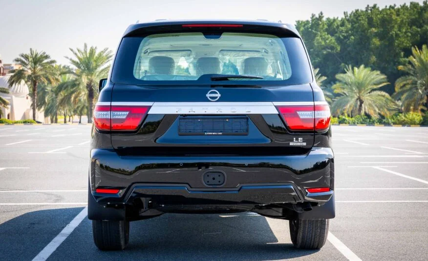

I think even at stock base height the Nissan Patrol has more clearance than the GM maxed out. Nissan did a really impressive job on that IRS system to maximize clearance.
The LX is quite a lot better as well.

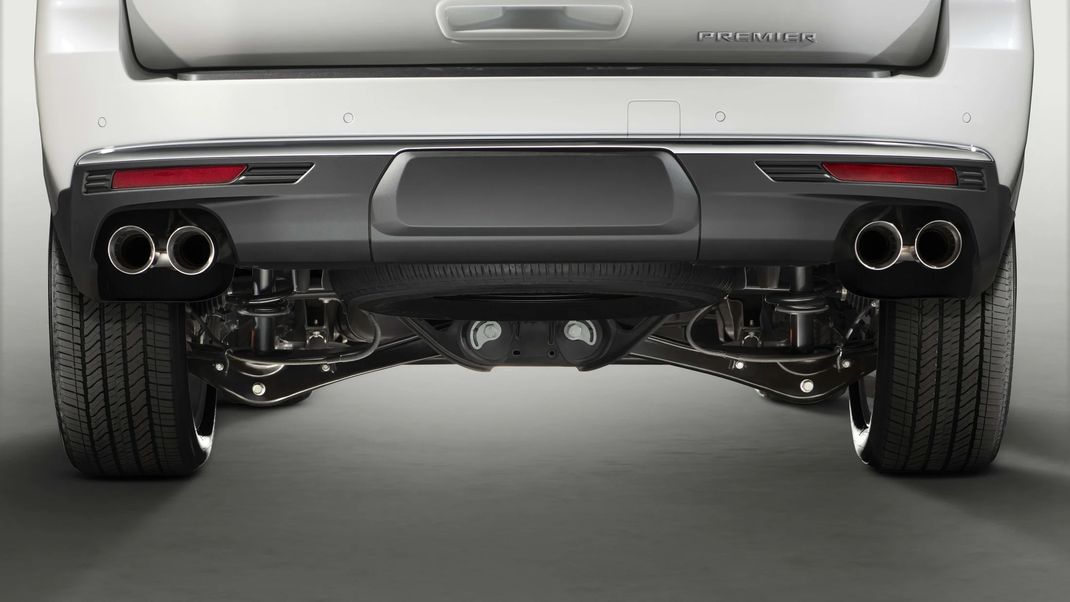

I don't know a ton about the powertrain strength on the late model GM full size SUVs, but the ones I've had in the past were not super confidence inspiring. I've got to imagine if they're holding up to almost 700 ft lbs of torque in the Cadillac trims it's pretty robust. If it's the same powertrain downstream of the engine. The killer for the GM offroad is how they designed the LCAs - they're just so low to the ground. The adjustable air suspension gets the body up nicely, but the suspension is really designed to sit low to the ground. Its kinda hard to fix this without some pretty major re-working of the system:
Yeah. That rear suspension on the GM's is weird. I had an AT4 Yukon before the LX600 and my wife has a 4WD Denali and I just can't get over how low those hung down.
