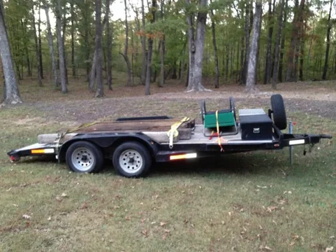

Been borrowing this trailer for two days working on my houses. It's got 3500lbs axles with brakes on both axles. Friend got it for a grand.
I'm gonna go ahead and call BS on those being 5K axles. I've built a few trailers in my time and have never seen a 5 lug axle over 3500lbs capacity.
Been using this for two days working on my houses. It's got 3500 axles with brakes on both axles. He for it for a grand.
huh?! you selling this for 1K?!
Damn! Why?!
That 20' is definitely a steal. It's got the good axles! and hub caps!
I just assumed it had hubcaps? Cause them little tiny centers can't even be 3500/lb trailer hubs... you think?
wngrog said:
Good eye Bossman.
5 lug = 3500
6 lug = 5200
8 lug = 7000 +
Rule of thumb but 95% accurate
I am gonna raise you,
This is about 99.9% true.
ask dude if those are hubcaps before moving on... They may be hiding 6 lugs and greasable hubs. They sure look like 16" hubcaps to me.
