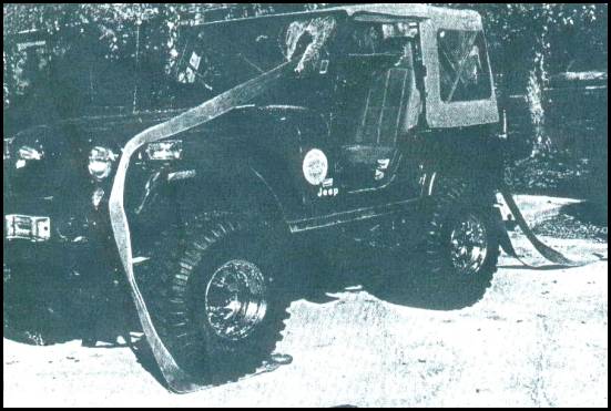

Bad recoveries and/or equipment can severely injure or KILL YOU - there is absolutely no reason to save $50 on used/abused/unknown equipment
Here, read these:
A Near Miss From
Support Groups for Jeepaholics - My best friend died today at a mudbog!
