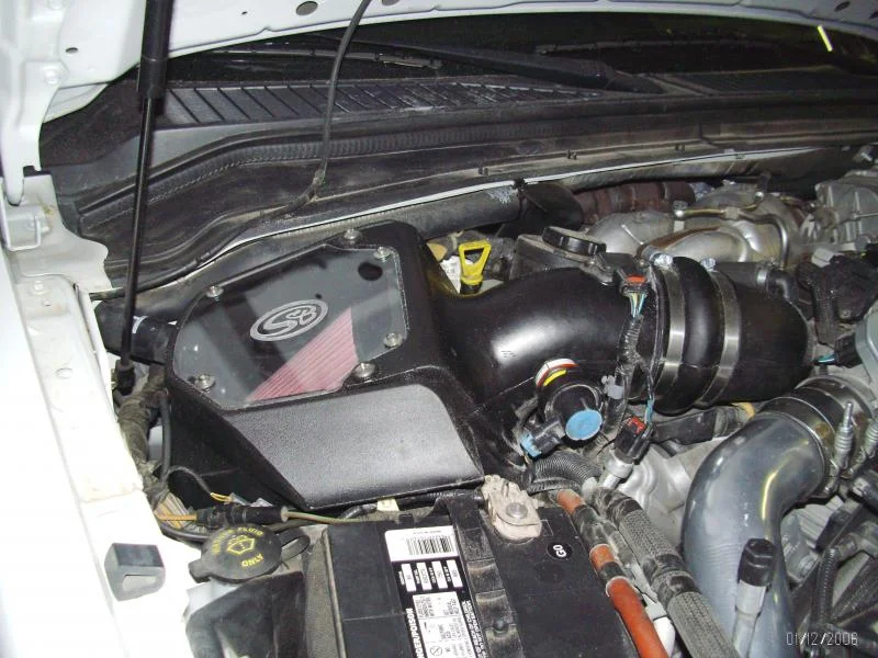

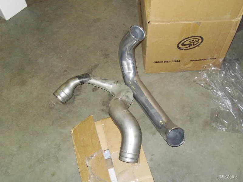

I put in the cold side intercooler pipe and intake system. the EGT's are definitely lower, especially when I put a larger load on it, like a full throttle run. here are some pics-
ooooh very nice!!!
