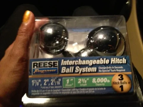

I was tired of always having the wrong size ball or wrong amount of drop. Fancy billet aluminum ones typically only have two balls and are very pricy.
I picked up this universal drop hitch for $25 from Harbor Freight and a 3-way universal Reese ball for $30 from Amazon.
