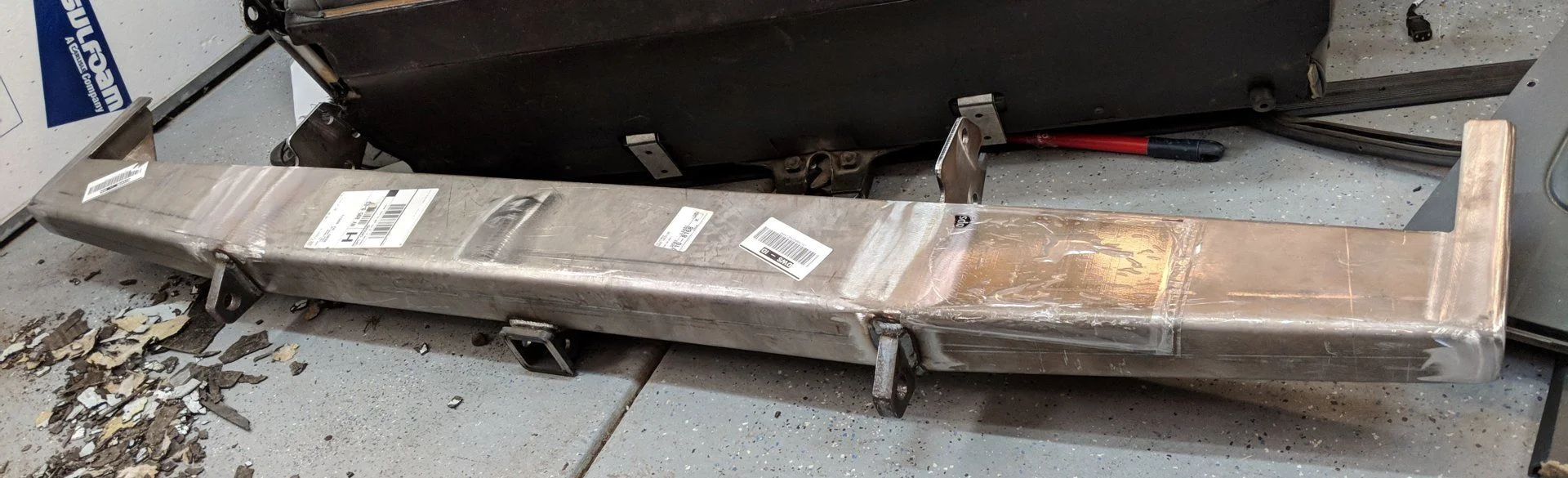

Alright Guys. So I got my bumper in. All 108lbs of it!
full
It turns out that I have to drop the fuel tank to drill and attach the mounting bracket to the frame. So I am looking for a transmission jack I could borrow for a few days so I can safely drop the tank and lift the bumper into place so I can bolt it up. Does anyone have a transmission jack I can borrow?

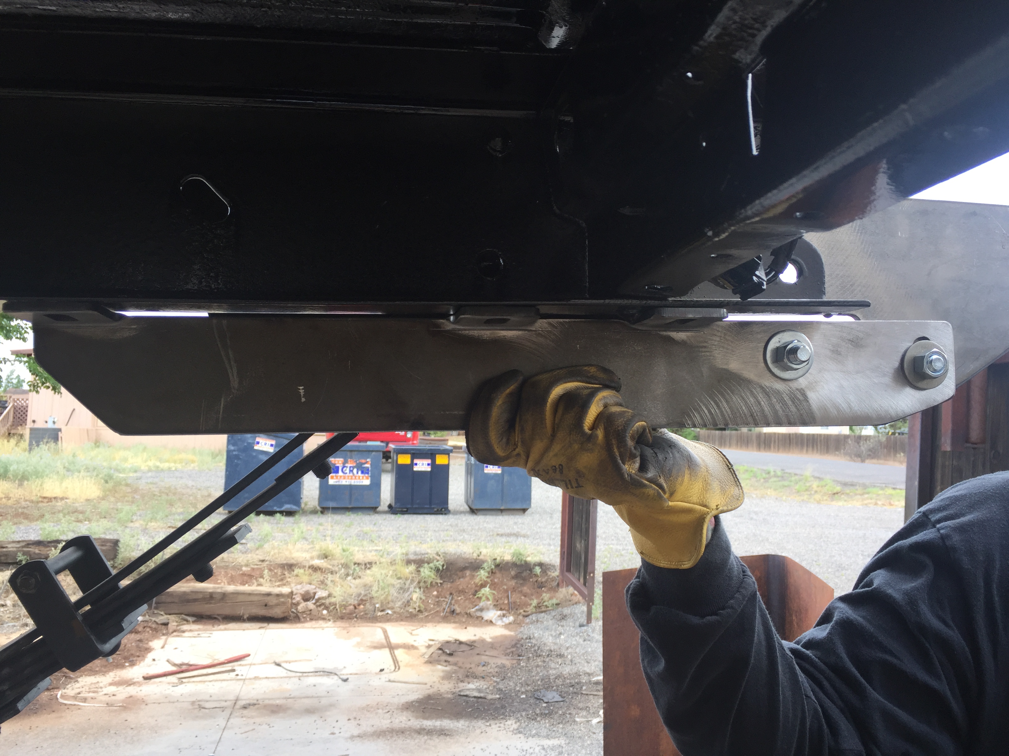

@lelandEOD and @gregnash or anyone else with welding chops: I posted about this on a Bronco forum and a guy told me I don't have to drop the tank if I weld the bracket rather than bolting it to the frame. I don't know which would be easier though at this point. Welding seems it would be faster, I just don't have equipment or skills to get the job done. Do you have a welder that can properly weld 1/4" plate steel? If so, could I avail you of your welding skills? I only have a 220v outlet for my dryer at my house though. The Bronco drives fine though, so if you are willing and able, I would bring it to your place for the welding bit.
Here's a pic of the bracket...
Sorry Tony, 1/4" is at the VERY top end of what my little welder would be able to do. And even at that we would probably have to do multiple passes to ensure it was a decent weld and at BEST from me it would be a Decent weld.
Other thing to think about is that you are welding right next to a fuel tank. While likelihood of a spark igniting I would be VERY wary of doing that myself.
Unless you have a 220V welder I'd either take it to a shop or stick to the bolts.
If you siphon out as much fuel as possible the tank won't weigh that much. You could also check for a drain plug.
I'd get the tank empty then use a couple of jack stands with shims to support it while you get the fasteners and hoses loose.
BLEH! :) I guess I'll drop the tank. Thanks guys.
