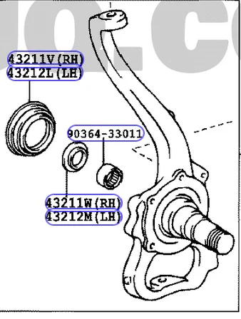

You certainly need to grease the spindle needle bearings. That much play tells me there isn't much grease in there.

Just to be clear, I'm not talking about the traditional wheel bearings that go on the hub and hold the rotor in place, but the spindle needle bearings that are inside the hub (90364-33011). They are pretty hardy. I replaced mine out of abundance of caution when I also found the grease in my bearings to be lacking, but I honestly could have gotten away with just greasing them. Someone makes an expensive tool to do it, but many of use use the 1.5"PVC cap method.
Thanks for the clarification Bisho, will check it out and wheel bearings for a simple regrease… keep the on order wheel bearings for the future then. Appreciated
