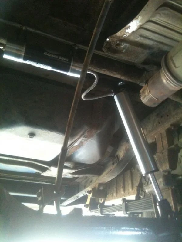

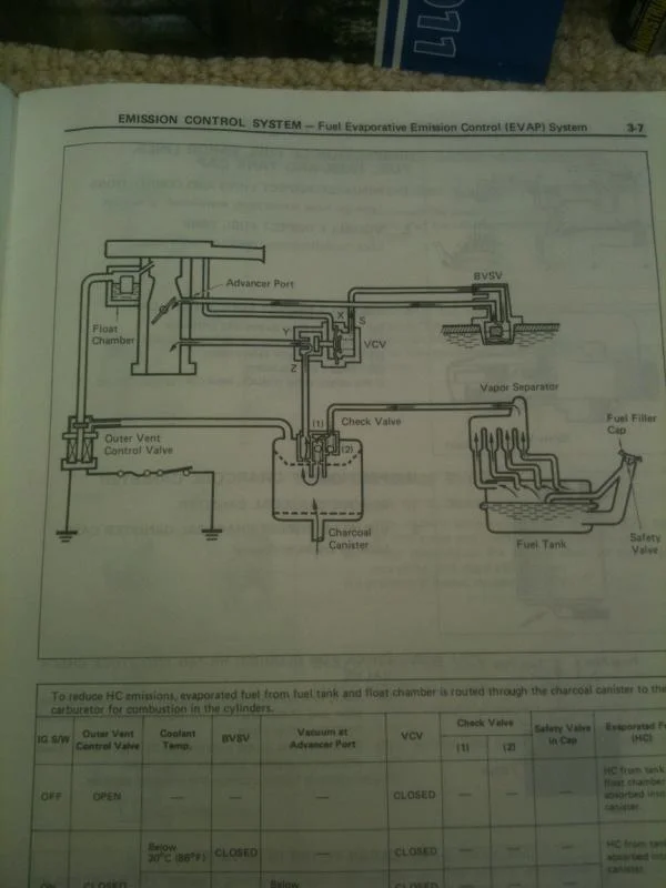

during the mounting i had to cut the exhaust off which is normally no big deal until you drive to town before putting a turn down back on. This can lead to heating up your gas tank big time, i didnt think it would and i was proven wrong. to make things worse my i had a plugged tank side charcoal filter and i had no vent path! I swapped it around today after blowing it out. I searched for miles on here looking for information to help me out and it was vague at best. my solution was to go with the fsm emissions book (red one). I copied it so someone else can search and find this helpful piece of info.

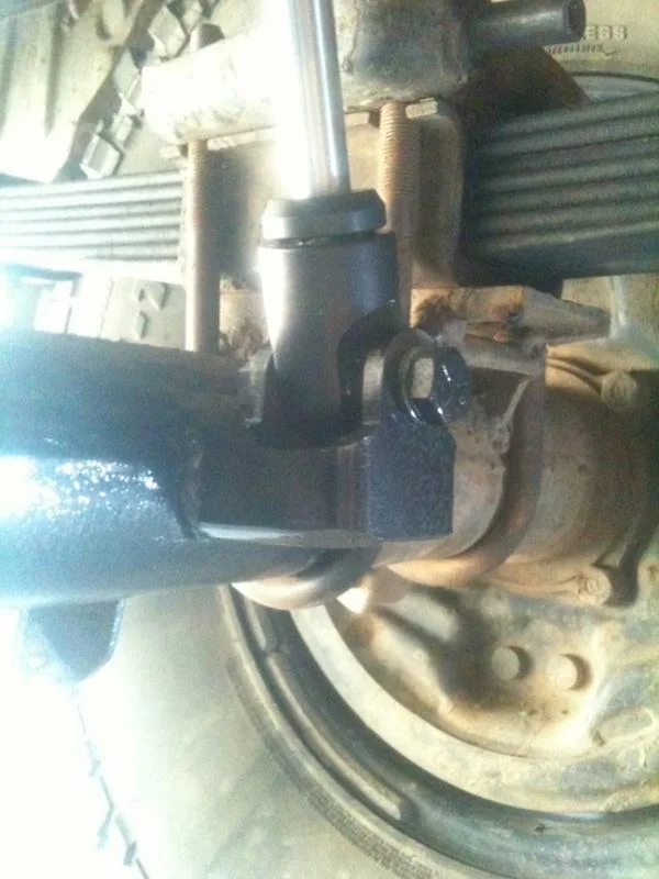

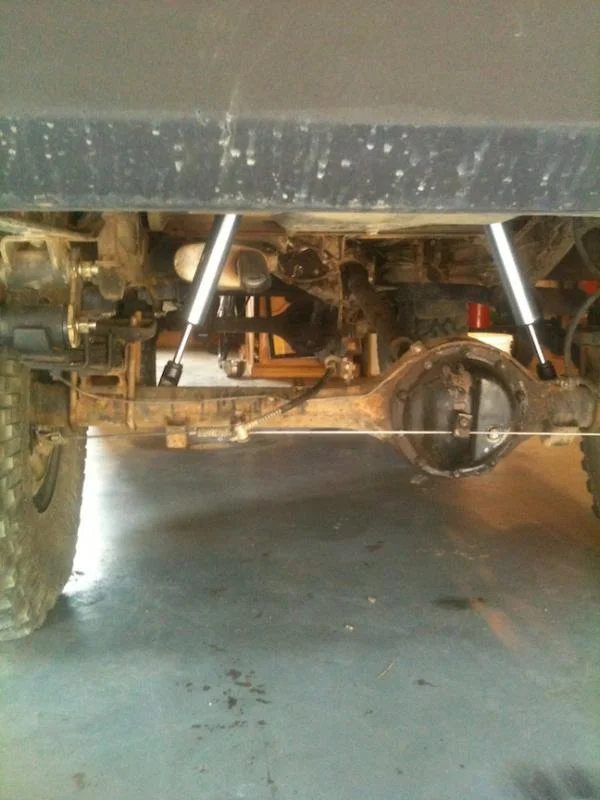

Sexy. That's the same type of rear shock setup I had, but I used Sky brackets and cheap shocks:lol:
thanks. Im going to do the fronts next, but i want to go with that setup you have or had. Didnt you have shock hoops? like the ones marlin or ruffstuff make. if so, how did you do the drivers side with the steering box in the way? ill be searchin'

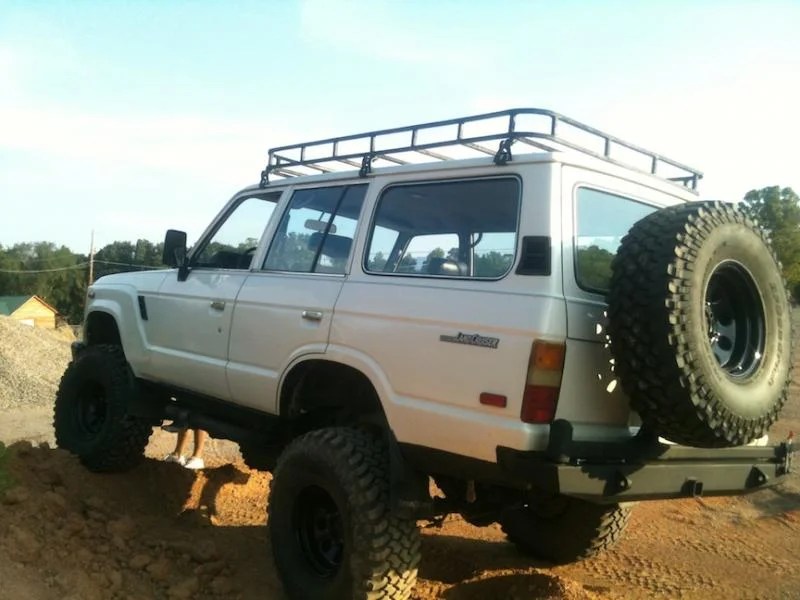

great lookin 60 man you do good work. just keep at it. really like the rear bumper, might steal the idea from ya haha. :cheers:
