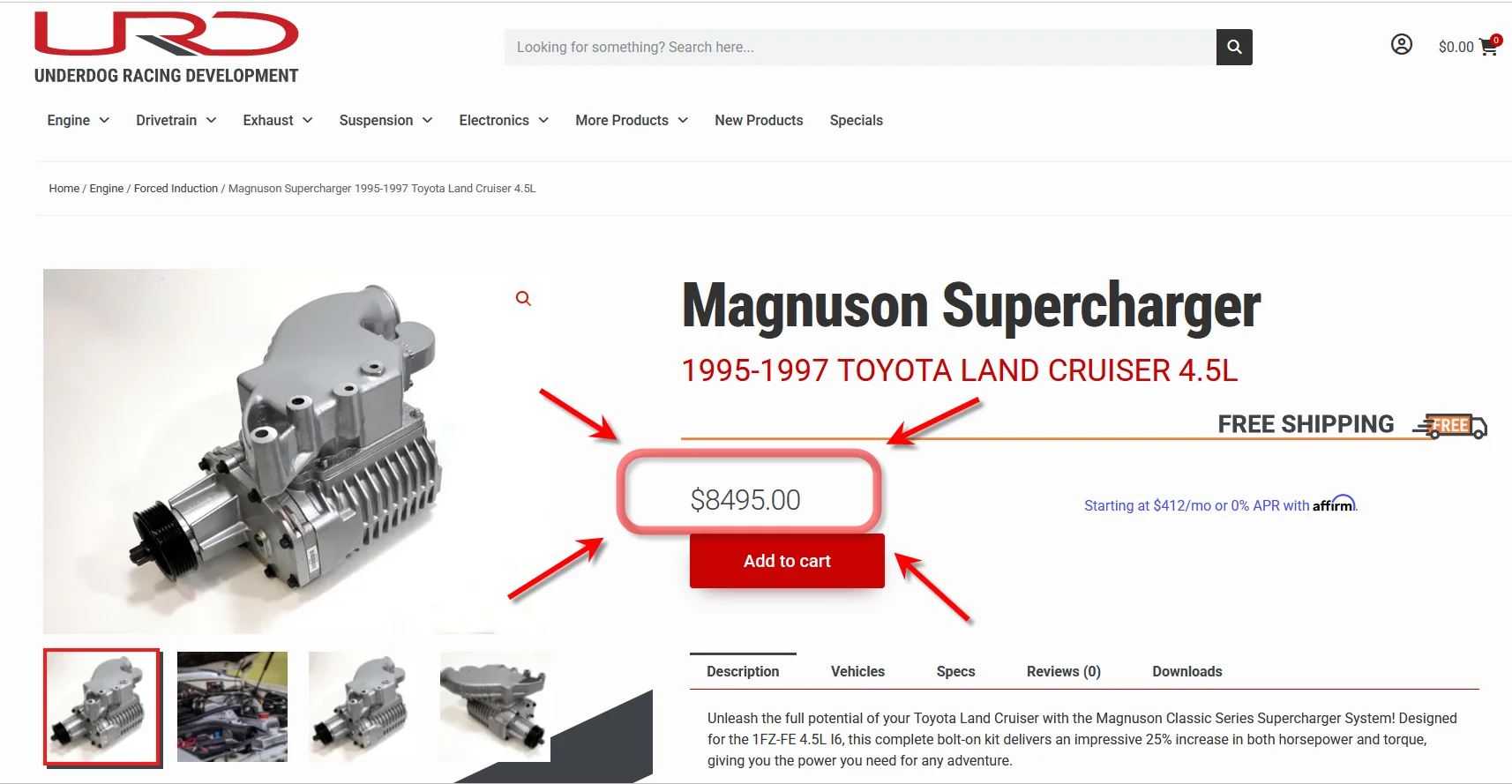

Holy investment, Batman!
That's a lot of beer!
