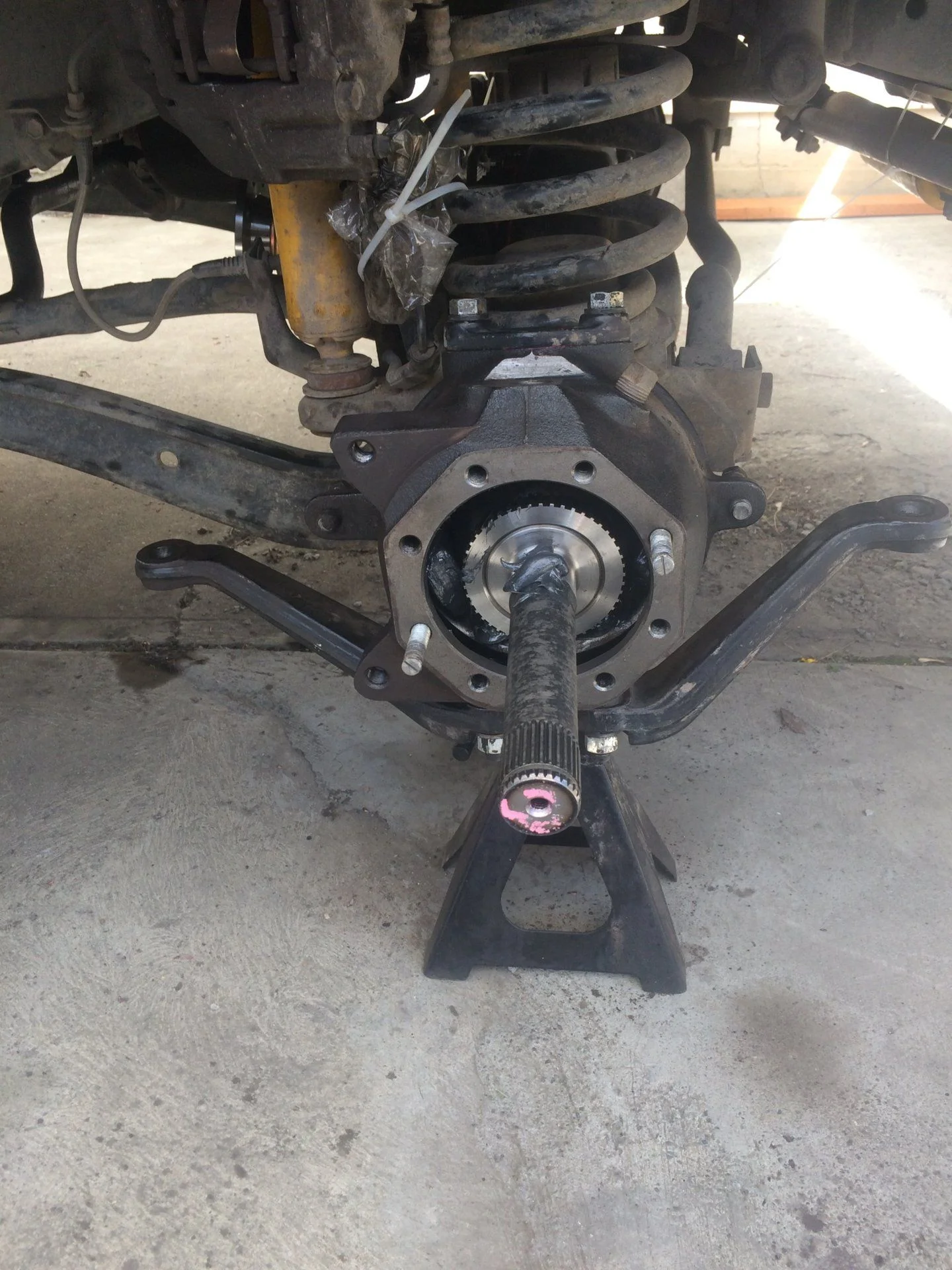

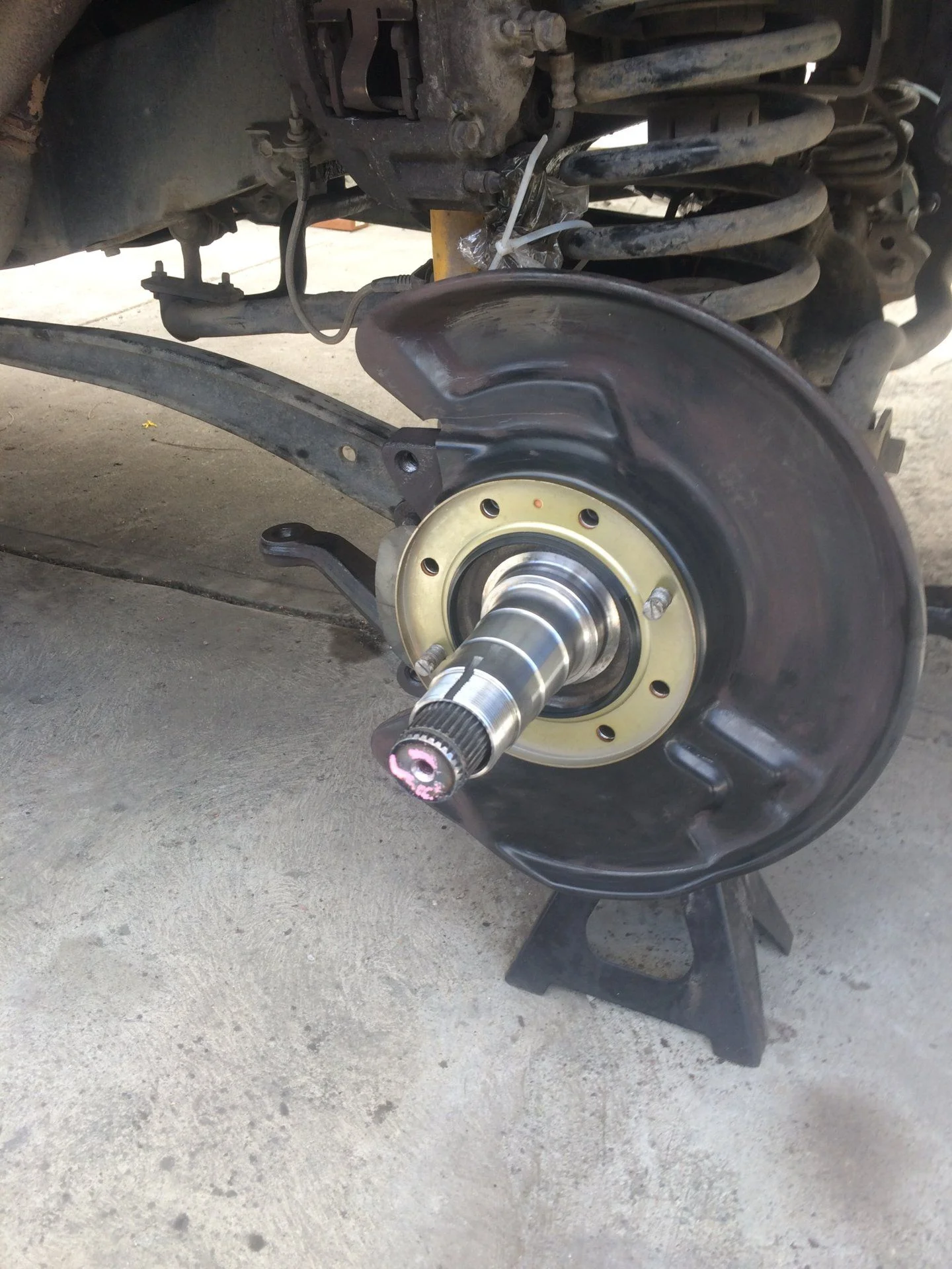

Oh, the use of headless bolts for installing the front spindles was such a good idea to make an awkward step as easy as possible.

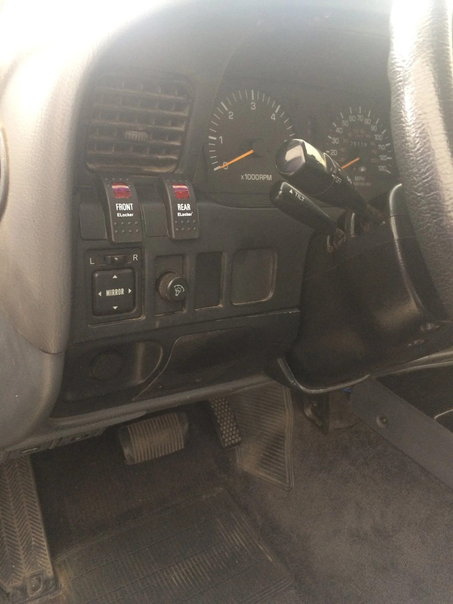

Well, the axles are back together and took it out for a short test drive. Seems to be solid and I notice that rpm's are different on the highway with the 5.29s & my 315/75-16 tires. A quick observation revealed at 70 mph on speedometer was actually 59 -60 on my GPS or about 2500 rpm. Will be taking longer and more involved test drives in the future. But for now, it's on to wiring up the Harrop e-lockers. Did some investigation & scouting already for switch placement & use of existing dash lights & figures. I will fix my burnt out OD light while in the instrument cluster. I plan on using the e-locker dash light figures as well as the LEDs on the Harrop switches. We'll see how that goes.

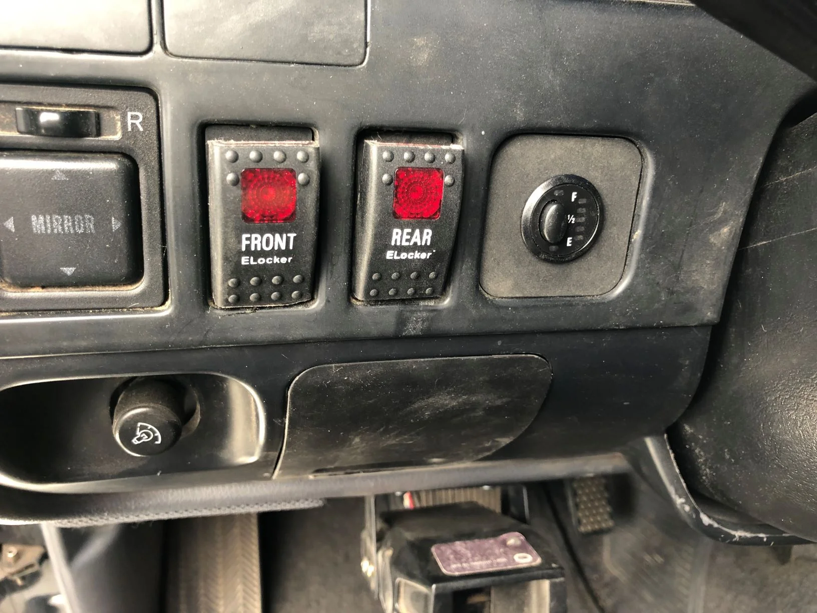

I found a place for the switches. Works quite well, actually. My attempt to utilize the locker lights in the instrument panel will have to wait until I order DPDT switches. I was dissapointed to find no bulbs in the panel in those positions. I need to get bulb holders as well. I can't use the switches Harrop provided since they are SPDT. But the switches work fine normally. Mr. T has the circuits for their locker lights to be 12v constantly (with ignition on) from the locker ECU and when I thought I could just run them in parallel with the leds in the Harrop switches, they functioned just opposite of what they should (on all the time until you flip the locker switch, then they're off...lol). The multi-meter doesn't lie - when connected the light circuits read 12v when ignition is on. It'll be simple to wire them up when I get the switches since I already tapped into the light circuits and ran the wires to the Harrop switches.
One other notable revelation popped up. You can't have the Harrop provided wire loom anywhere near the exhaust from the manifold all the way past rear axle. When I say near I mean even 6 inches! The old girl is really hot blooded, I guess...lol. So I'm tearing the wiring I carefully routed out and re-locating it. The front was a delemma until I realized I could run it along the axle, similar to a brake line. The rear I'll connect from axle to frame along the driver's side upper control arm. Front I'll do similar to the diff hose. I think it would be too exposed to try running it on the LCA.

Wasn't real happy with the way the elocker switches were in my dash, so during the install of my LRA aux fuel tank which required a switch/gauge in the dash, I did some re-locating and from @Mike Knorr , got some blanks and a mirror switch, because I ruined the original trying to trim it down to clear a Harrop switch mounted above it:bang:. Had to trim the tops and bottoms of the rockers to clear the dash since they're recessed.
How it looks now:
You can see the dash light dimmer switch relocation spot and the trailer brake controller under the fuse panel.
