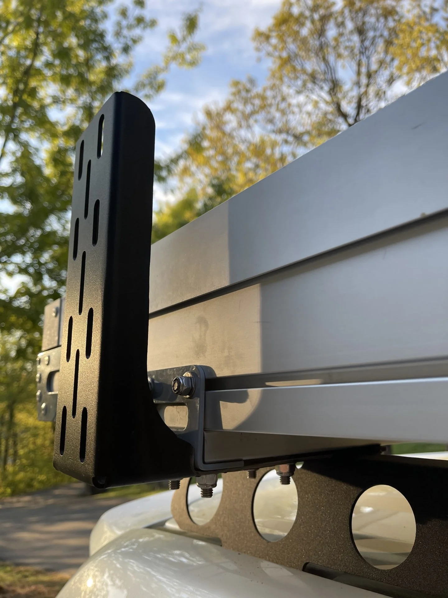

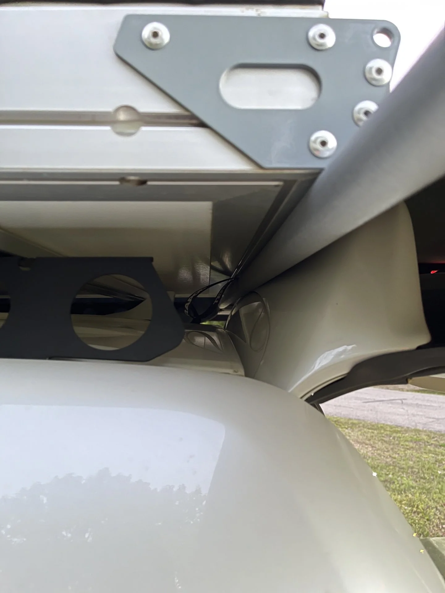

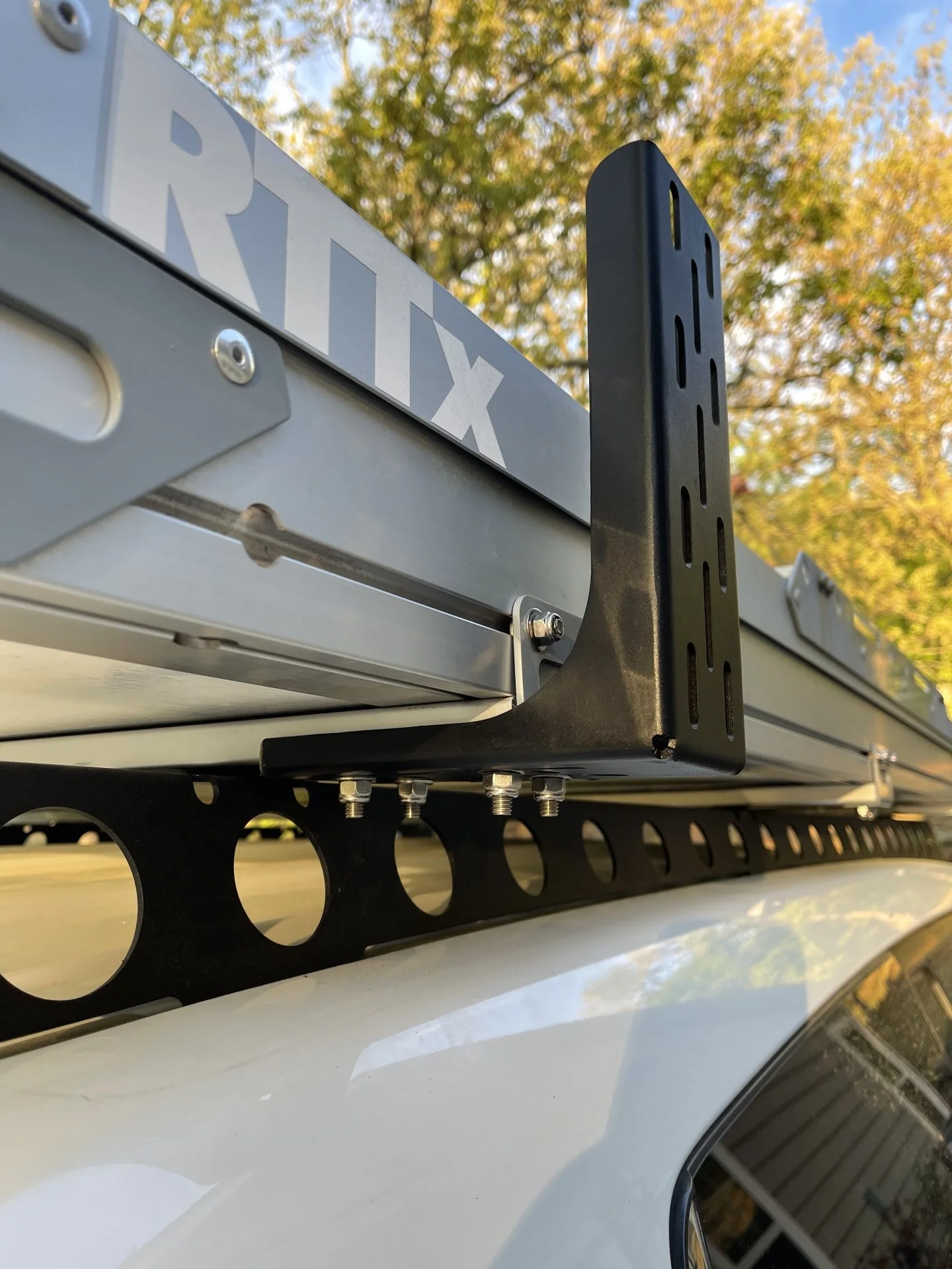

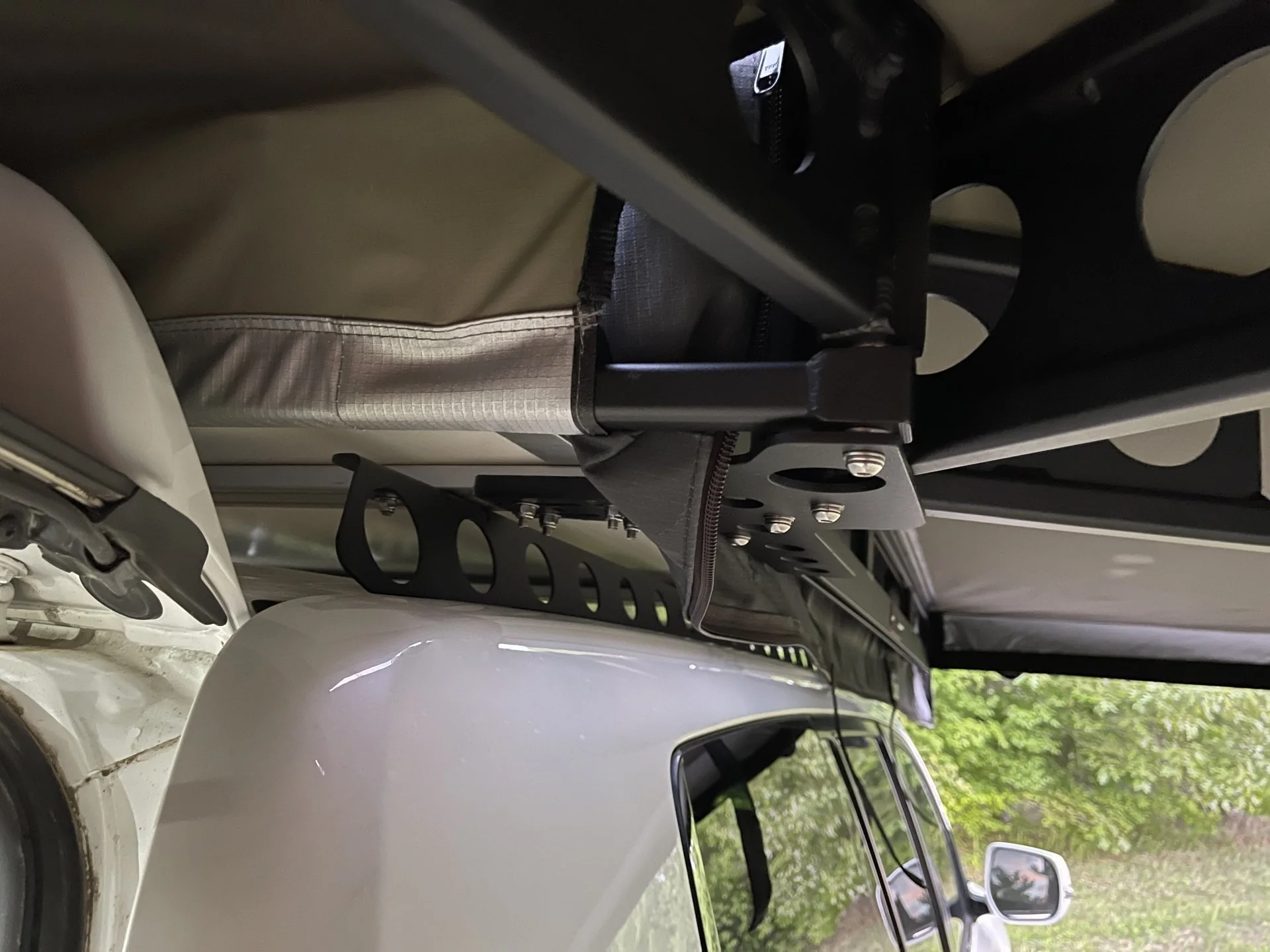

I had to do some hacking. Here is a picture of the bracket after I modified to fit Terrapod rails.
Also, if you mount as low as possible the lowest rail will swing under the bottom rear of the tent allowing the lift gate to go up high enough. Otherwise you will need to move the tent forward and the awning back. The pictures above show the rail under the back. This also gives you a little horizontal support.
Hope this helps.
Also, if you mount as low as possible the lowest rail will swing under the bottom rear of the tend allowing the lift gate to go up high enough. Otherwise you will need to move the tent forward an the awning back. The pictures above show the rail under the back. This also gives you a little horizontal support.
Hope this helps.
Thanks, this helps a ton! Did you trim one side of the brackets? Looks like onside had the fold cut/trimmed off. Also is this the heavy duty bracket from The Bush Company?
Yes. I trimmed one side. The bracket was the same width as the Terrapod rail, so I didn't have much choice. Ideally, you would want a custom bracket that would fit the rail better. Eventually I will work on a better solution. The brackets were actually in the box with the awning. I expected I would have to either fab my own or buy aftermarket mounts. The website doesn't mention standard brackets, but somehow I got them. In fact, I would like to get one more and have three supports. Two is petty solid, but I would feel better with three.

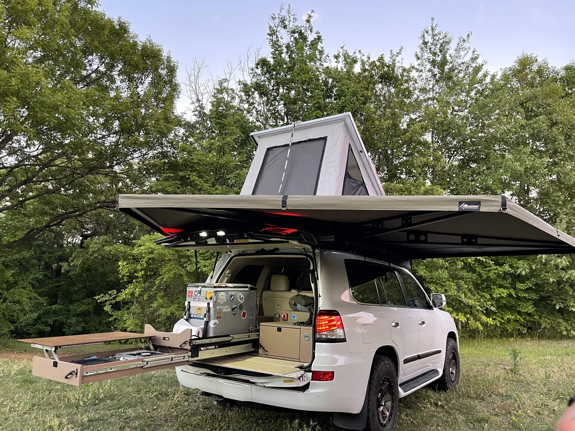

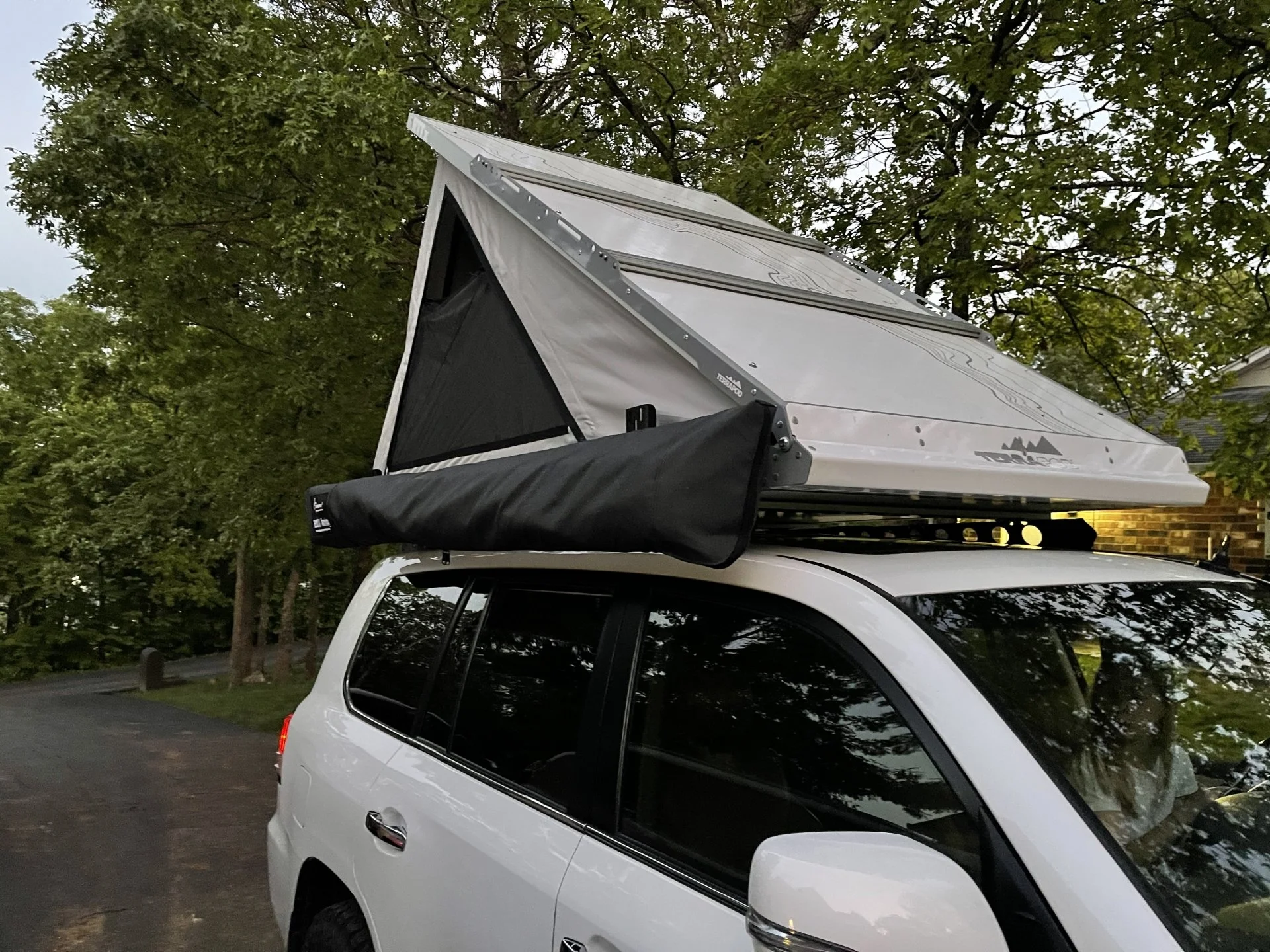

Is that the 270 or 270 XT? Do you feel it's fairly sturdy supporting the weight? I believe the bush company awnings are 65+ lbs. but I supposed its better to mount from rails vs. to the side of the RTT.
R270 XT (Not the MAX). I'm 6'1 225, I can almost hang all my weight on a single bracket. It's the rails under the tent that flex not the brackets.
From what you have done with the brackets and adding a 3rd support bracket you see any issues with the MAX being installed on the backbone and terrapod supports? Also what decision factors had you select passenger side vs. drivers side?
With a third bracket, I'm sure you would be fine. It's another 15 lbs I think. I went passenger side for a few reasons...
1) Wind noise/access. I don't want that right by my head while I drive and I don't want to deal with it getting in and out of the vehicle.
2) Coverage - Covers my cooking/work area better with my drawer configuration.
3) Passenger rear covered access - I plan on partial rear seat delete (200 series rear is a 70/30 config) I'll be removing the passenger rear eventually for dry storage.
4) Merica - All the RHD folks mount on left, I assume we should be on right using that standard. So sayith all the youtubers, but I don't put much weight in YouTube opinions.
