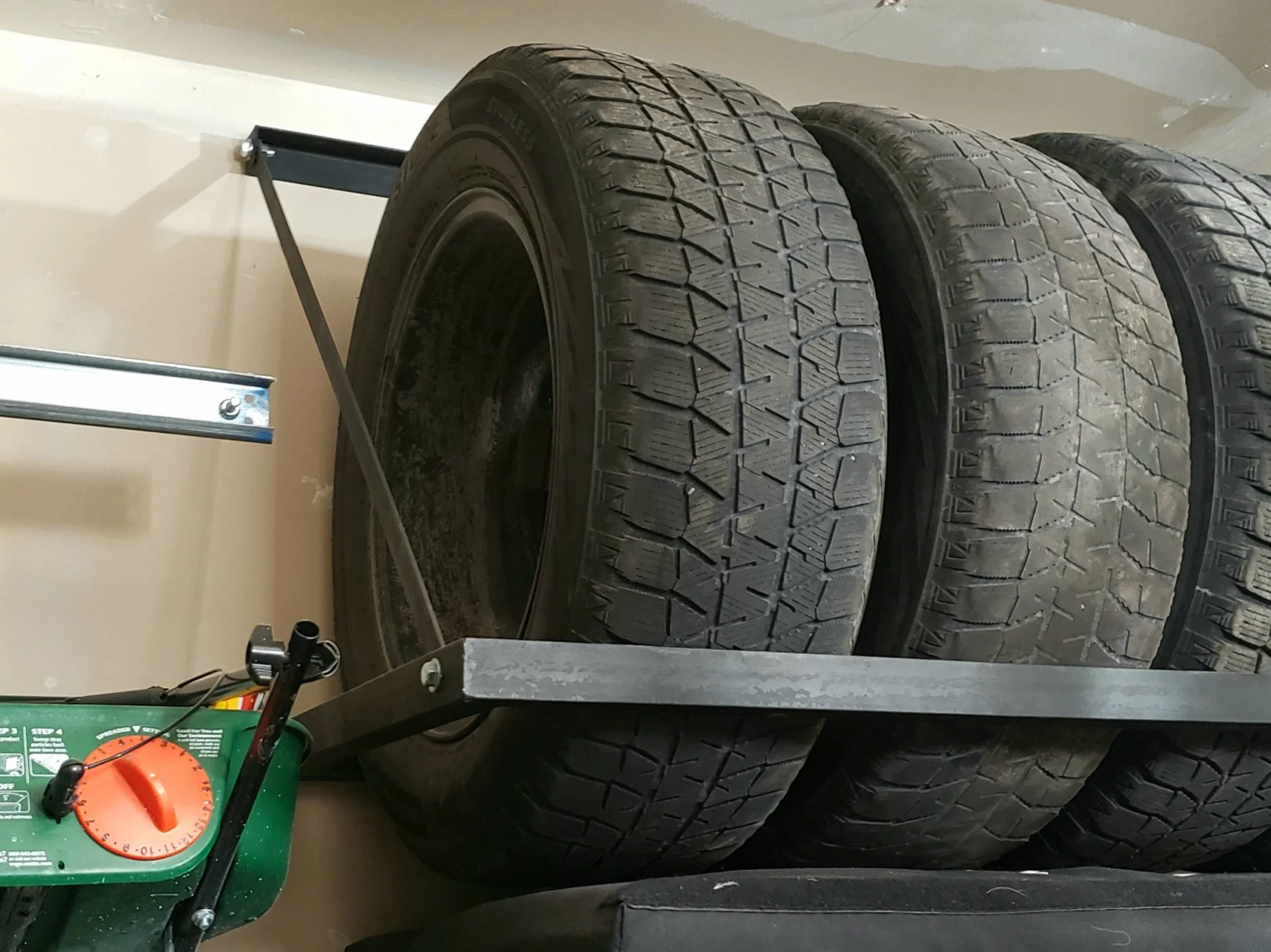

I don't have any pictures handy, but I just built some rectangular frames from 1" angle iron, screwed them into studs, and added 45 degree braces on the top (also screwed to studs). I have them mounted as high up on my garage wall as possible.
Not a great photo, but you can mostly see what I did.
That’s the best way to get them off the floor. Better yet if you have garage attic access. A rope and pulley in the attic can help the awkwardness of getting them up there.
