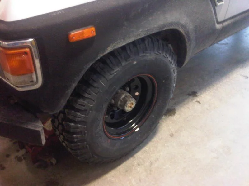

rhah said:Maxxis bighorn 255/85/r16 on marsh racing wheels 16x8 with 4.5inch back spacing. . . Would love to post pics but from phone not working right now
I.went onto their site and that looks like a great way to go. 16x7" in any backspacing for 99$. I wish they came in chrome but they don't look bad as is. Please share pics when you can.

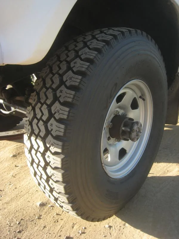

Try Kenda Klever MT they have a great look. About $156 each with FF on Ebay. I have them on my Landrover and plan to put them on my FJ-40.Me too!
But gosh they are hard to find.![]()
