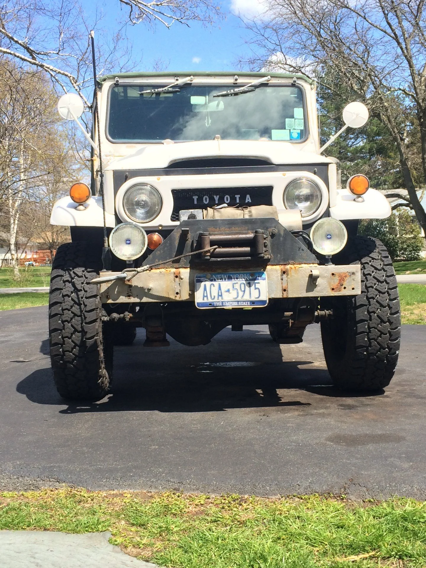

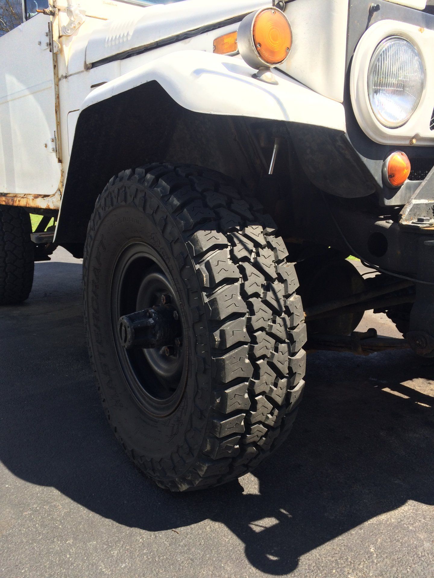

I have been running the 255/85r16 for well over 20 yrs
Toyo M-55 were great tires
Cooper Discoverer s/t were a bit loose when loaded
Bfg mt were ok
I run mastercraft couser now and they are not bad... a lil wider than I’m used to ... most 255 run 10” about... these seem a tad wider but well u set the 10.5
SS are .... well ... SS’s :meh:
Approx:
900r16 = 36x10x16
8.25r16 = 34x9
Q78x16 35x10
P78x16 33x9.5
Just a quick run up of that size range... probably missing a few

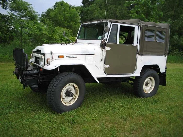

I was going skinny bc the manual steering is such a bugger. And I think they look cool skinny. I know I could fit bigger, but I didn't want to have to beef up any more components or gearing. The Track 2 rims I got are 7" wide I think, maybe 6" but I think they're 7".

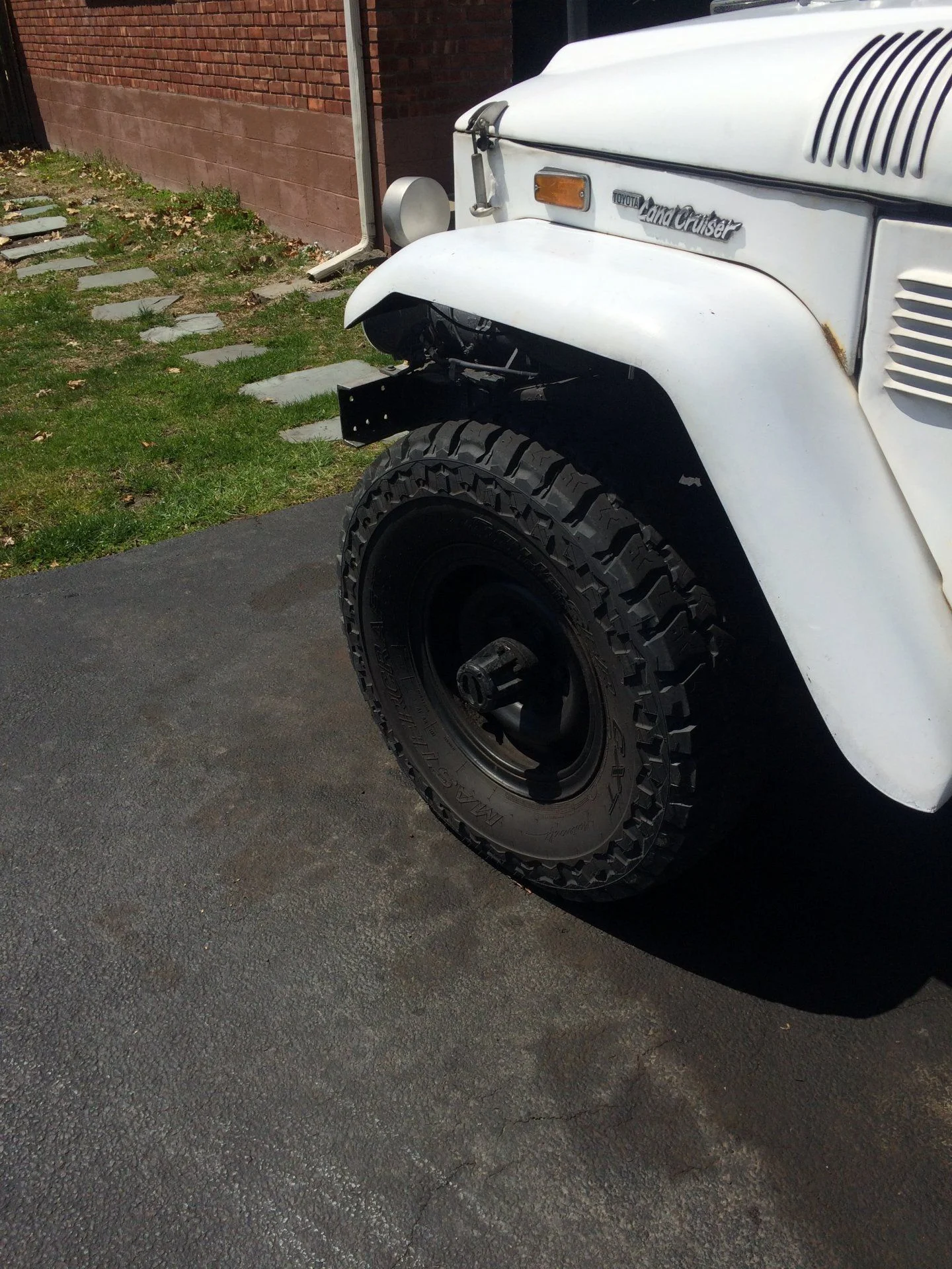

Mastercraft Courser CXT
The ply rating is higher on the mastercraft then my previous cooper s/t ... so far they work pretty well and don’t have the tires roll over around corners like the coopers
Yeah $160 a tire for the Mastercrafts vs $350 a tire for the Toyo M55s is a MAJOR difference.... I wonder if the Toyo Open Country MT is better than the Mastercrafts....??
