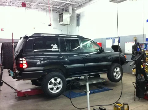

Tires are going on! $30 out the door.
Went with new on front. 2/32 really is an insignificant amount of tread.
