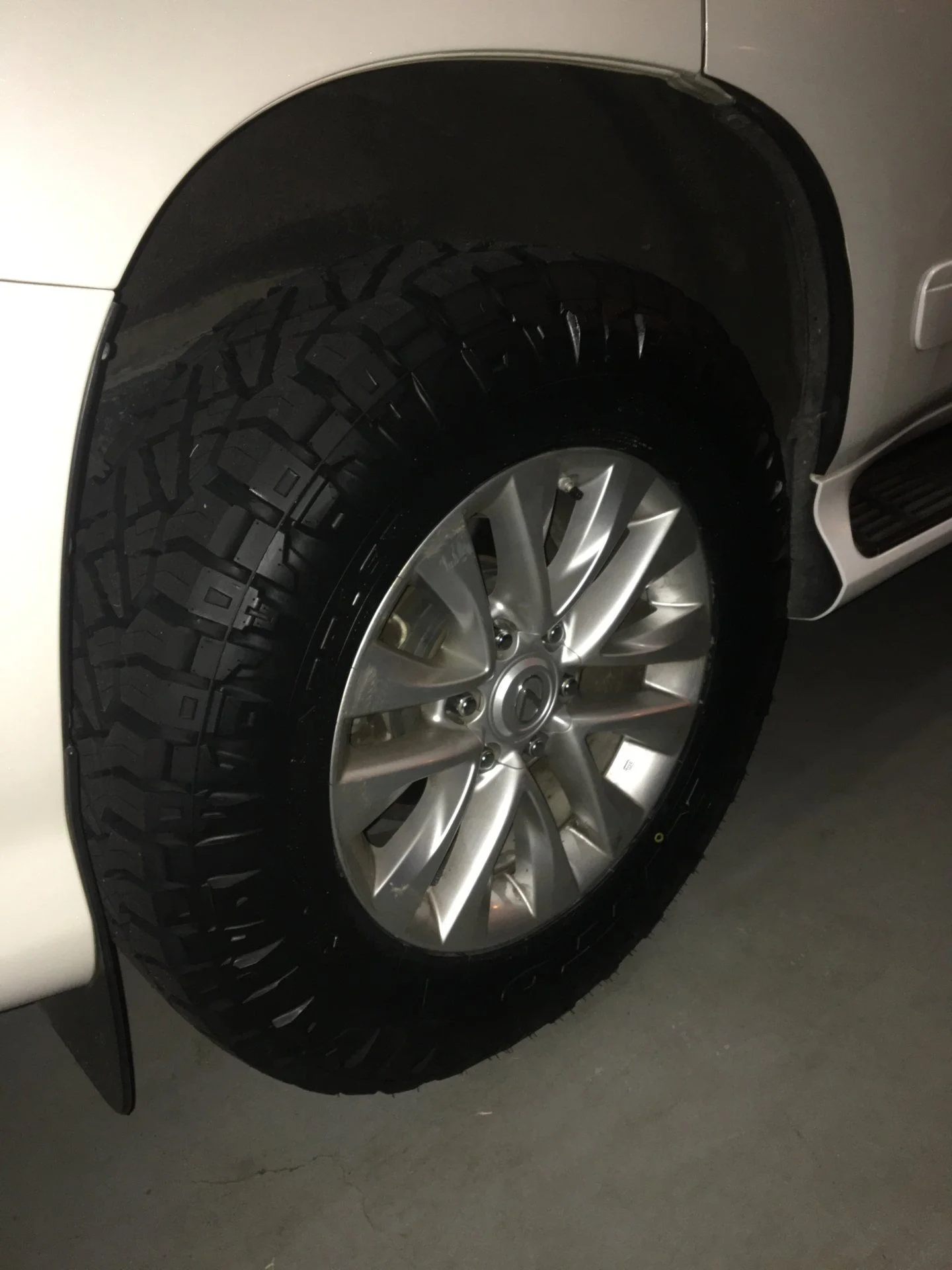

So we got the tires today. They fit perfectly with no rubbing issues at all so far.
