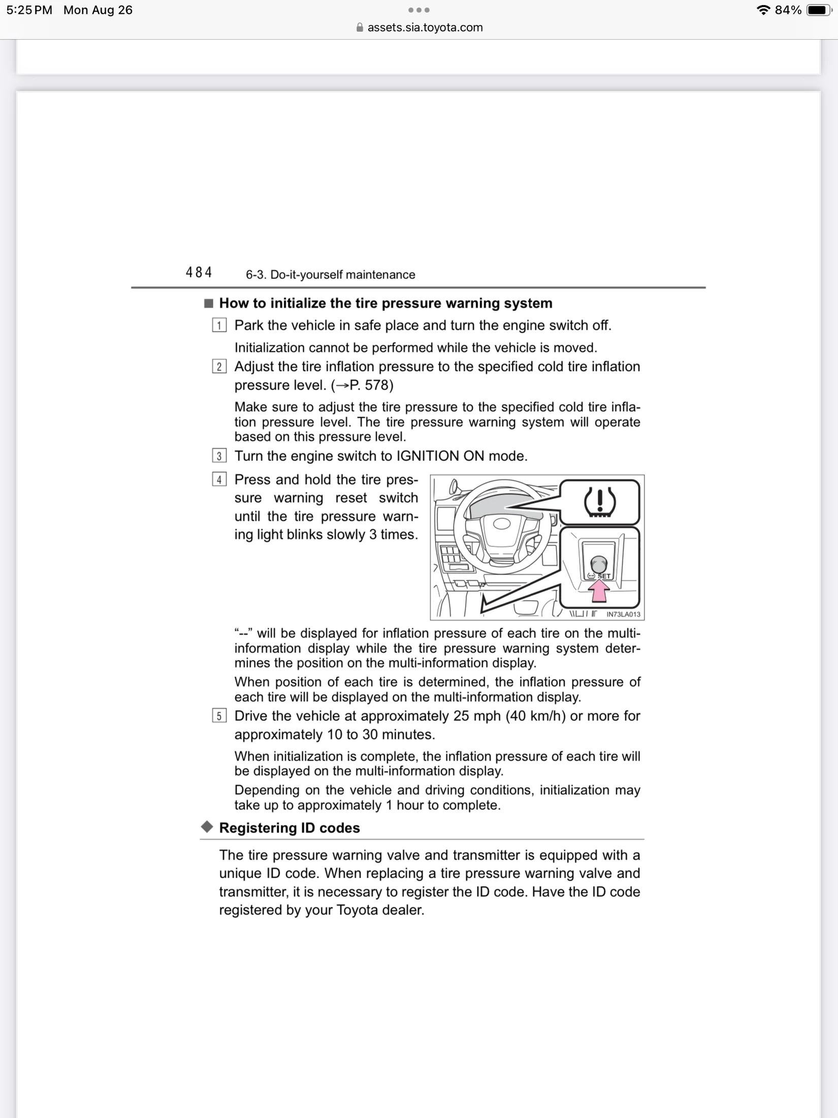

I recently filled my tires with air while the car was off from 30psi to 33psi. Turn the car on to drive and the TPMS is not reading any of the tire pressures. The light is not on. I tried resetting the TPMS with the button underneath the driver's side and it still won't read it after multiple drives. Strange how this happened right after filling the tires. Any thoughts?

That's an interesting point. I used a compressor to inflate. Then went for a drive and noticed pressures weren't being read. I tried multiple times to reset the TPMS both with the engine running and with it off (Start/Stop pressed twice without foot on the brake).

You probably need to drive quite some time like 15 to 30 min
So I would give it some time to show up and not worry about it.
If you reset the TPMS you will need to drive the truck at higher speeds for over 30 min I believe. Process and duration is in the owners manual. Mine took a little over 30 min. May take up to 1 hour to reset

Sounds like I need to: deflate to zero and back to desired pressure, hold TPMS button to reset, then drive highway for 30+ minutes?
