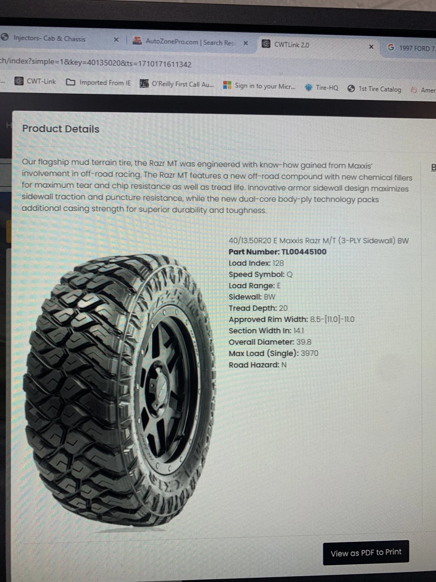

I saw a huge AEV Prospector XL with a big camper bed setup in person...they run 41" Interco Irok's. Big ass truck, big ass motor, all decked out with winch, bumpers, etc...the owner said the tires were great.
41x14.5x17 are rated for 3850 lbs
Toyo MT 40x15.5r20 is rated at 4190.
Nitto trail in the same size is rated 3970.
Options for all terrains that size are pretty slim and you might need to look at 20” wheels, but there are options out there.
