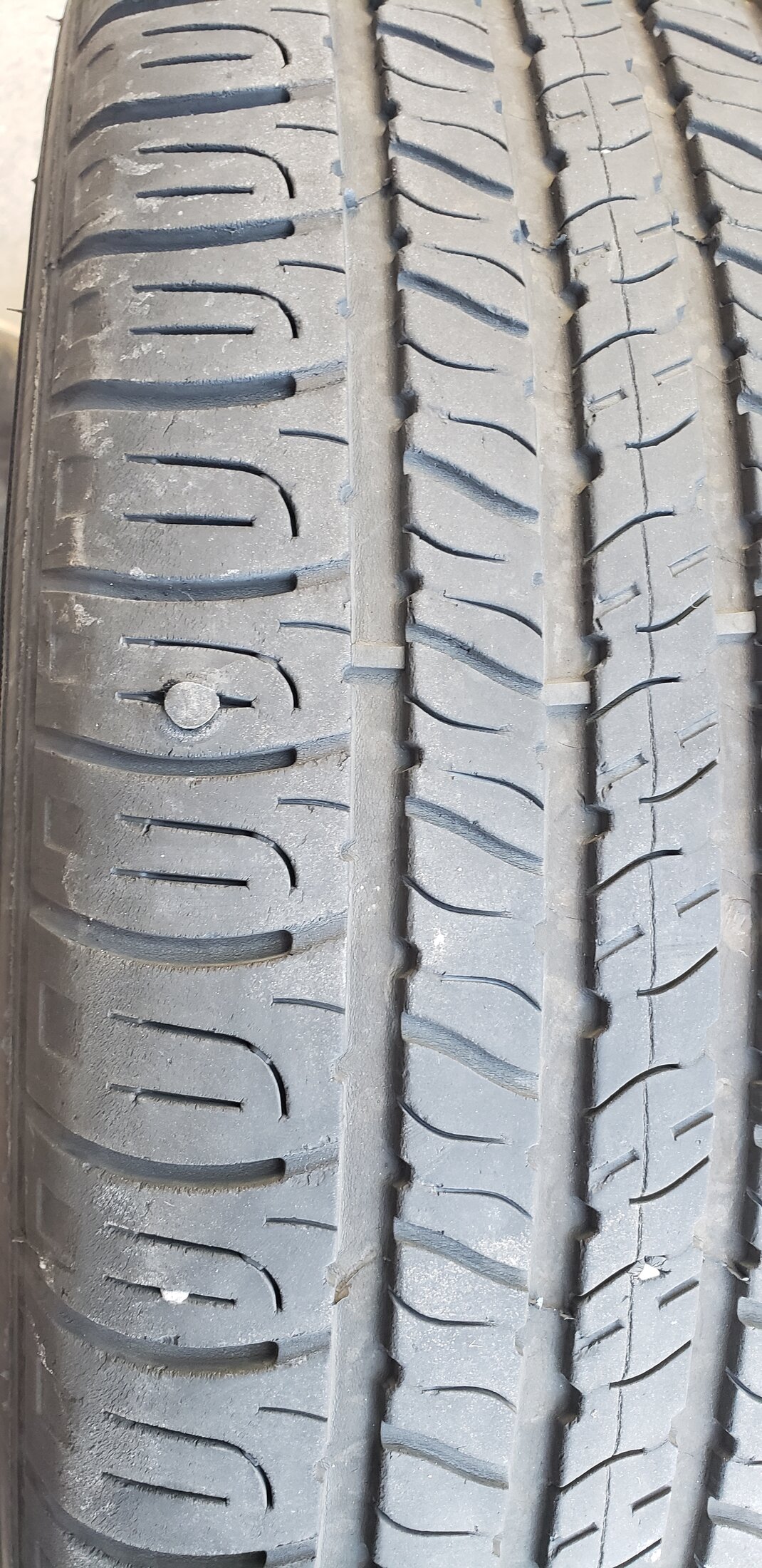

Since when are they plugging tires at Discount tire? Last I knew they patched them... Any ideas?
That's more than likely a plug/patch. A patch, with a plug to fill the void in the tread and keep debris and water away from the patch.
Patch plug
Patch plug
Thats what they did with one of my 35's on the FJ40 - plugged & patched a large screw hole on the center of the tread. I was skeptical but was leaving for Moab the next day. Lasted four years and counting so far - so it worked out ok for me.
Surprised they repaired that at all being so close to the sidewall. I’m guessing if that wasn’t under warranty it would have been unrepairable.
