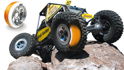

Staun beadlocks..
I read up on those staun bead locks. Really cool, but big bucks.
