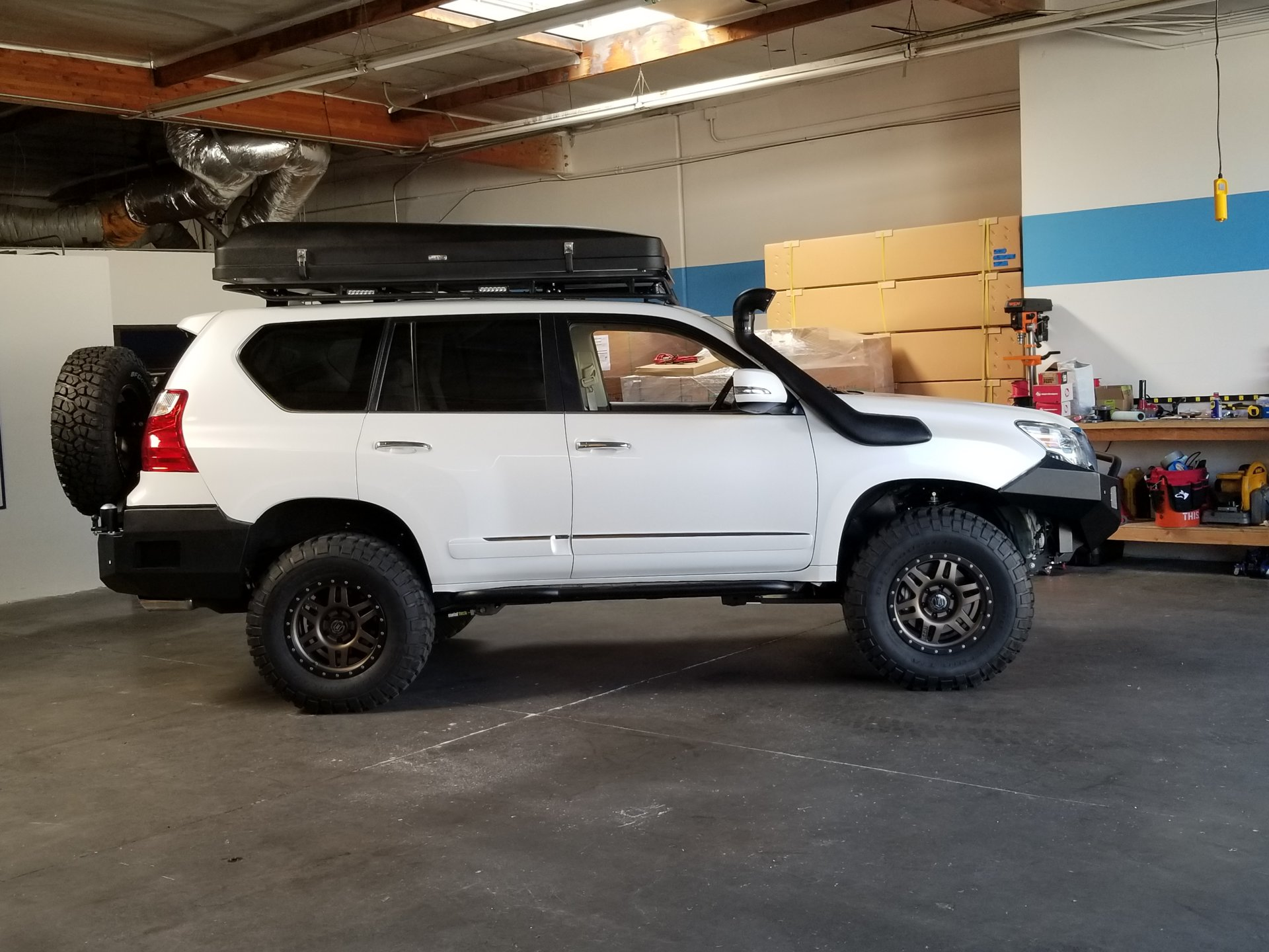

These are what I went with and I fit any almost any size tire. I started out with a 275/85R17 BFG M/T's and currently run 315/70R17 BFG A/T's. That would be about largest you'd be able to fit, so I'm sure you should have no issues with anything smaller.
ICON Six Speed 17" x 8.50" Wheel - Bronze, Product Line: Six Speed (qty: 5) ICON-1417858347BR
  • Six Speed
  • Specification
  • Color/Finish: Bronze
  • Material: Aluminum Alloy
  • Wheel Diameter: 17"
  • Wheel Width: 8.50"
  • Bolt Pattern: 6 x 5.5
  • Backspace: 4.750"
  • Offset: 0 mm
  • Bore: 108 mm
  • Load Rating: 2500 lb
  • Weight: 30 lb
Here's a photo of what they look like, albeit, that's not the only style and color option. For me, I love the color and style, and yes even the imitation bead lock.

Those look good! I was looking at the Icon Rebound Pros, but I'm trying to be under 30 lbs on the wheels. Either way, being about 30 lbs isn't bad, and opens up my options quite a bit. Thanks for sharing! Your rig looks great!
