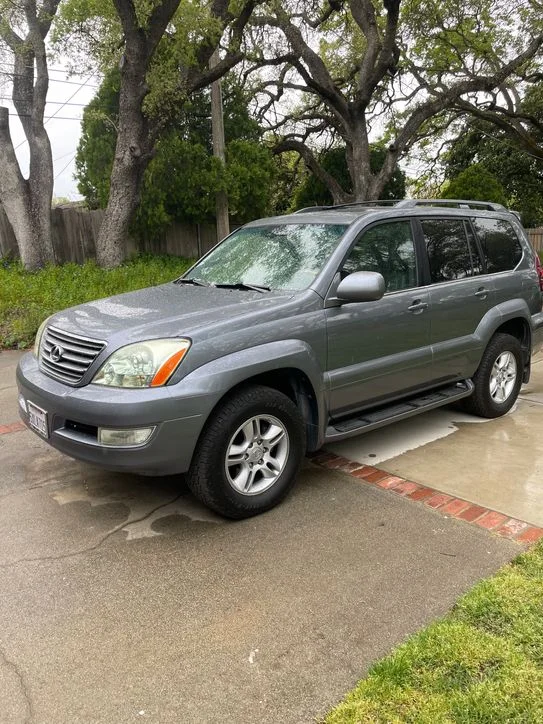

Found "Girl" in NorCal during a spring break family roadtrip to visit the Winchester Mansion. Autotrader and I had become one over the course of several months. I wanted a GX470 in the spec I found, but would settle for a decent GX460 :moon:
We drove up to Fair Oaks to check her out. The former owner was a retired teacher with grown children. Her husband has a newer Tacoma. She had a new XC60 Recharge that replaced the GX in the garage. When I asked how often they used the parking brake the husband was borderline offended and replied every time. I wanted to hug him. Left a $1k deposit to let them know I was serious. Took a one way flight up the following weekend and drove Girl to SoCal.

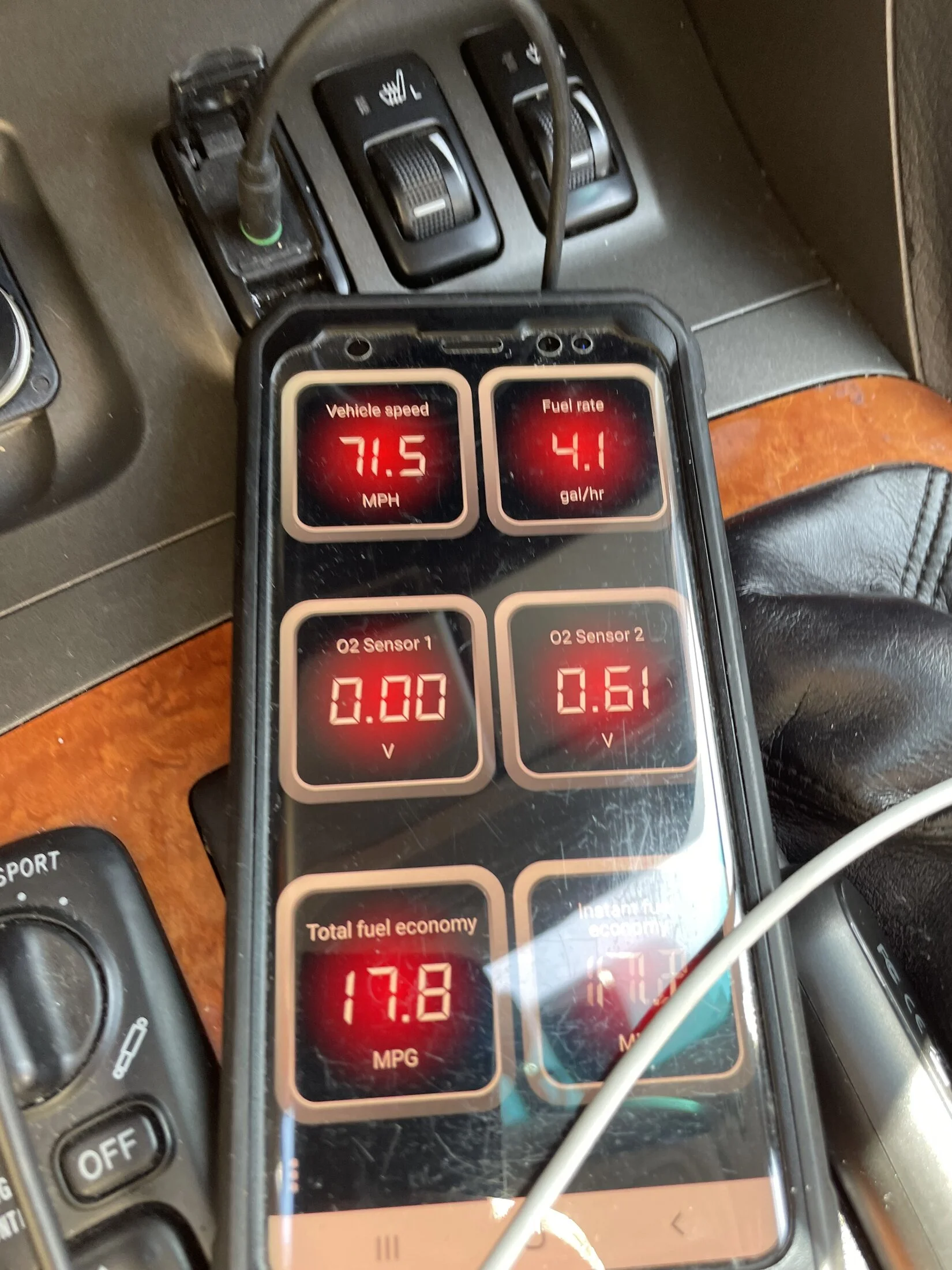

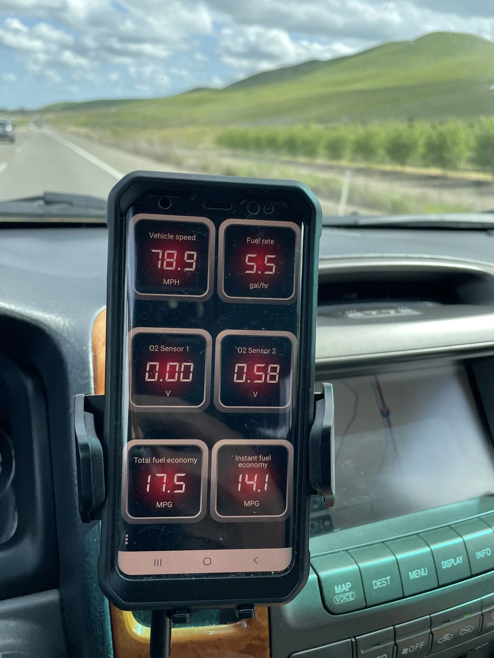

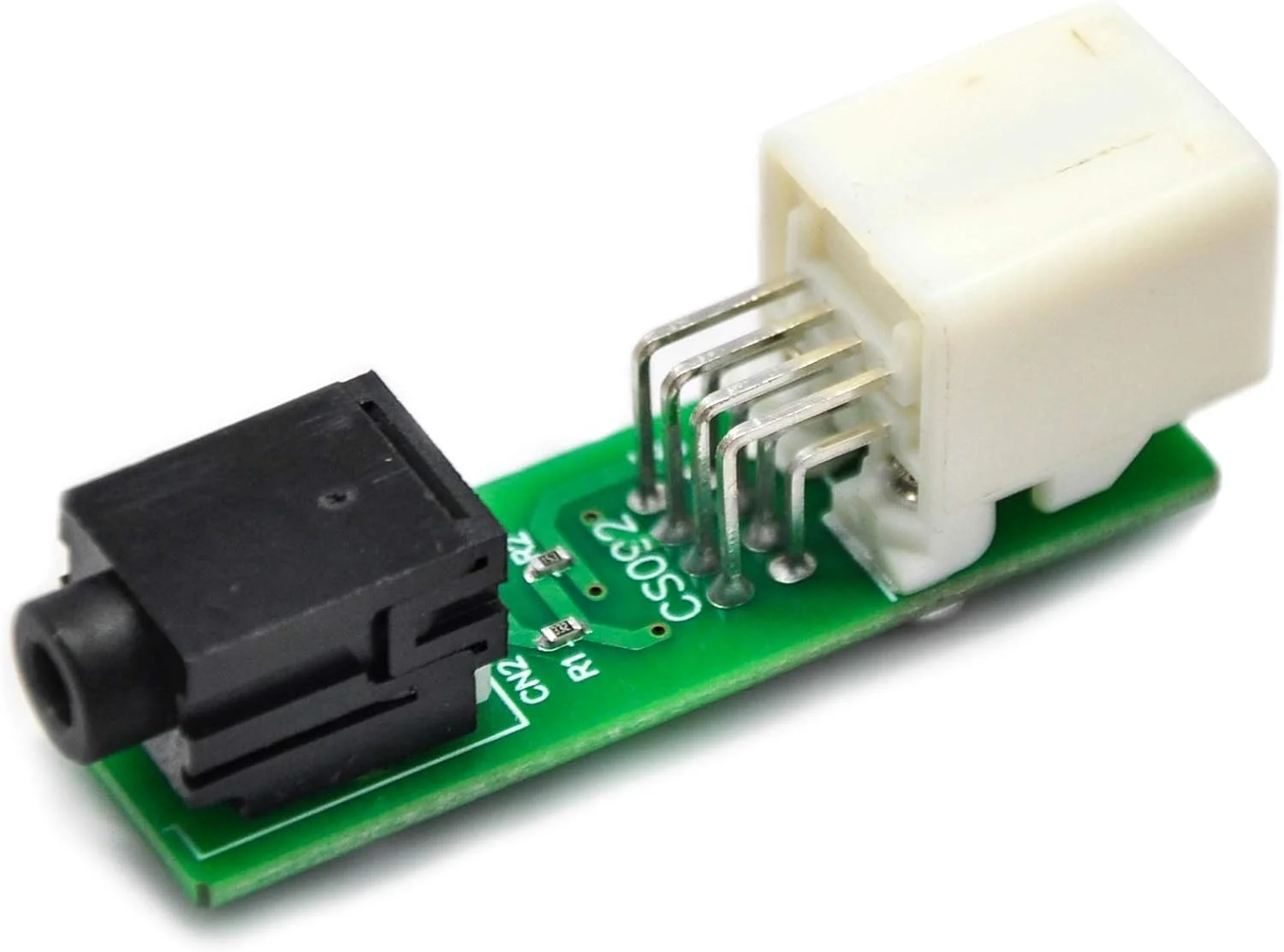

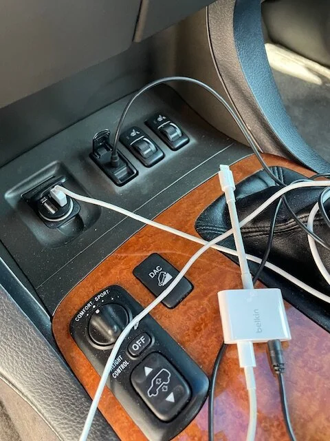

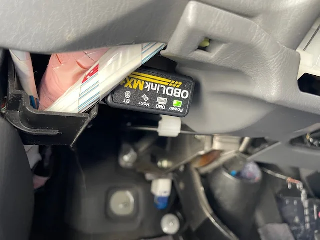

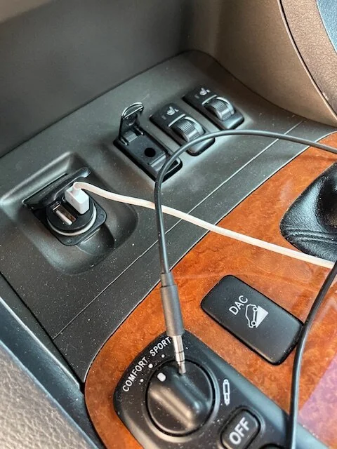

First mod was plugging in the OBDII BT adapter for the trip home. Everything looked great on the way home and gave me piece of mind. About 1 hour into the drive the AUX jack stopped working.
This was purchased for $12.99.
Aux Port Input for Toyota 86190-02010 Car Repair Parts Auxiliary Audio Adapter Aux Jack Kit Radio Replacement Part for Tundra Corolla Camry RAV4 Tacoma Highlander Venza Sienna Matrix
https://www.amazon.com/dp/B07SKGL46X?tag=ihco-20
It was a bit shorter than the original, but snapped into place after cracking open the assembly. Using an aux cable with a small boot is required.

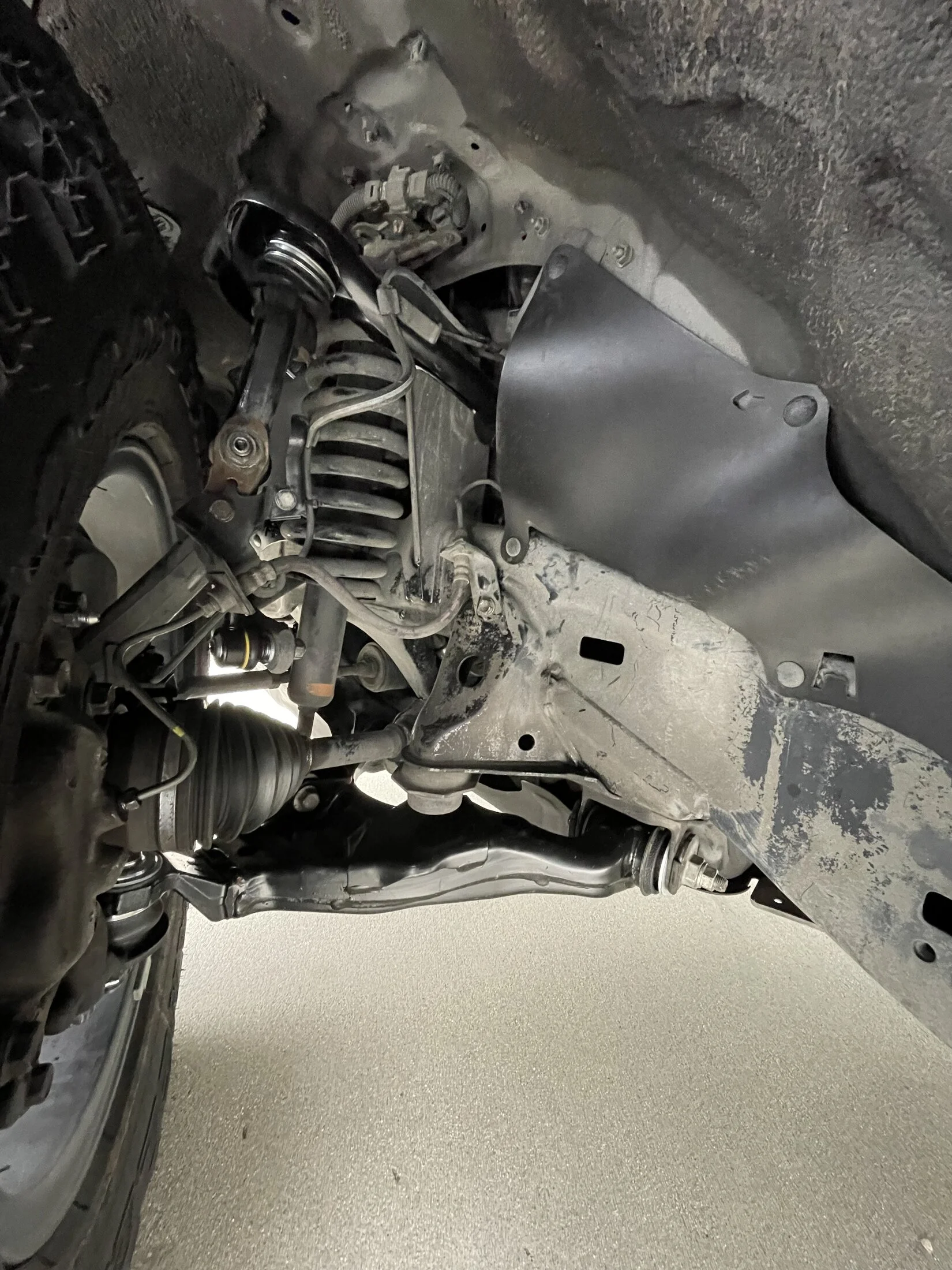

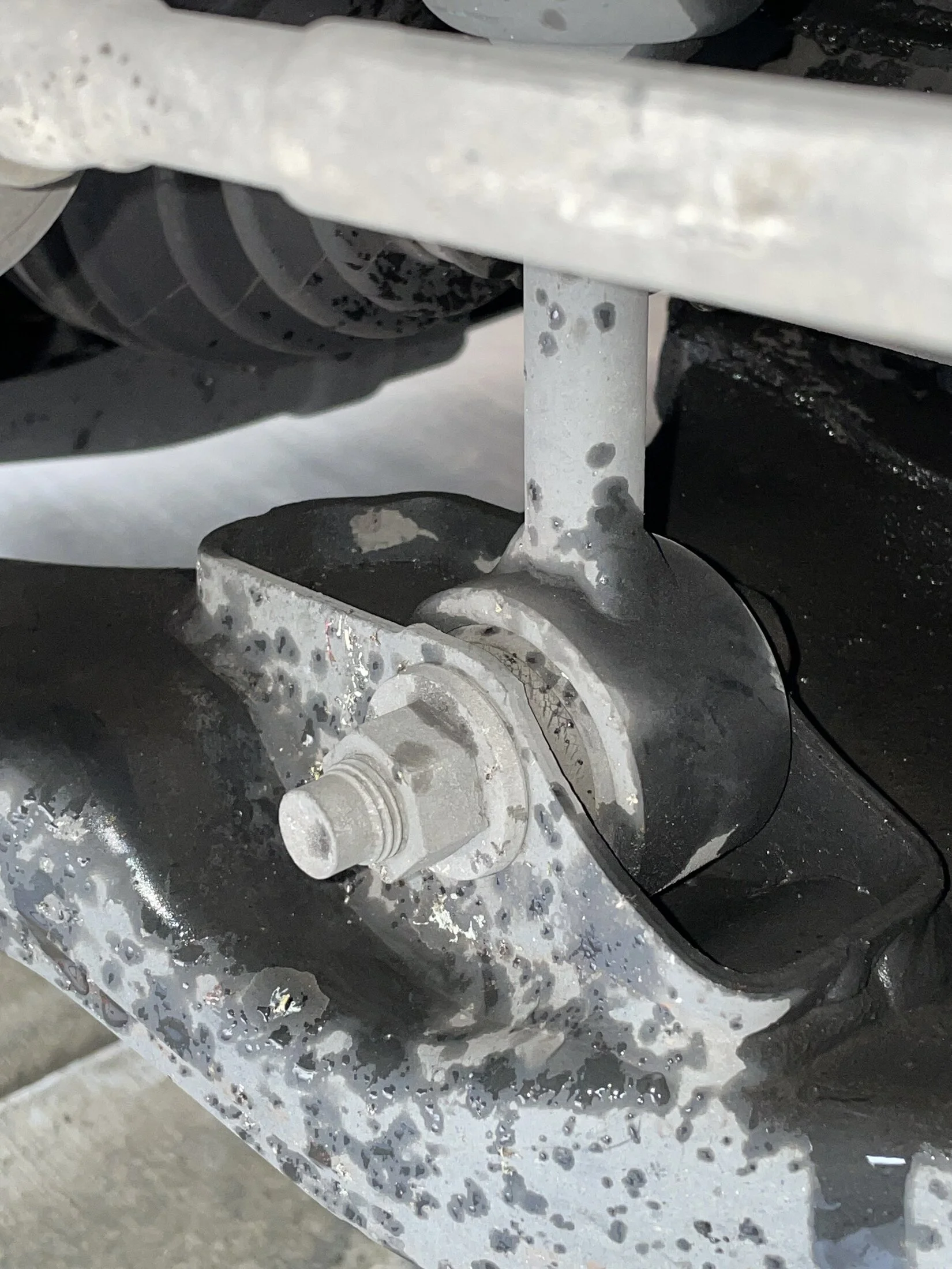

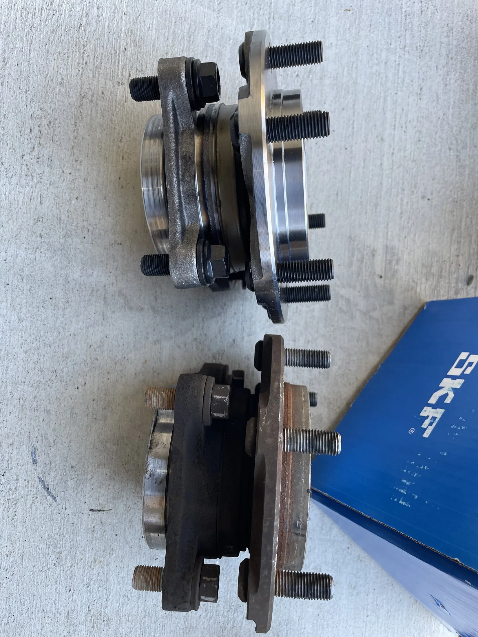

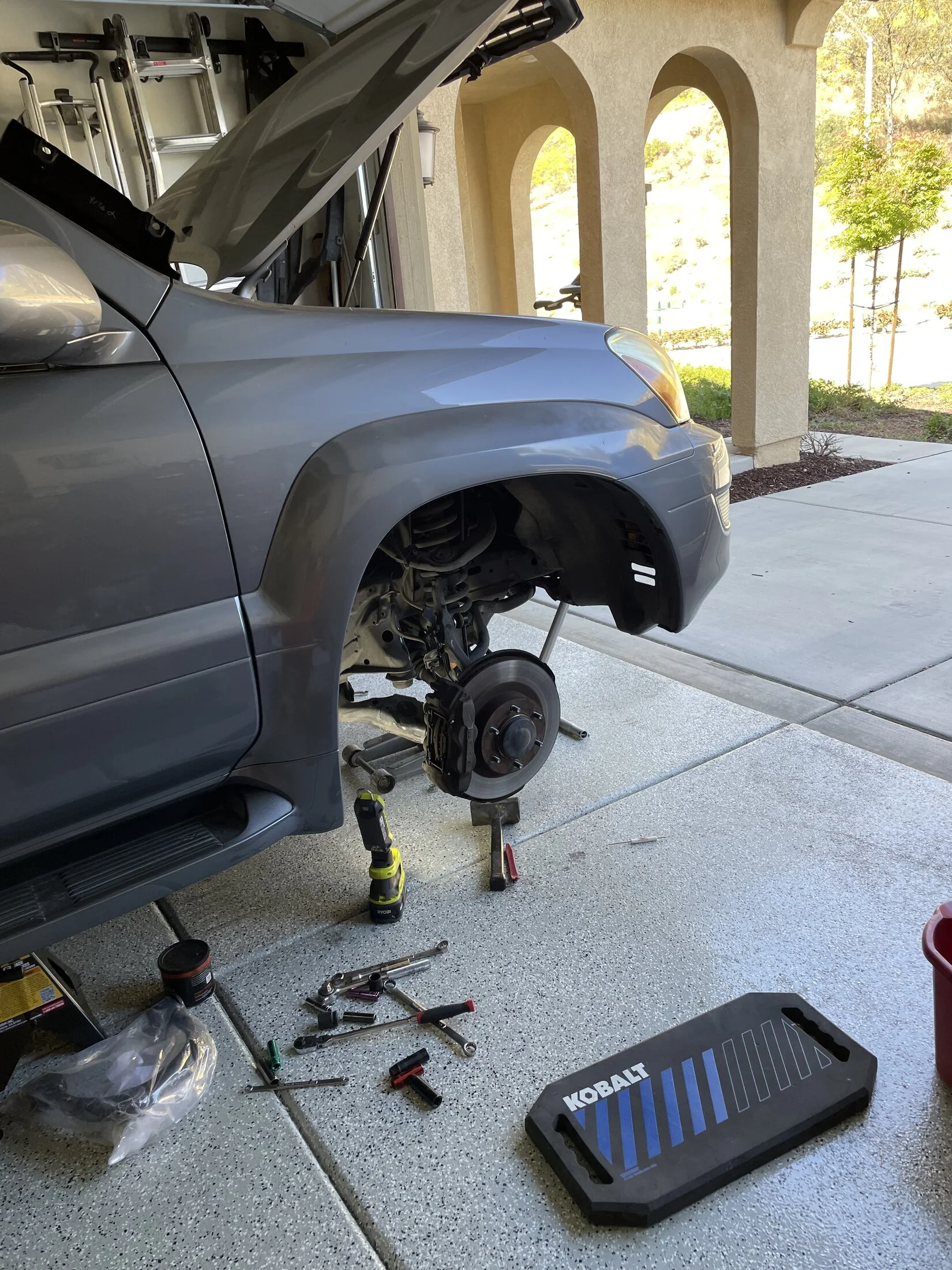

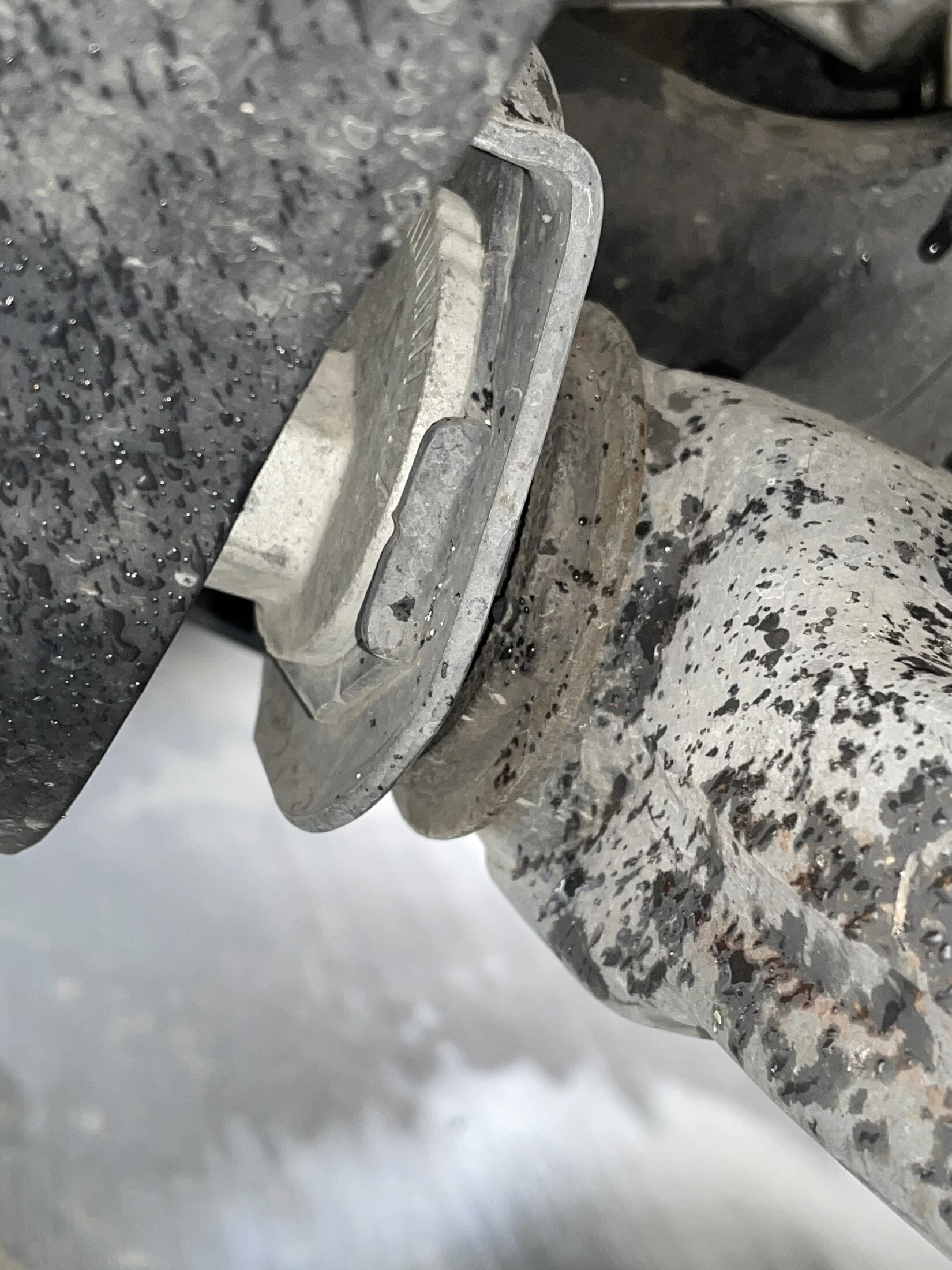

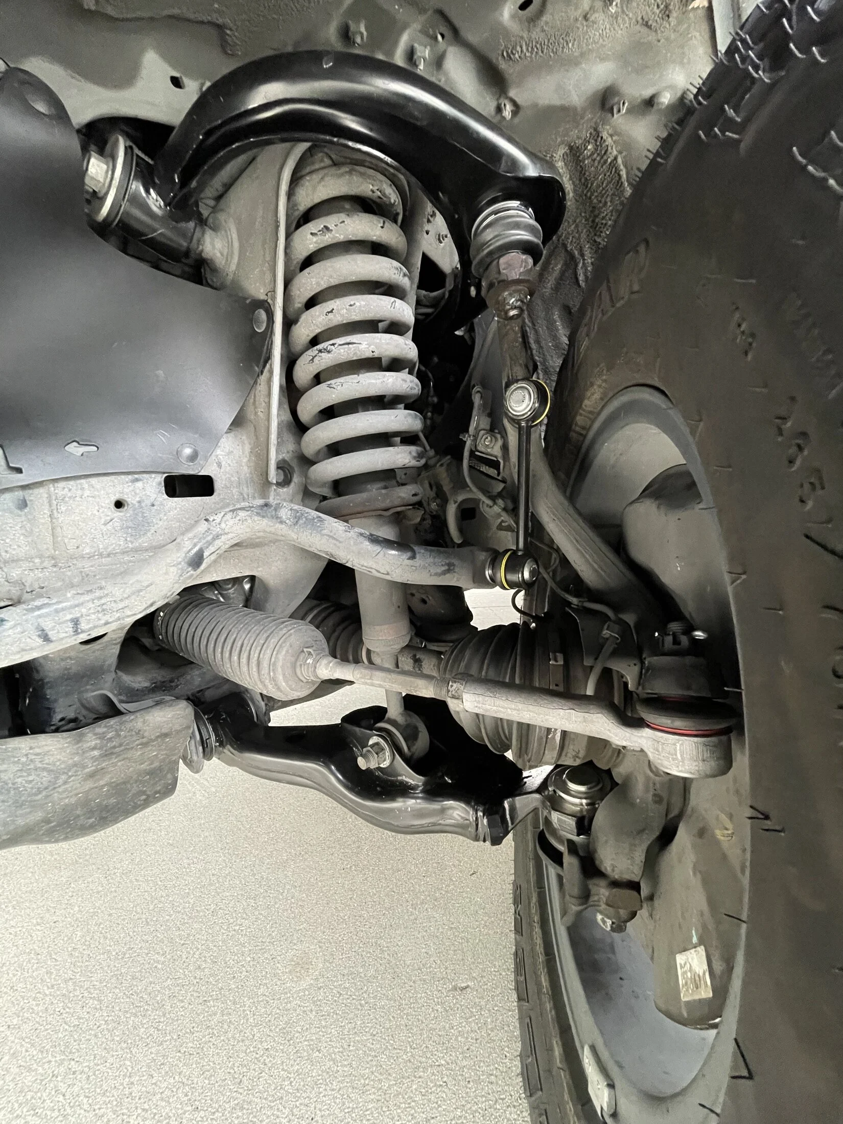

Did a suspension inspection and found all original stuff with cracked rubber bushings. Ordered and installed new Lexus front LCA & UCA. Amazon front swaybar bushings and endlinks. The front left wheel bearing had a wobble and replaced that with a stuffed SKF unit.

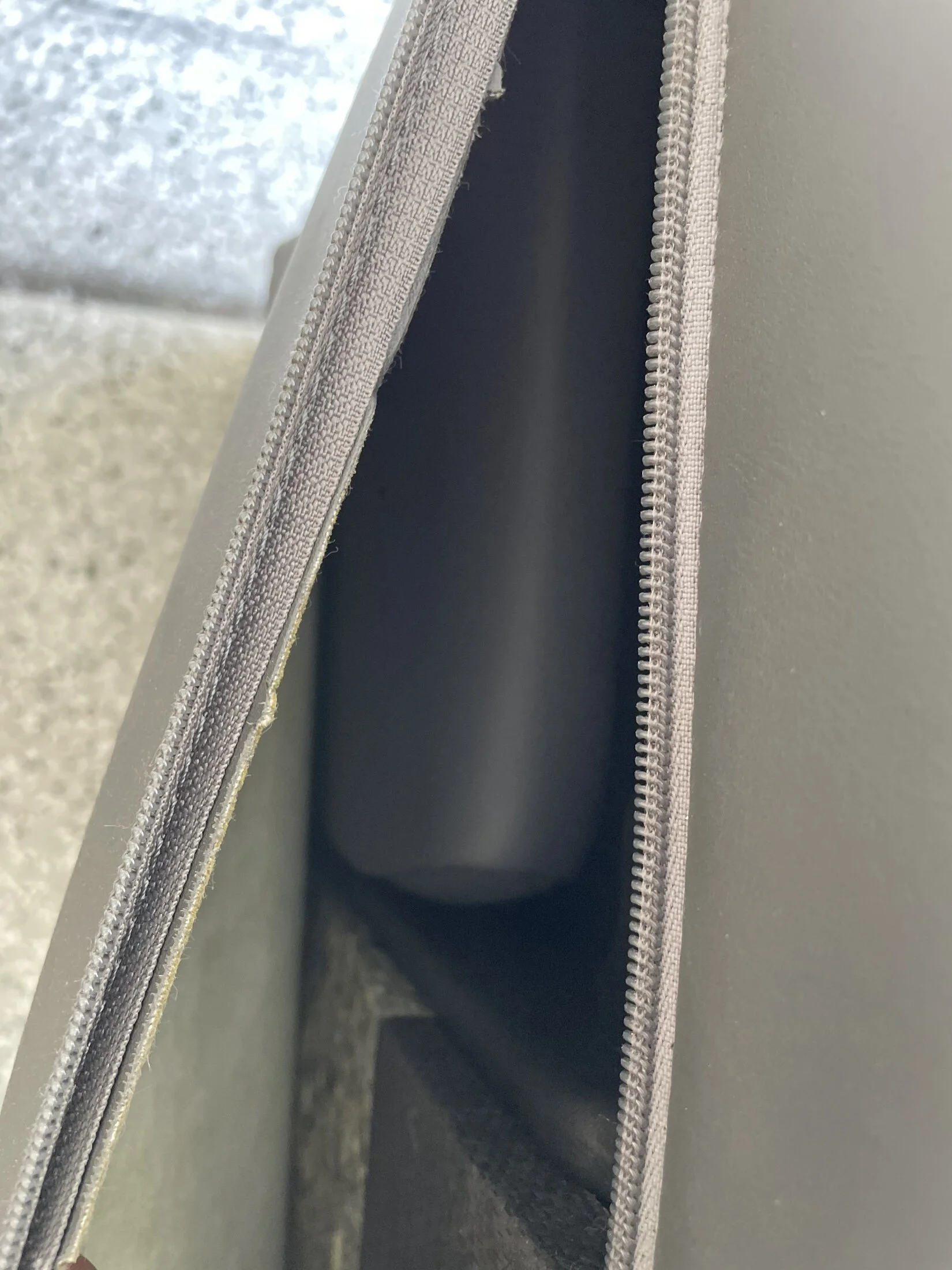

Rubber seals? were not in place. Ordered some from Lexus and they are a PITA to set. Thought they were all set and lost one somewhere so I pulled the 3 that were left.

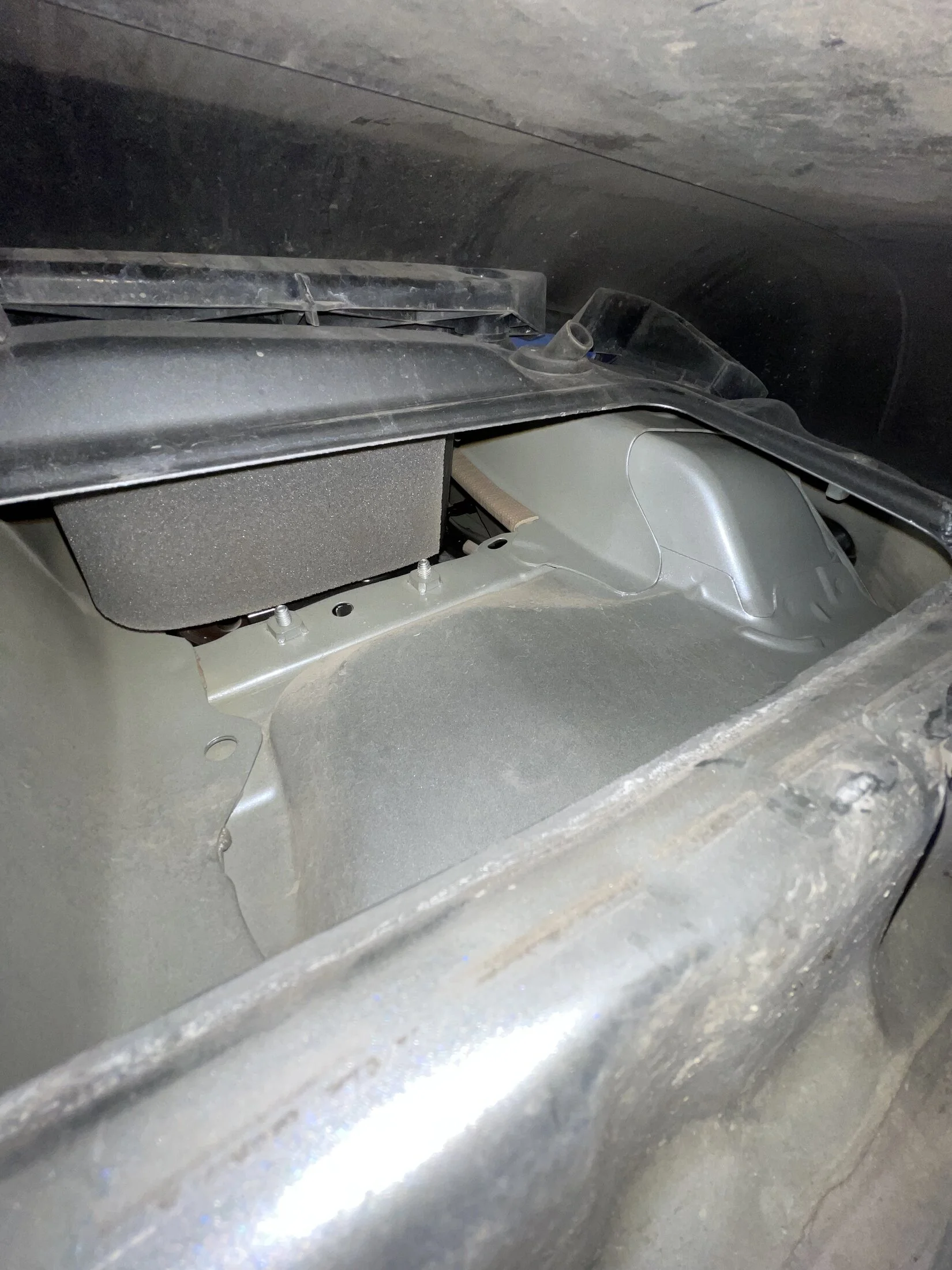

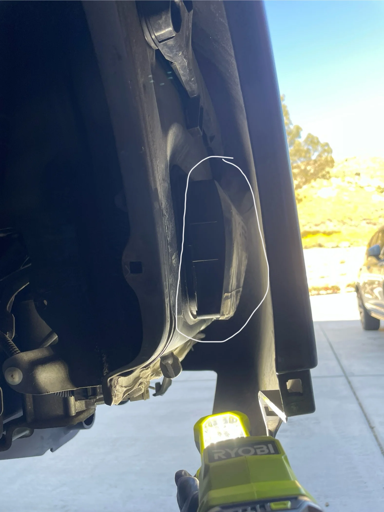

PO was hit on the left rear panel and the ventilator was dislodged. Did some “body work” to get it back in place. Found the original wheel lock on top of the fender liner.

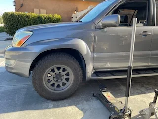

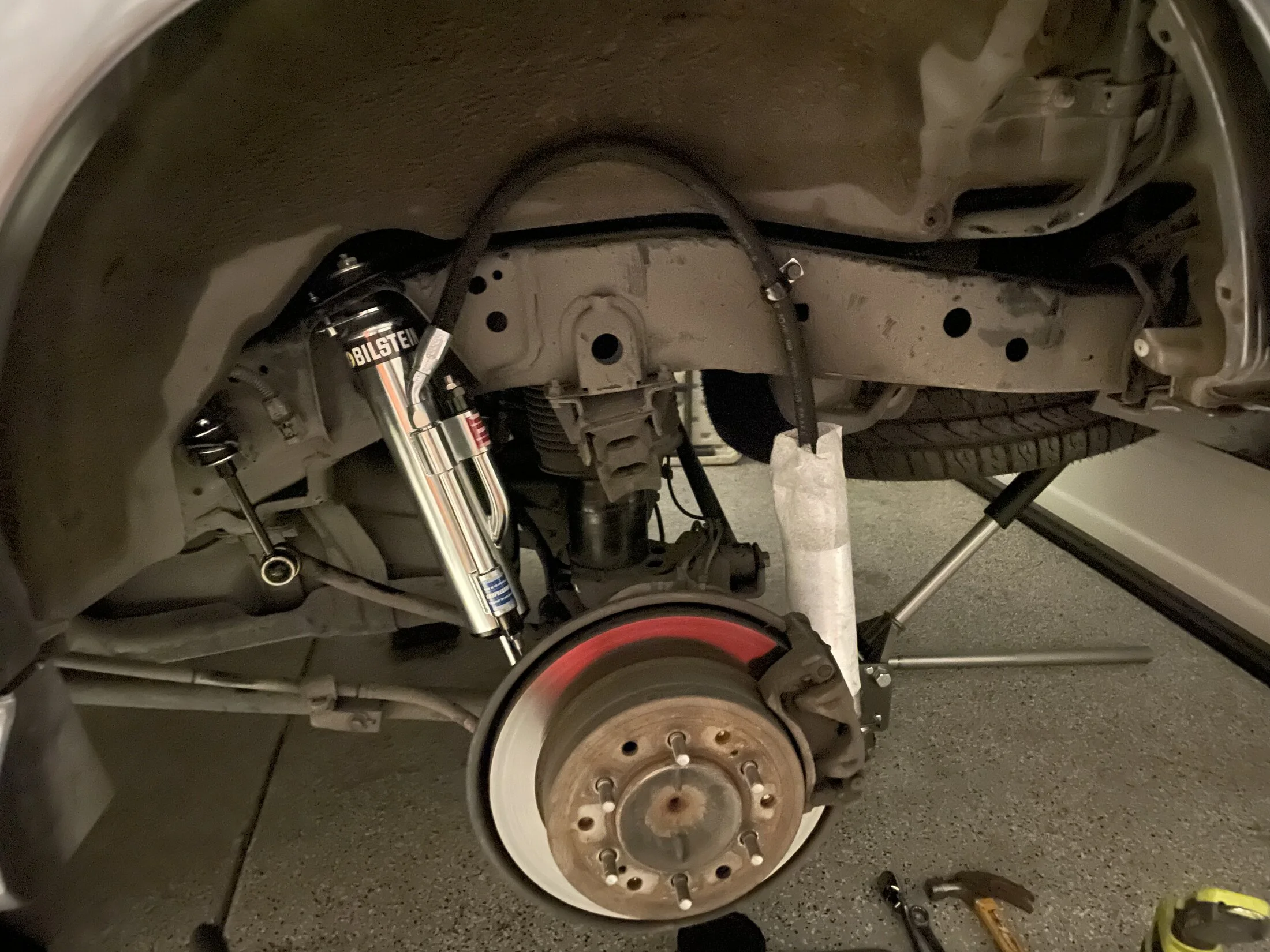

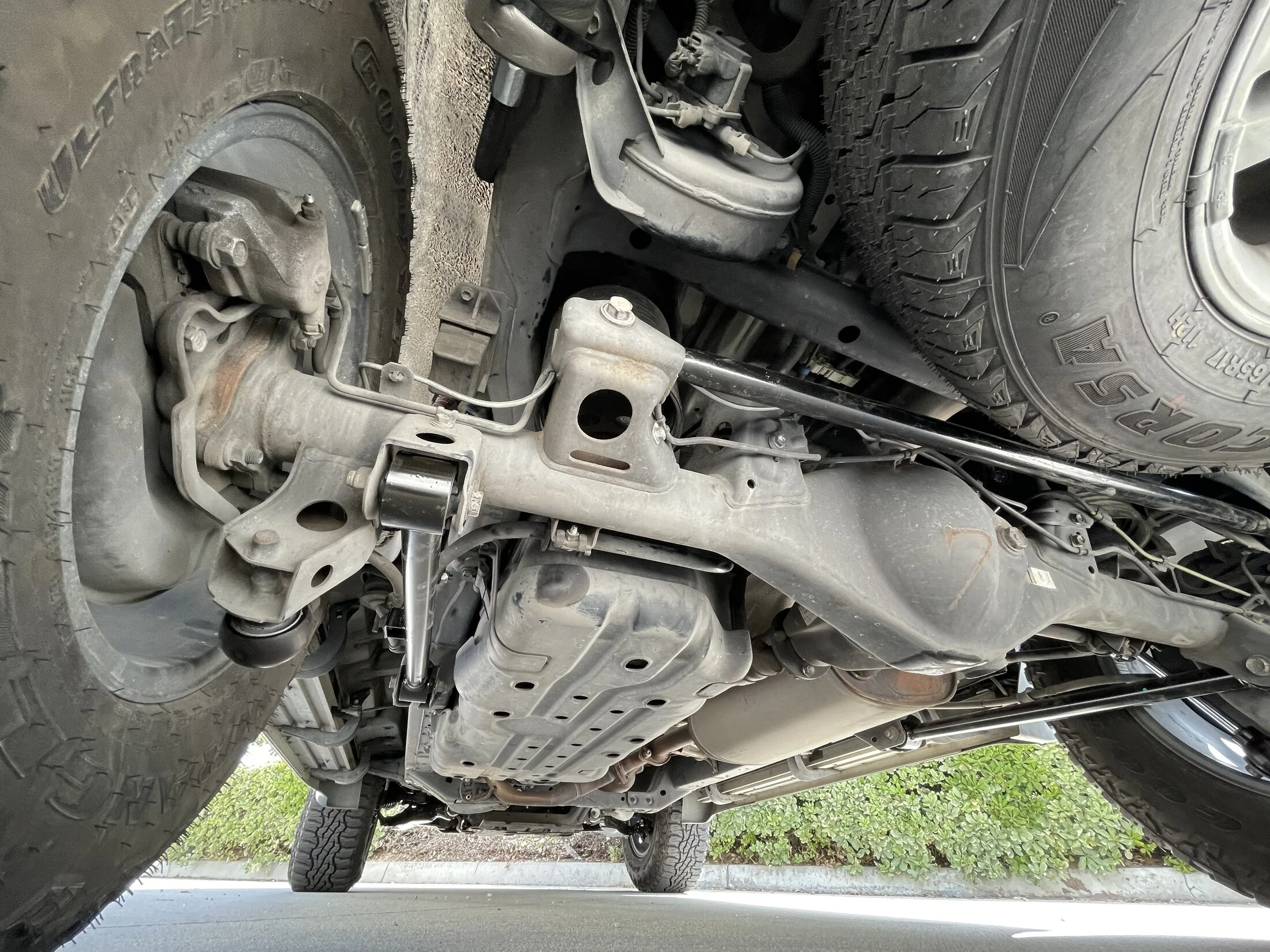

Fitted the shocks. Air springs stayed so I had to figure out a way for the rear remote reservoir hose to be secured on the drivers side. Replaced trailing arms and panrod bar.
