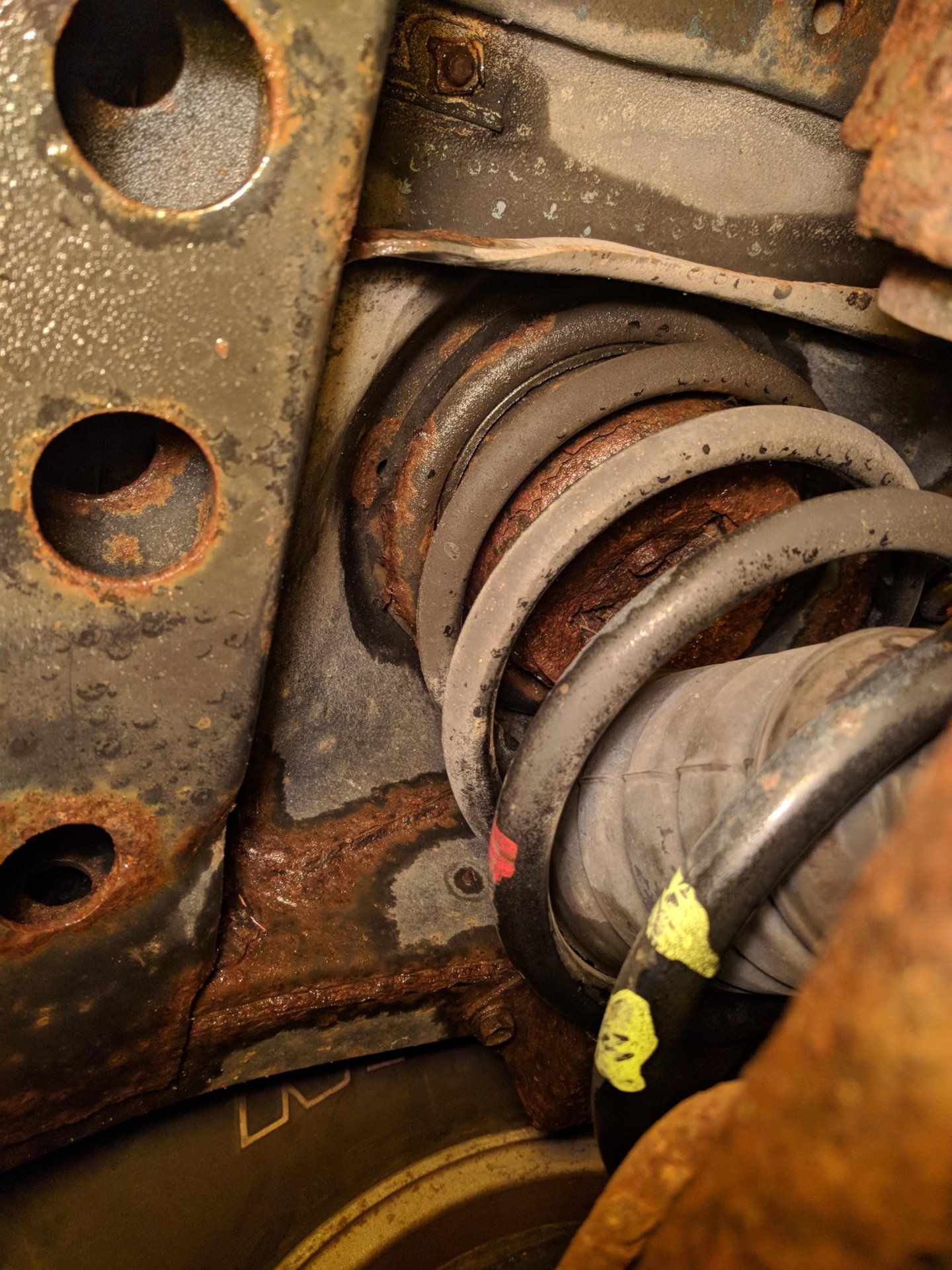

I finally got the truck up on some ramps inside my dinky garage. I'm pretty concerned about the rotted out area around the top of the spring.
this is the worst of it.
opinions? thoughts?

I'd remove that spring, clean up the top spring perch, and weld a patch (assuming the perch isn't hosed) to remount your bump stop.
The critical part of that area isn't visible in your pictures. The area where the spring makes contact with the perch (at the very top) needs to be structurally sound. The part that's rusted out is really only there to make sure the spring stays in the correct location laterally (which it's doing) and to provide a place for the bump stop to mount.
The panhard rod mount looks strong (although your swaybar bushings are shot). Your rear bumper is better than mine. Your LSPV valve is typical.
All in all, it looks like a 20+ year old truck that spent it's life in winter conditions. It's better than my truck was prior to fixing it. I'd remove loose rust, phosphoric acid, degrease, and paint.
That trailer light wiring harness is a disaster waiting to happen. The wire splices and lack of protection of the wires is going to cause electrical issues.
There seems to be a lot of fluid leakage around the LSPV. Have you sprayed the area with something? The rust is an issue for sure but I would be looking at the braking system and other safety items as my first priority.

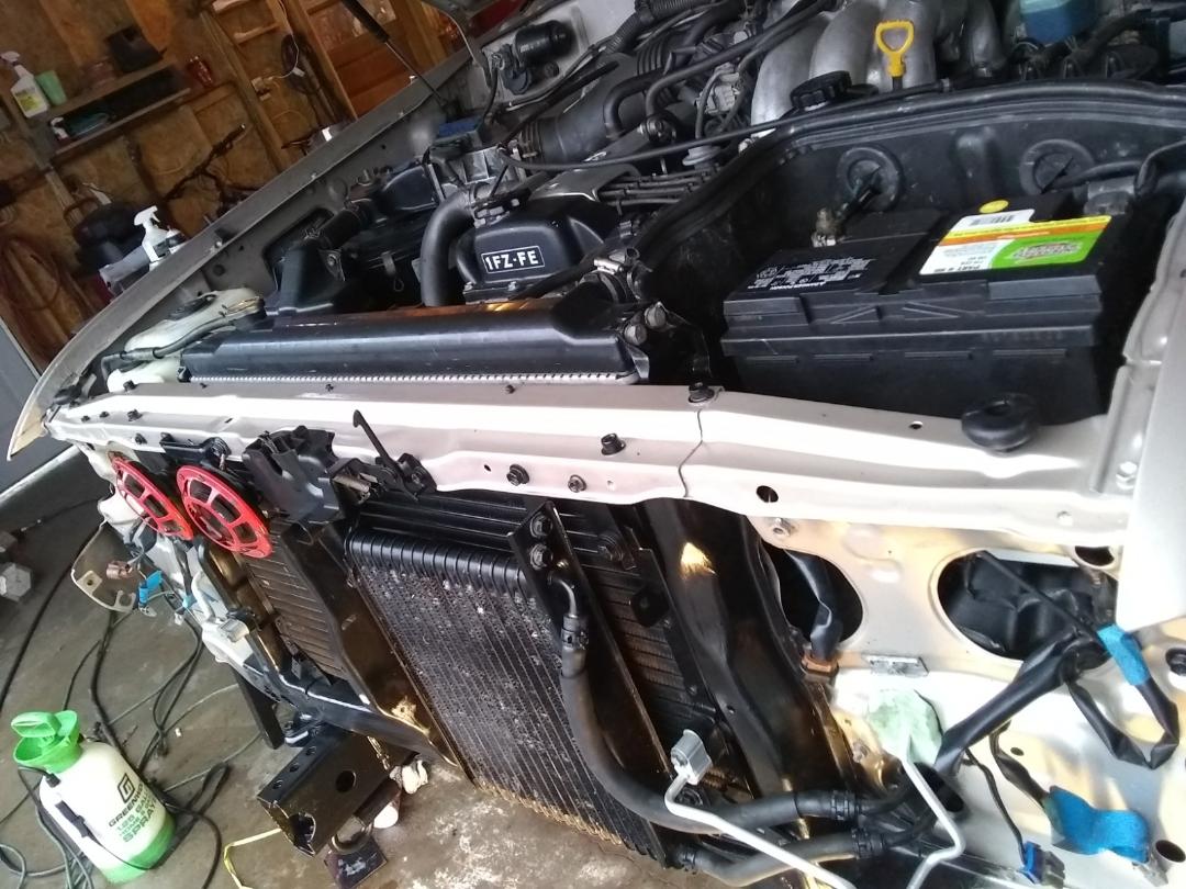

I took the whole front end apart and put on a new front driver's side fender and repainted a bunch of the front radiator support and all of the stuff that came off.

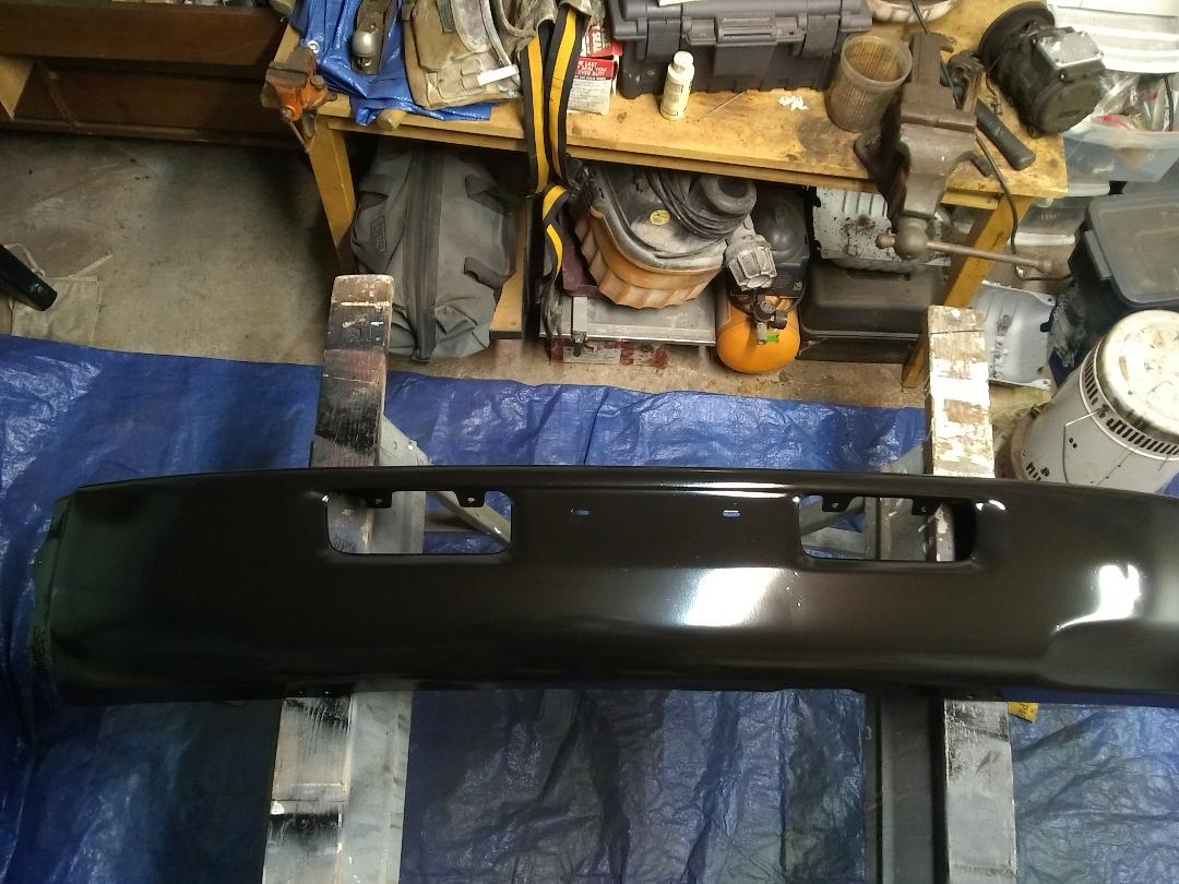

Here is the front bumper, waiting for reassembly once the paint cures. This stuff was all really rusty, especially all of the brackets and hardware. They will look really nice once it's all back together and it will last for years. POR15 on the backside of the bumper and then everything else is just acid washed down to bare and clean steel and then primed and painted with Rustoleum Professional Series in Semi-Gloss Black, which is a hard color to find. I ended up ordering a half case off Zoro.

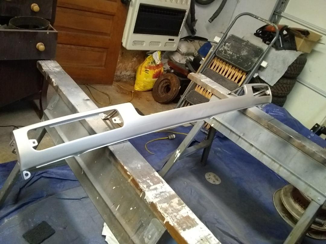

Made some more progress with my rust project. The fender matches perfectly and I added a new gasket for the flare as the old one was degraded. Also painted parts of the front radiator support, some with POR 15 and some with color match spray and clear coat. I also decided to pull the lower valance and get that painted and I tried to bang out a kink it had, but you can see the hammer marks if you look closely, but I doubt you will see it while standing. Also went ahead and POR 15'ed the frame horns as I was there and I was close to having them prepped anyway. Just did a little more wheeling and wire brushing and then cleaned with mineral spirits and slapped on a coat with a brush. It looks fine and will hold up for a while.
