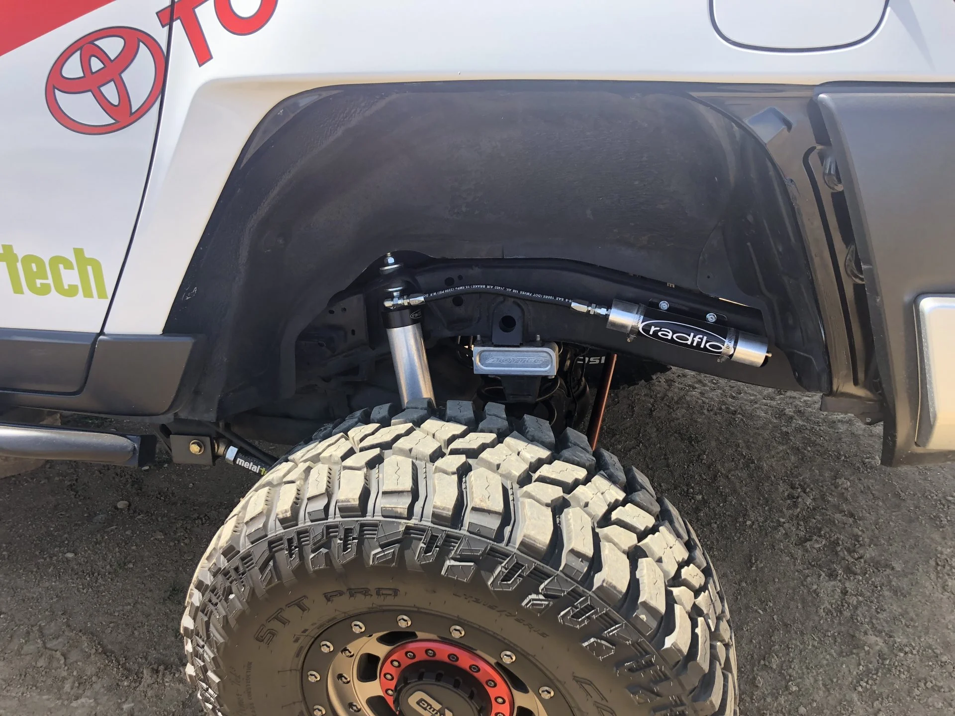

I run Resz Fab. Offset upper and lower links. I also run Radflo rear shocks. they have 14 inch shock bodies . I am swapping everything though and will run a 3 link set up , with coilovers .

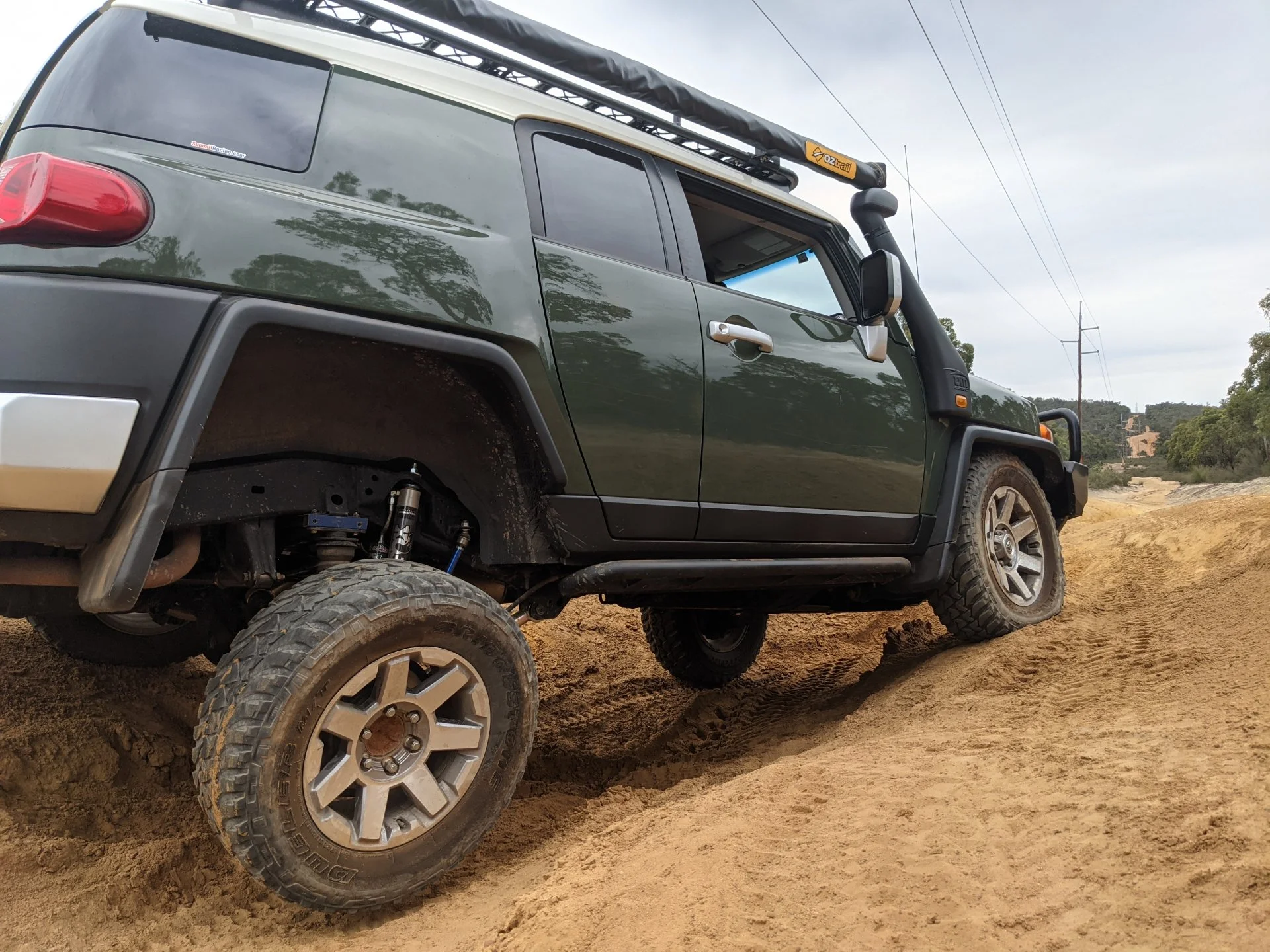

14 inch shocks, im using 11.5s, i jave offset upper arms to and with both wheels at full droop the arm and coil are close to the tank, if i extended the swaybar links the i get binding.

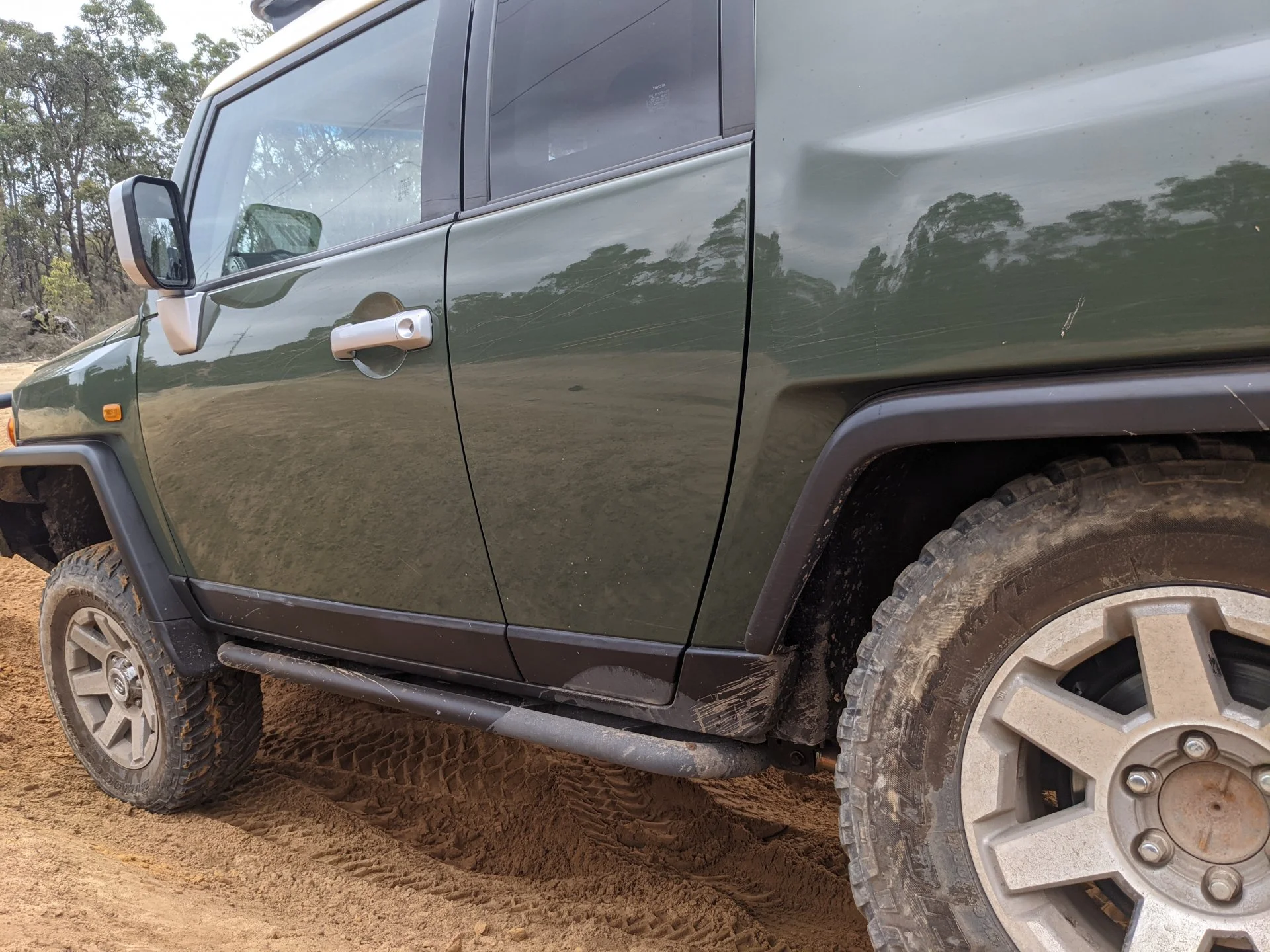

Took her out to the technical trails today. Suspension and gearbox performed flawlessly. Need the front suspension upgraded to keep up with the rear now

Looking at the resz fab, with those uppers being non adjustable they look a fair bit thinner then my adjustable ones which may be why you dont have clearance issues
They get very close
I think his wheel spacing keeps the tires off the reservoirs.
