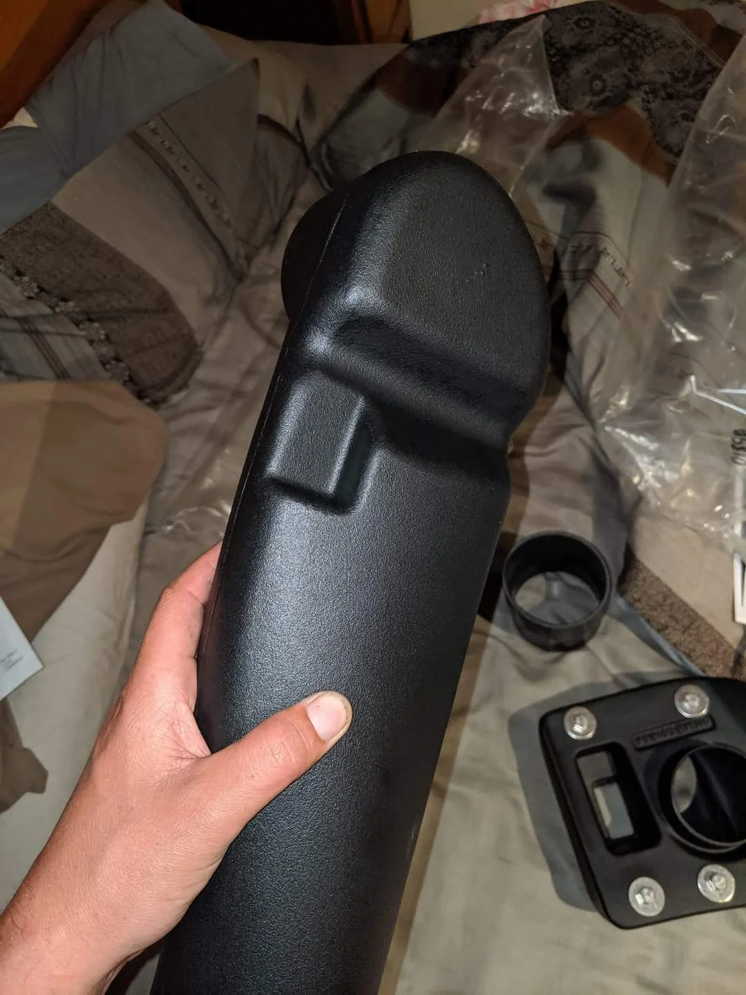

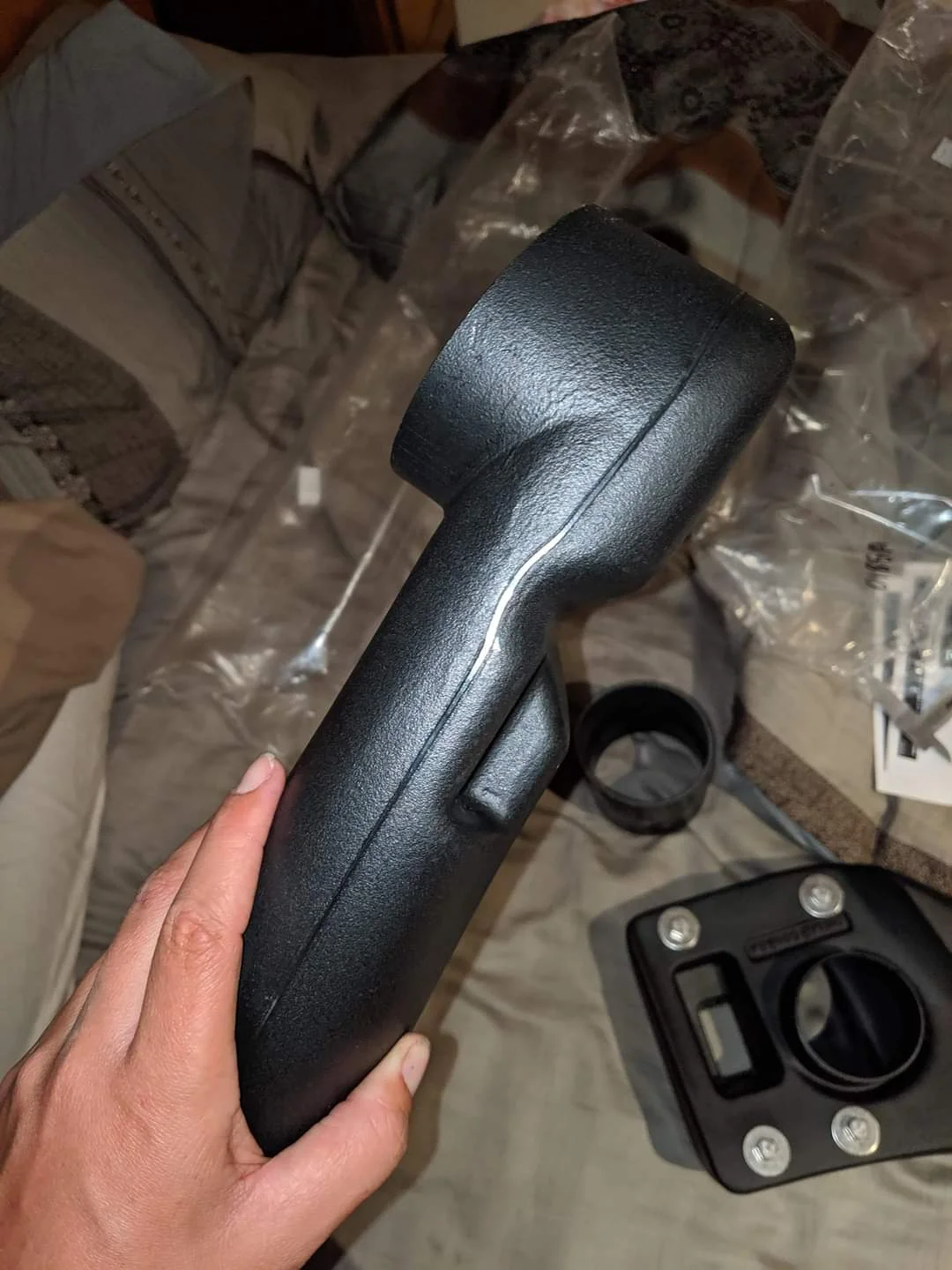

Have a look at the photo of the joiner pipe, the snorkel only really rams air over 120kph, the restriction and turbulence in that pipe is the problem.

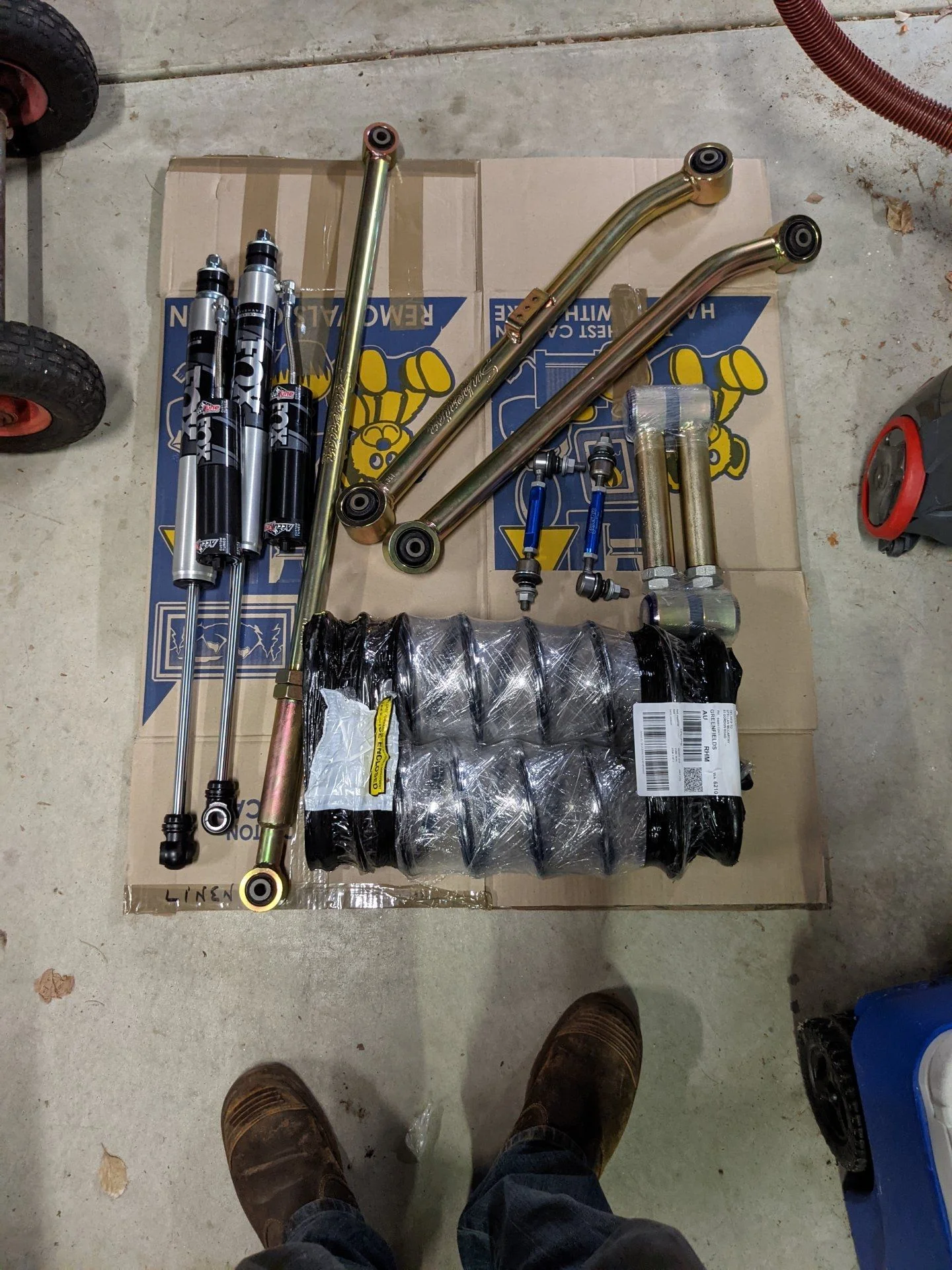

So a couple of updates, fj is booked in for torque converter override kit and heavy duty valve body upgrade in 3 weeks and am just about ready to install all this.
Superior lower rear arms
Superior upper rear arms
Superior panhard
Superpro adjustable links
Psr 3" long travel coils
Fox 2.0 11.5 inch travel remote res shocks custom tuned and built by accutune offroad ( recomend these guys to anyone looking at fox shocks).

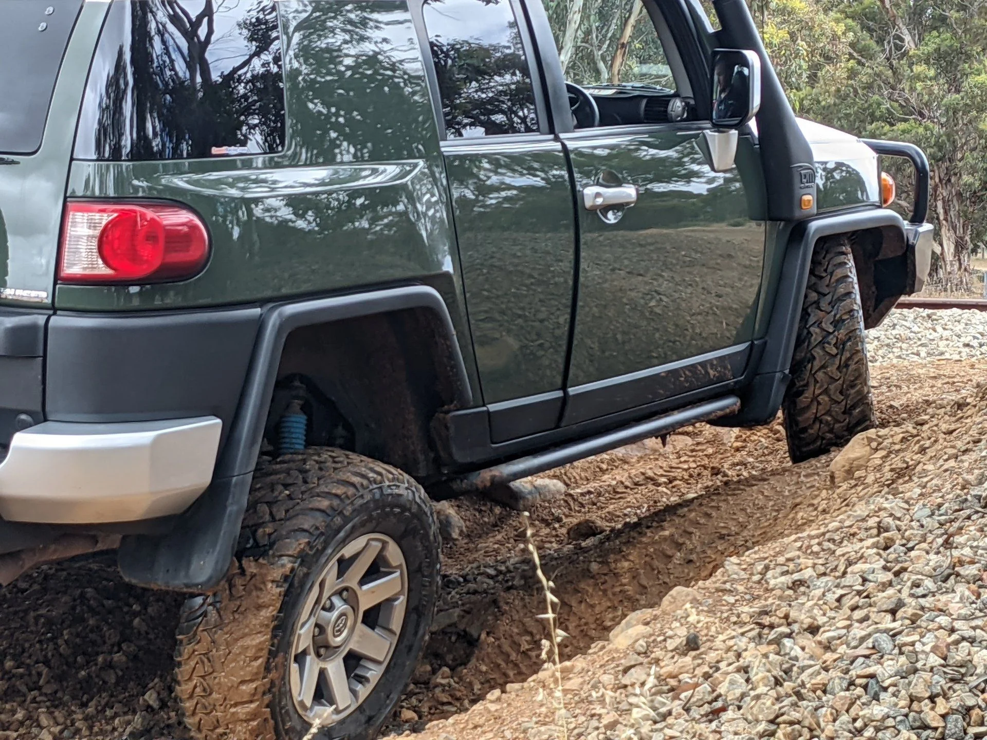

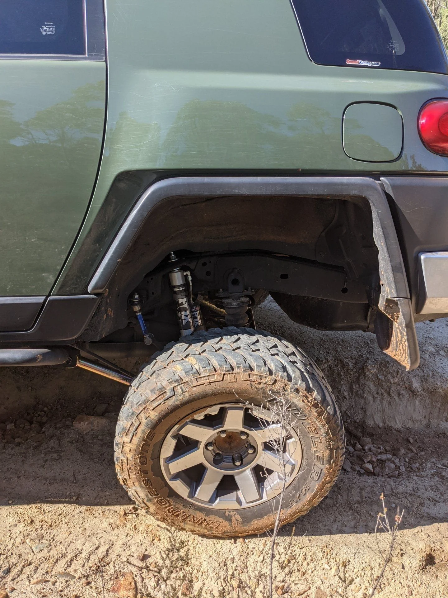

In the day light. Notable things. There is only about 10mm of compression left when the axle hots the timbren stops, plus the external bump stop on the shaft so i will be spacing the timbrens down 20mm to be safe.
I will likely find a shock shop over hear to put longer hoses on the reservoirs so i can mount them on the cross member behind the coils as there isnt alot of room between the axle housing and resovoir at full compression and i can see those billet clamps moving over rough trails.

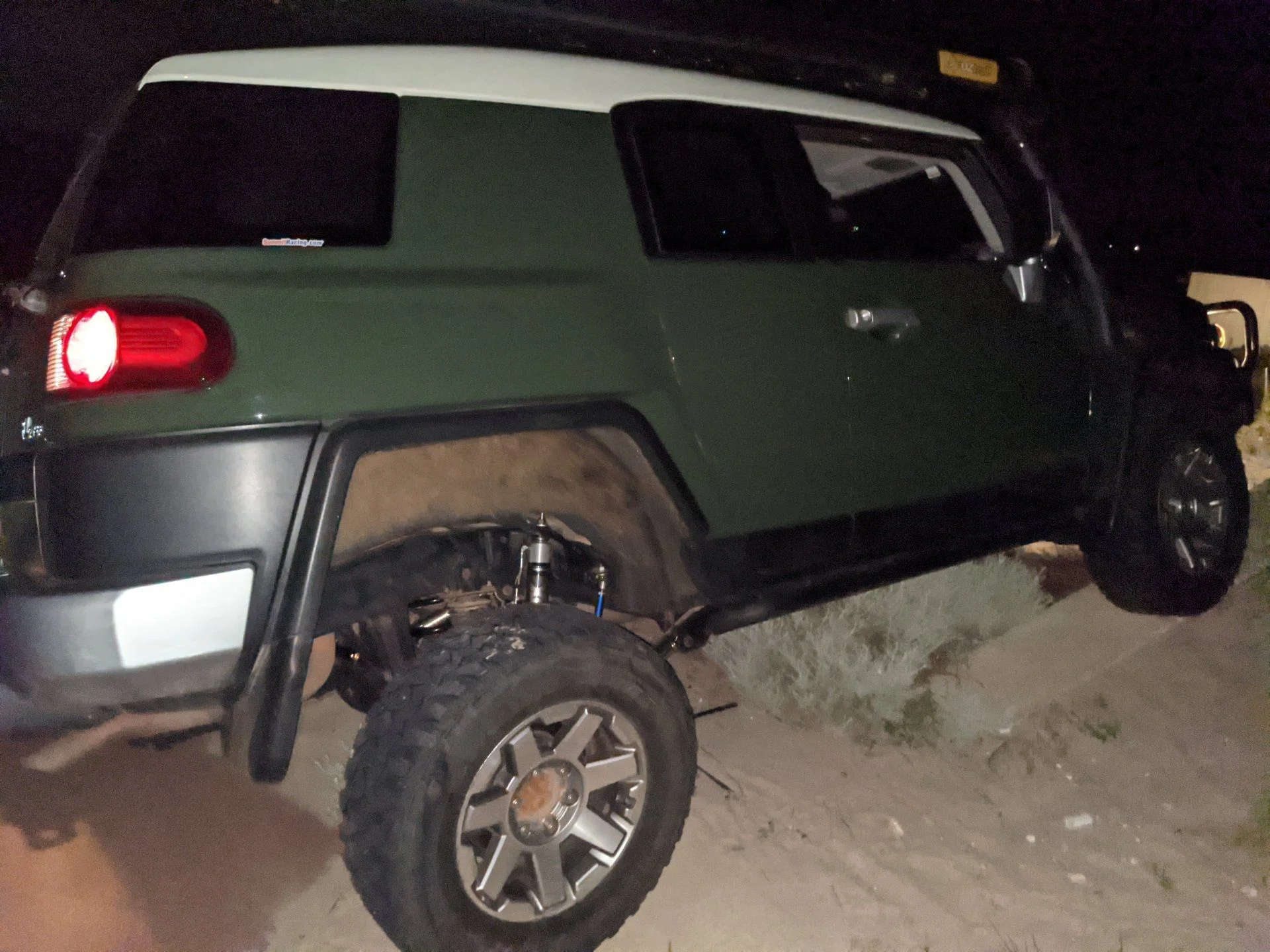

With the car on jack stands and the axle at full droop the left spring and upper arm were hitting the tank (wound the swaybar links up to limit droop for now) while i couldnt immirate the scenario in the picture taken it may not have been at full droop so will be emailing the vendors that made the arms and coils tonight for advice.
Currently at ride hieght i have 5.5 inches of compression left on the shaft, the timbren does compress quite a bit but not sure how much. The shock has 6 inches of droop at ride hieght.
Bottom of rim to edge of guard is 860mm right side and 870mm left side. I dont have a jack high enough to measure wheel travel atm so couldnt tell you all that but i estimate droop to be about 5 inches at the shockwith the swaybar links wound up.
