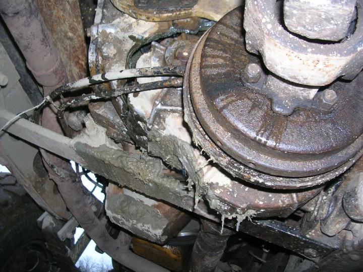

I've gone thru a couple cruiser cases....
dead F and an sm420
what year case the old three speed case is not as strong as the four so i am told, do not get me wrong thow thier is always somebody out there who can brake everything,:skull: wheel hop is the devil. some people just do not know when to pick a new line.:hillbilly: :hillbilly:
Both 3speed and 4speed cases with a t-case saver. I dont' get wheel hop. I have never broke any rear end parts.
