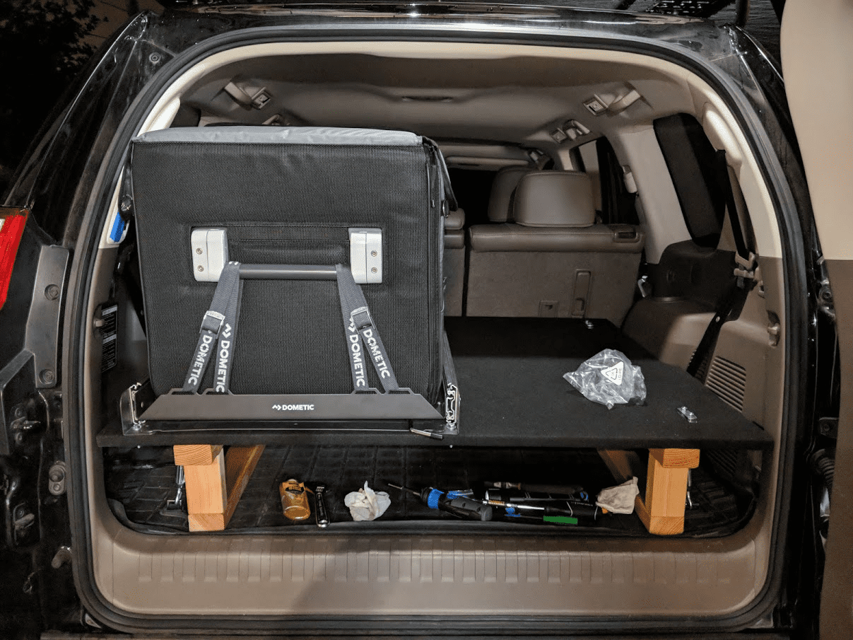

not a dropslide but you get the idea
I really like this idea. I have a 2020 also and I sometimes use the 3rd row so deleting it is not an option. I might have to build this but slightly modified. Thanks!
Oh, what model Dometic fridge do you have?
75qt
CFX 75 DZ? I didn't know it can fit length wise. I have the 75 & the 28. I also thought my 75 had to sit horizontal across the trunk as opposed to length wise. This opens up to have some ice cream while car camping! Thanks.
Edit: What's the height clearance of that storage below the platform?
About 7 in. The 2nd row seat is 1 click from all the way back. The top outside corner of the fridge cover just barely rubs on the rear glass.

My question, is to Gx460sd or any others, is how did you attach your wooden base to the vehicle? Since the 'floor' is in essence the back of the 3rd row seats, there is no bolts, threaded holes, etc to capture the base, to then attach your fridge slide to. In the photo Gx460sd attached, I would imagine the second you slide the fridge out, that badboy is going to tip! Any ideas how to safely attach the fridge slide without removing the 3rd row anyone?
You attach to the tie down points on the floor of the third row. You can actually unscrew them and bolt in different anchors if you like.
Bringing an old thread back from the dead-
Looks like they used turnbuckles to tie the platform down to the 3rd row D-rings.
Why not just pull the 3rd row out and use a plywood deck? Makes things that much easier and if GX460sd had done that, his fridge cover wouldn't be hitting the glass. Besides, it's not that easy to put all that stuff in and out of the rig if you really intend to use the 3rd row seats. I have an 80qt Setpower fridge on generic Amazon slide and it fits without having to move the 2nd row seats up at all. The slide barely fits because it's huge but the fridge fits without issue. And because it sits 3" lower due to removing the 3rd row, I don't need a tilt slide. ;) And there's still room for my Plano boxes, aux battery and Renogy solar controller next to the fridge.
