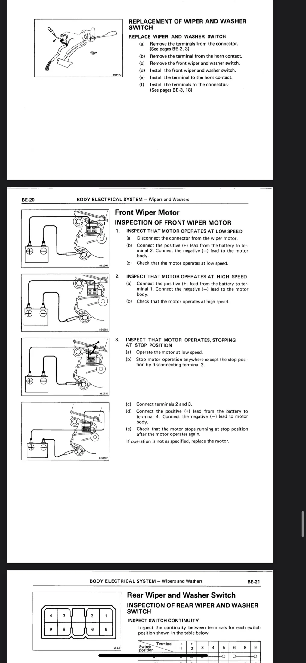

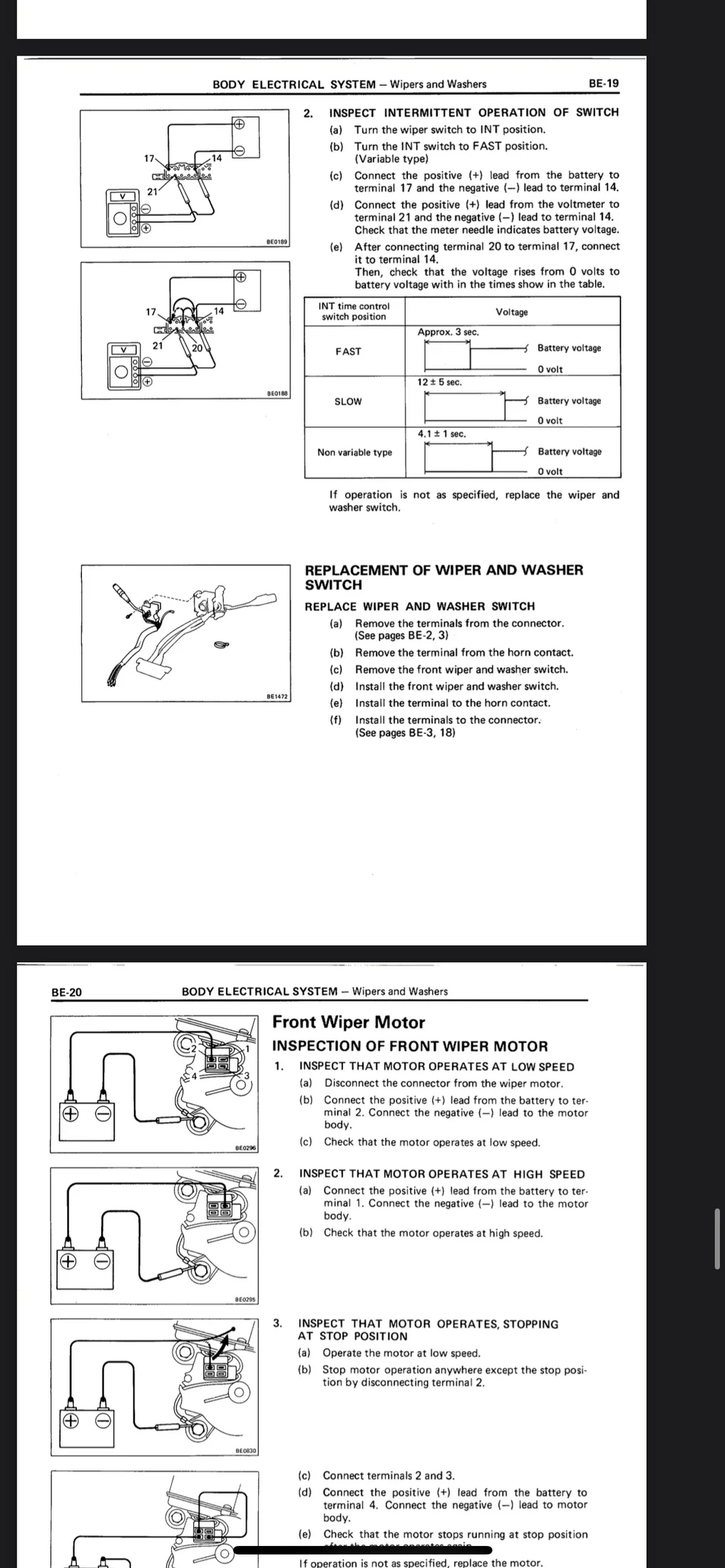

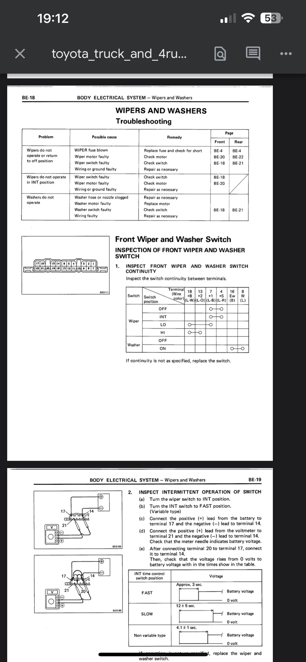

@gnob, here’s the wiring diagram for an 88 4Runner from the FSM.
Testing of the wiper motor, not sure if this is helpful.
