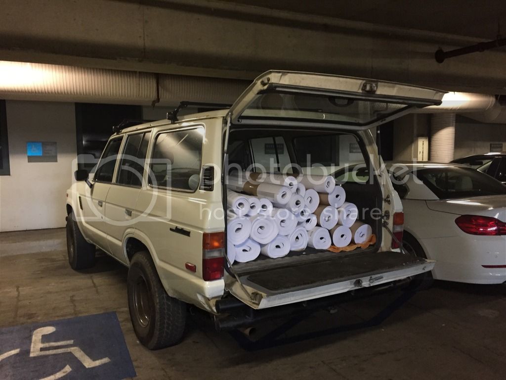

Got a set of good condition used 62 springs over the weekend. Disassembled them and added a few leaves from each into my packs, along with the AAL. Just in time too...drawings need to go into the city for our first plan review tomorrow.
