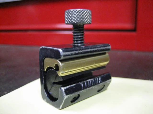

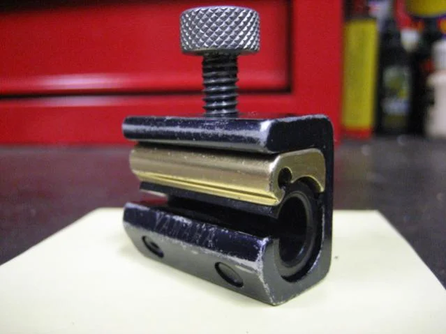

Several ways to lube a throttle cable. If the outer sheath is rotted away, it would be easy to simply spray a lube which would soak thru the metal wrapping sheath. I use a "cable luber" from my motorcycle days...made by Yamaha. Other cable lubers may be available. Remove the end of the cable from the throttle body, clamp on the "cable luber", insert the tube from an aerosol can of "Tri-flow" (teflon bearing cable and chain lube) available at your local bicycle shop, and force lube into the sheath under pressure along it's length.
Careful not to use too much as the excess will drip out the other end onto your skinny pedal.

I used the motorcycle cable luber on ours and it worked great!
Great little tool to keep any cable lubed, mowers, crusiers, etc...
That is only a band-aide fix though if it gets worse a new cable will be in order.
