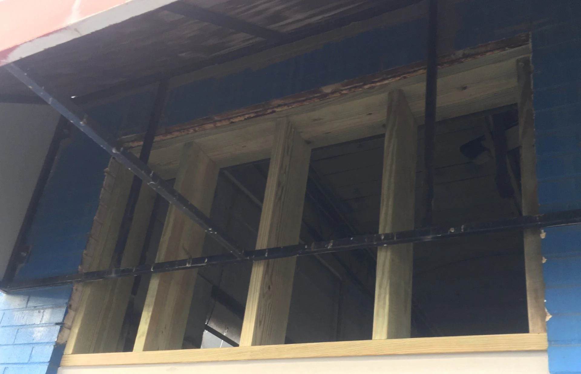

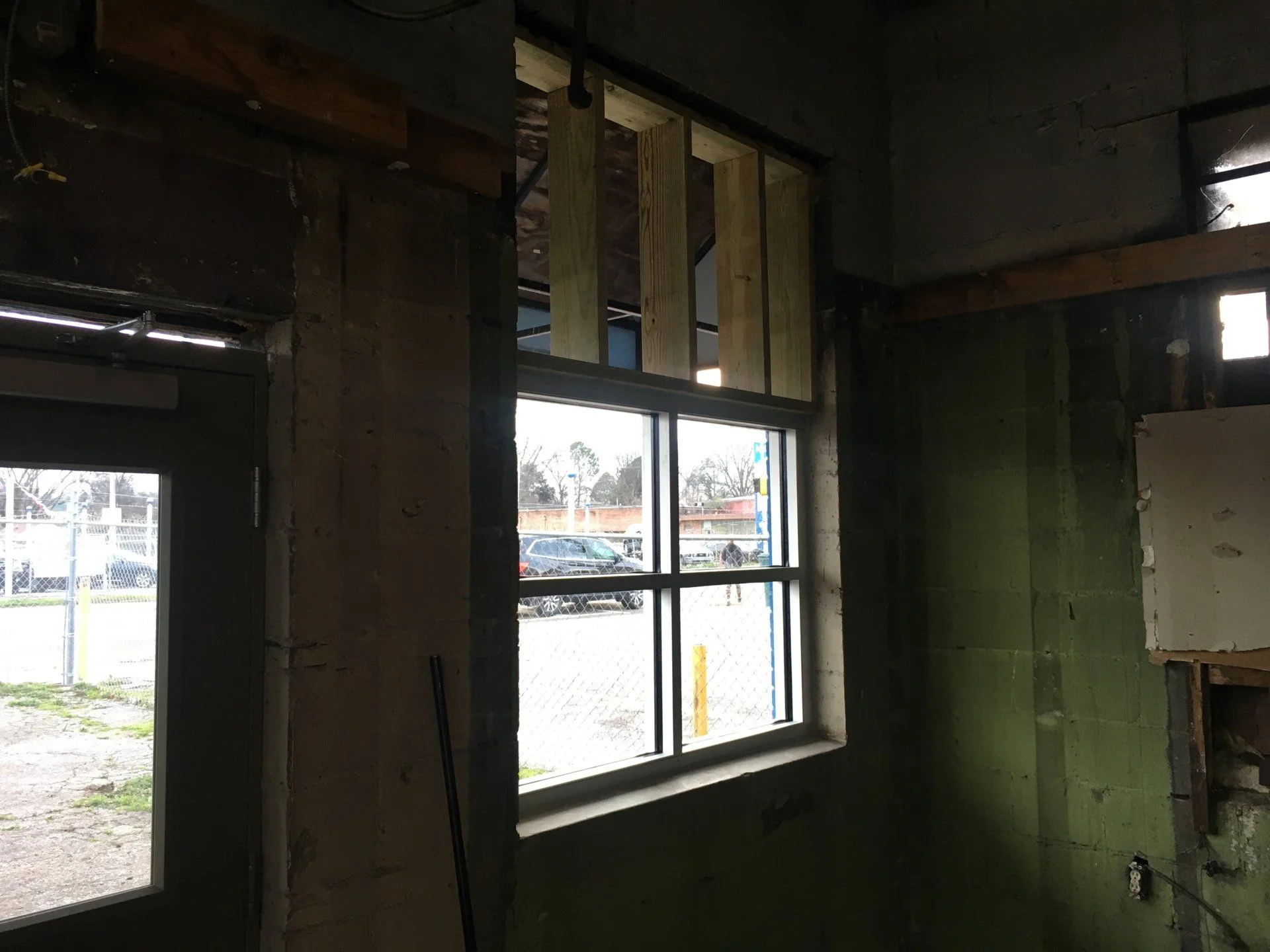

More stuff crossed off the list. Yesterday evening I demo’d the window in the front that’s getting replaced.
This morning, @dogfishlake was in town on a walkabout and helped me frame up the opening above.
We’re going back with a smaller window to better work with the awning outside and a storage loft inside. Plus it’s cheaper up front and cheaper to replace broken glass down the road if needed.
The window dudes finished this afternoon, so I swung by to put a piece of plywood in the hole above and take pics.

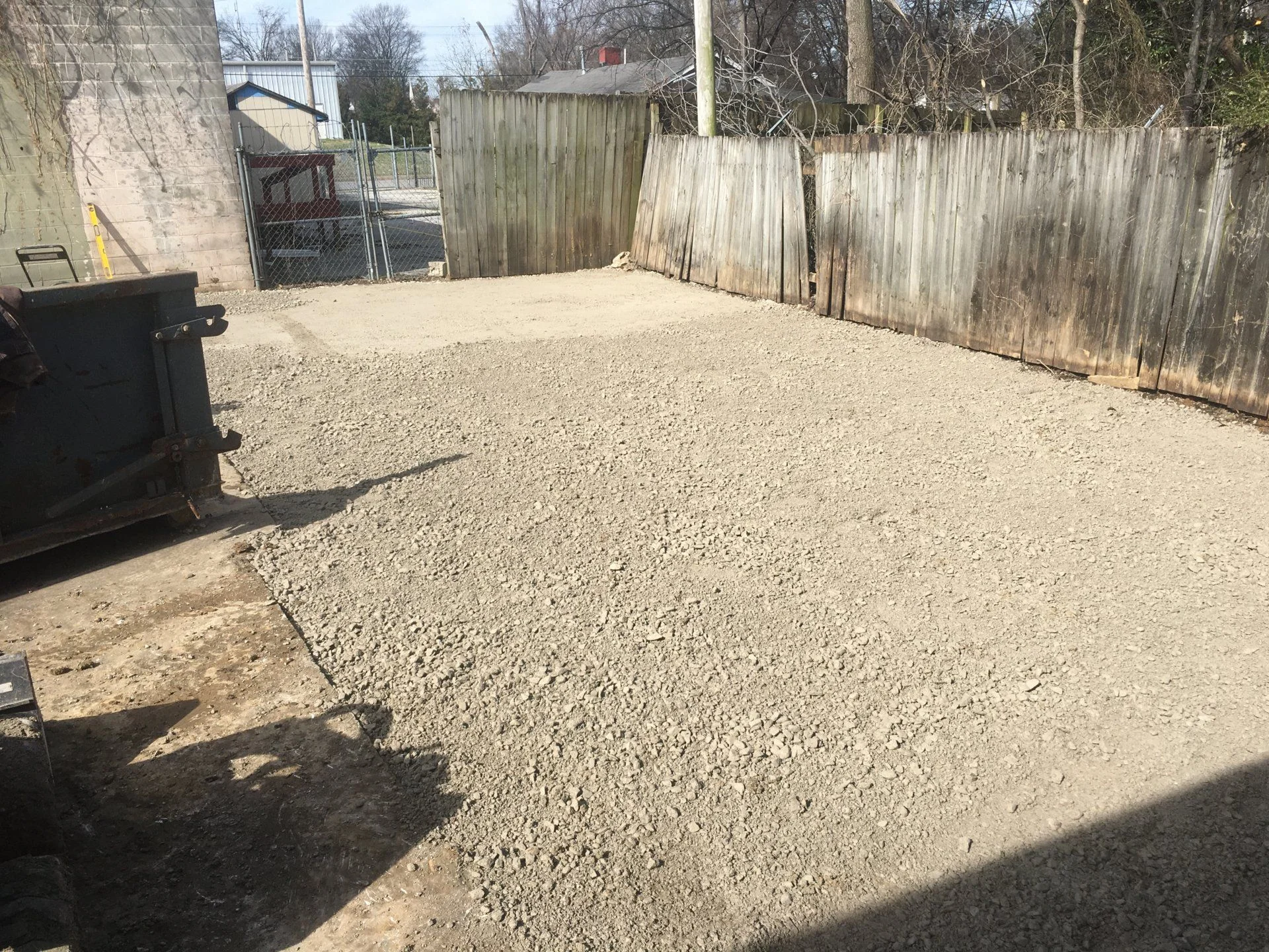

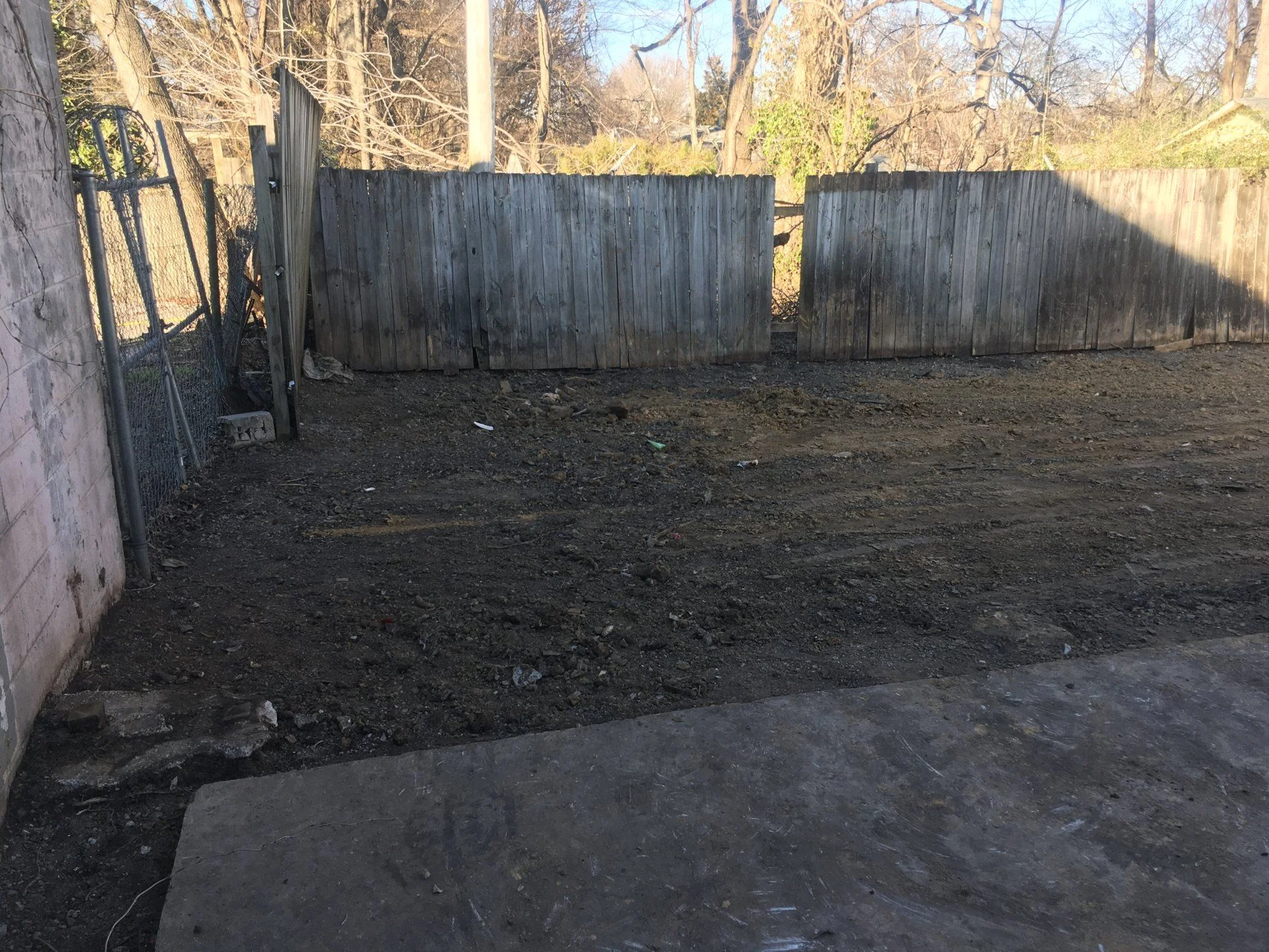

Landcaper dudes are rocking and rolling pulling out seemingly infinite soil, trash, and trees.

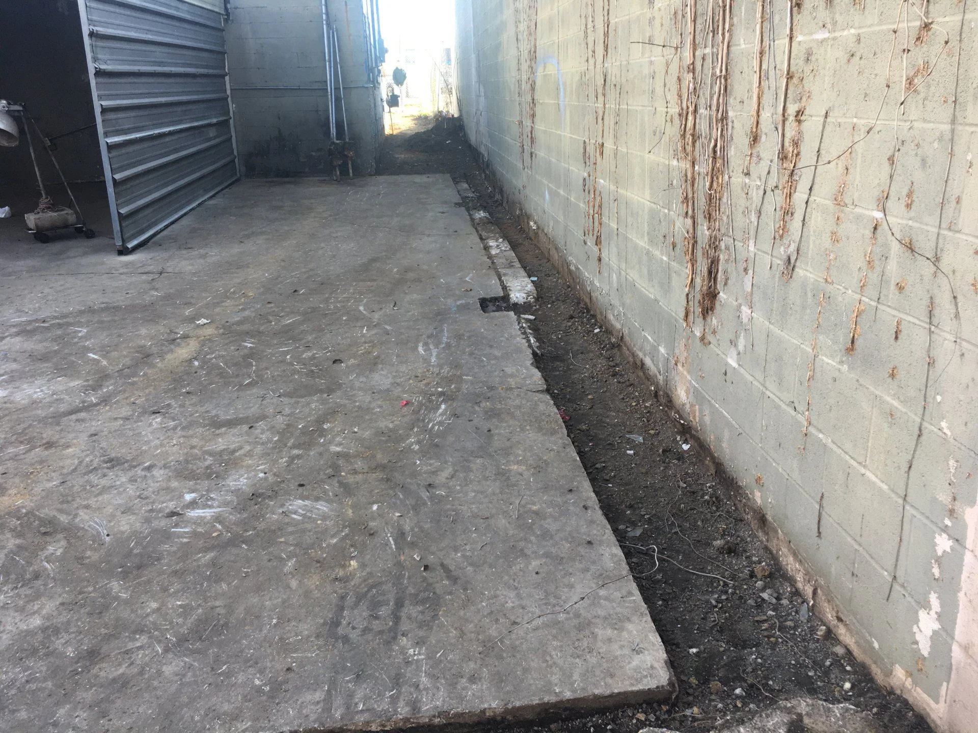

I’m going to put in a tall fence between these two buildings to keep foot traffic out (haven’t seen any yet, but that spot was a possible opening), so they pulled back the chain link and started in with the Dingo. Should actually drain through there now too. It’s going to be super clean when they’re done.
I would think an area as established and beat down as the one Cam is working will support the material with little loss.
I agree to use it on new grade if possible but in his case it’s not going anywhere

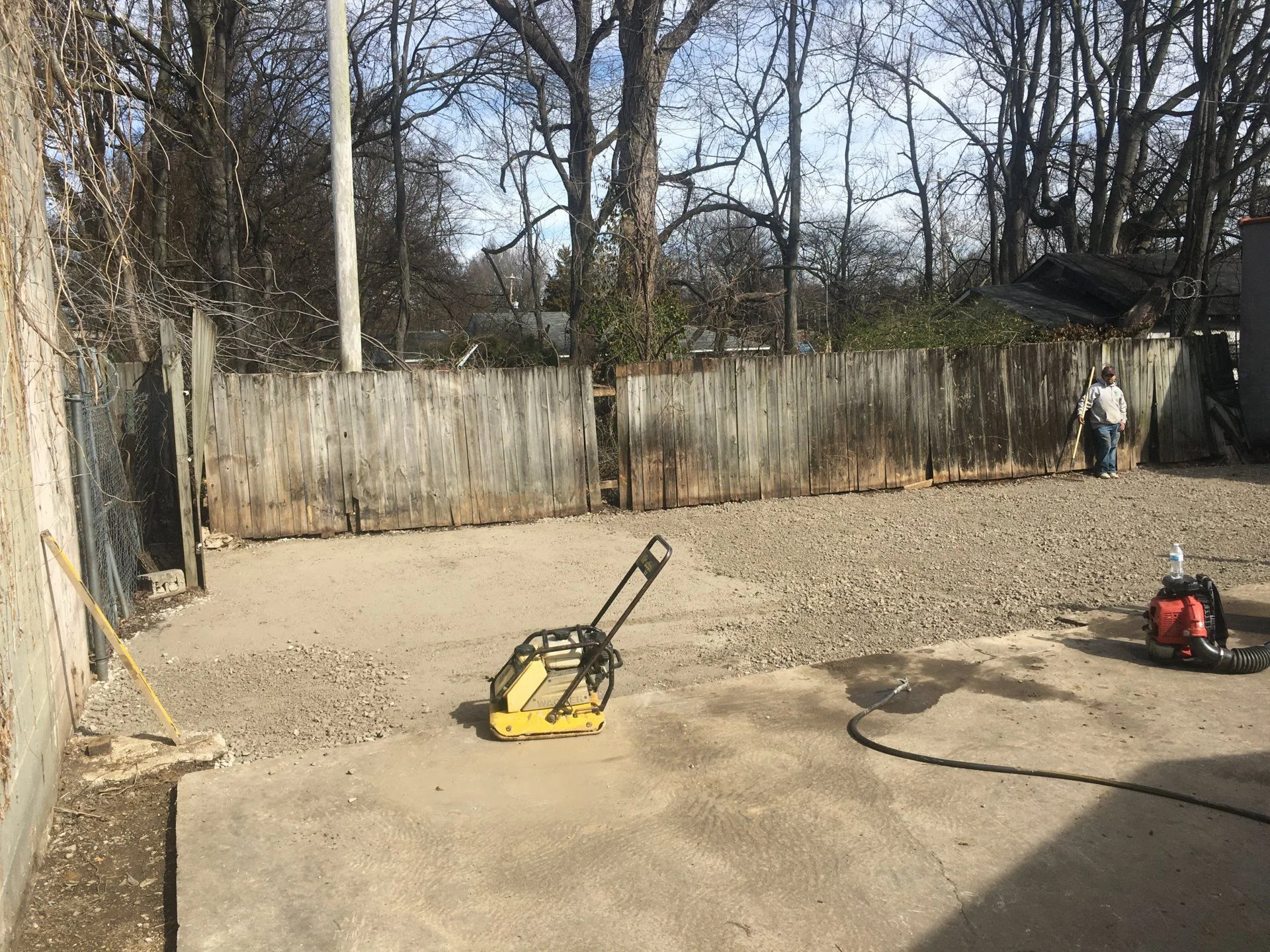

We’re going in with a 4” base of CR-610 (small limestone/stone dust mix, topped with limestone. Should set up nicely.
Between the buildings, we’re doing fabric topped with limestone.

Landscape dudes got the last of the crap out today. This looks so much better.

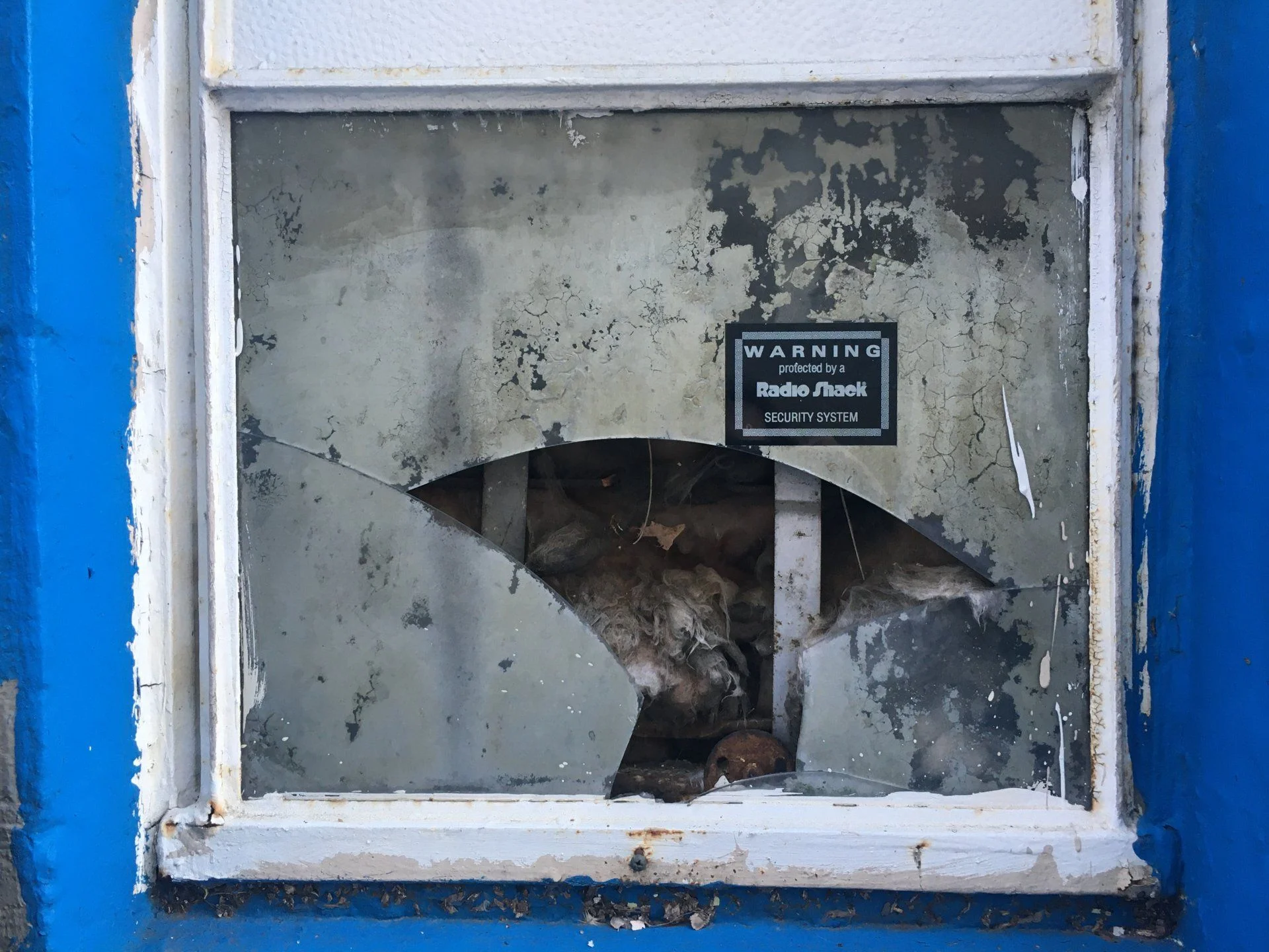

The extraterrestrial mind reader has been keeping an eye on things for me...
... with an assist from Radio Shack:

They’re out today putting in the base:
Looking at the bottom of the fence, you can see how much old muck they dug out. I shouldn’t have any drainage issues, it drops off right behind the fence.

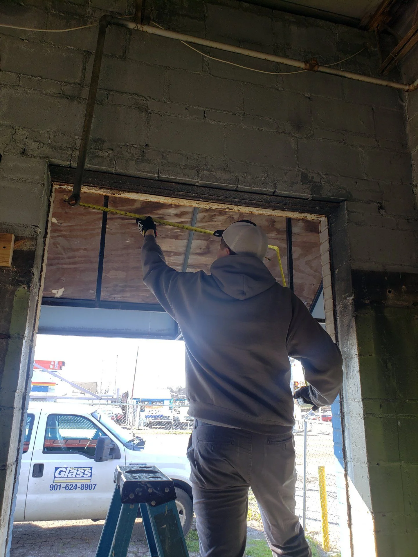

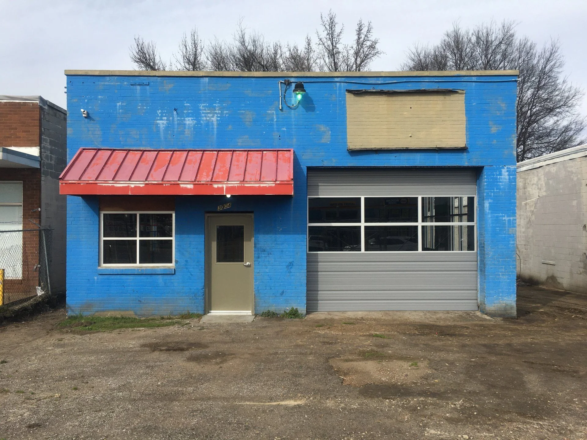

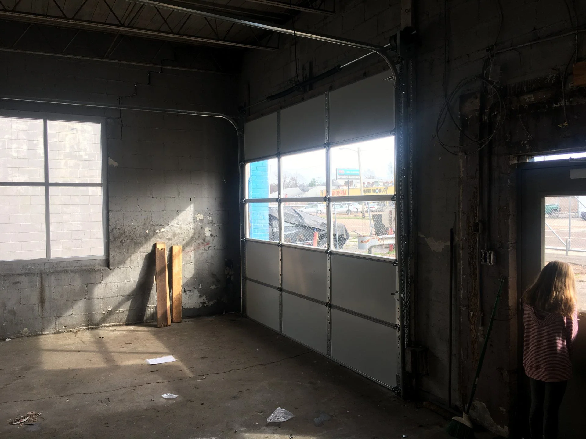

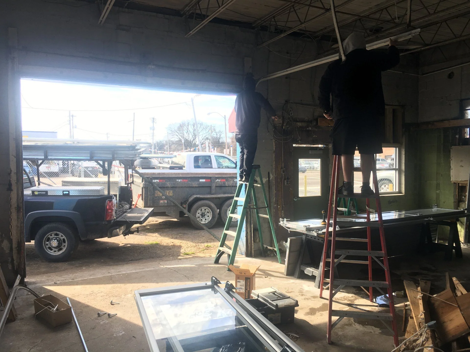

Garage door guys are also on site. They should have the new door in today. Going to be clean with lots of light.
Installed pics to follow.
